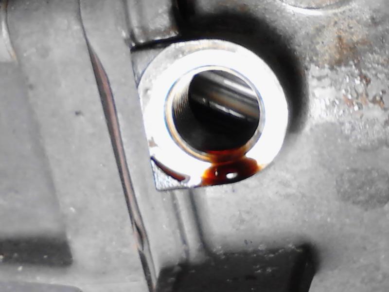

Removed the allen key drain plug on my transmission, but don't see any stand pipe as indicated by the instructions. Please look and tell me what you think. It's an 05 cooper s, 6-speed automatic. I provided someone here with the vin and they insured me it isn't a CVT. Where is that stand pipe! Unless this isn't the tranny fluid. But I am 100% it is the drain.

Item 7 in the illustration below is the overflow tube you're referring to. It's removed when the fluid is drained from the transmission. To check fluid level just the plug, Item 5 in the illustration, is removed and, with the engine running, fluid is added until it overflows. Also, the drain plug is a Torx 55 screw. You seem to have the engine oil drain plug pictured.
Thanks for your reply. I understand that, but the way mine looks doesn't make sense. First, after the fluid drained, i looked inside as you see in the picture and there is no stand pipe, there is actually some metal looking rounded parts. So, not sure where am wrong or right. Also, my drain plug is not bolted to a transmission pan, it's in the transmission block.

You mentioned that It might be the engine oil plug am showing. Well, ths plug is located on the driver side, and it's on the bottom of the fill in lug side, so am sure it is a transmission plug. but for some reason it doesn't look anything like any of the instructions I read, which state that there should be a stand pipe after removing the plug. Also, it isn't part of any transmission pan. That is weird. Unless there are two different drain plugs for the tranny.

Should you be trying to do this work if you don't know which is the right plug to remove?
I think you took out the final drive oil plug......

What I was suggesting is that if you do things wrong it can get very expensive. Your picture is not conclusive, and you clearly do not know the difference between automatic transmission oil, gear oil and engine oil. confusing those can cause really expensive problems.
Since you don't know this, maybe you can get a friend who's more knowledgeable and experienced to take a look at what you're doing and help you?
Like I wrote before, it looks like you took out the final drive gear oil plug, not the ATF plug.

You don't say what oil you're trying to change, the final drive lube or the ATF (automatic transmission fluid)
If the latter, here is a pic showing AN auto transmission pan (not a MINI tho) and you can see the plug in the bottom of the pan. You'll also need to locate the fill plug on top the trans to refill, you also need to know how much you drain out so you can put approximately that much back in again - you don't want to overfill it. Be aware that most of the ATF is in the torque converter, you're only changing a portion of the fluid - that in the pan. Most of the time when you change the fluid you should also pull the pan and clean the screen and change the filter (if it has one - most do). I do not recommend your doing this based on what I've learned of your skills and experience so far.
Like I said, your pic is inconclusive and you haven't posted another, better one to help us know what you actually did - but if you took out the final drive plug you need to put the right fluid back in - check your owner's manual for the recommended fluid - and you need to find the other (upper) plug to refill it.
ATF (unless badly burned) is a nice pinkish red, lightweight oil, very slippery.
Hypoid Gear oil has a very distinct smell to it, will be gold to dark brown in color and much thicker.
Engine oil will be lighter than gear oil, and will not have the hypoid smell. Depending on when it was last changed it could be anywhere from light golden brown to black in color.

Thanks. i located the ATF drain plug. Removed it , drained, and removed the stand pipe. Also located the fill in plug and removed it. I will look into the manual and see what fluid is recommended for the FD. Thanks for all the info. Will fill in ATF, drive for some miles, and flush it twice more. Hopefully I will be able to get out 50% at least.
I asked a question on one of these websites that you pay for, supposedly answers from experts. This guy tells me that the final drive fluid I drained I guess, or the plug I removed is actually filled with ATF, same as the ATF I will be using for the tranny. He said he couldn't find any pictures or more info on it. Am like if you guys don't know what it is exactly then you just want me to guess what fluid to use? The manual I looked at and it doesn't say a thing. Don't know who to believe any more. There is NO information online on the FD fluid, location, how to fill, and what fluid to use. The expert couldn't even tell me what the FD is, what it is used for, or anything.
