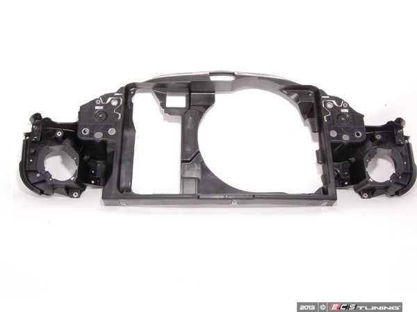

I have a 2005 Mini Cooper Conv.
My radiator support cracked in a little fender bender and I need to replace. I found some local junkyards that have the same part but to 2002 and 2003 models.
Will those fit a 2005 Cabrio?

The base radiator mount or core support set in the front and your radiator mounts to it with hardware.
For a 2005 MINI Cooper Convertible ( Base engine non supercharged ) has the same core support as the R50 2002-2006 ( hardtop base engine ) and R52 2006-2008 (convertible base engine ).
http://www.ecstuning.com/Search/51647200799/ES127153/
Sometimes when they pull these off at a junk yard they crack them, due to the nature of the removal.
