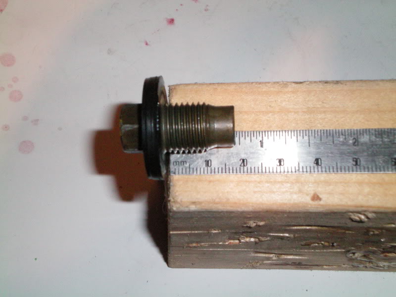

you are correct the QwikValve.com site appears to be in-correctly grouping everything from 2007 on as the GEN2 which would be a very ill advised 108
I've installed these for several folks over the years including my own 02 and always used a 106 so unless they changed the size for the 7 and 8 Cabrio I say 106
the 106 replaces this plug
