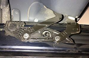

LH Mechanism missing two plastic guides:

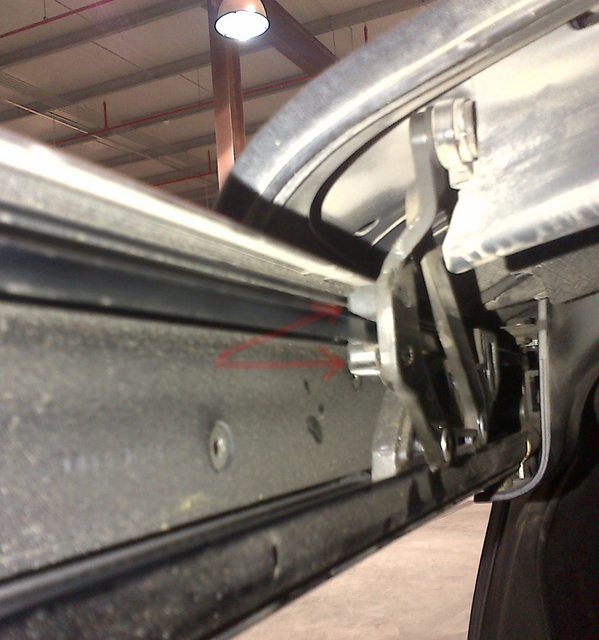

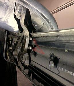

Close up on the mechanism and two arrows pointing at the missing guide tabs:

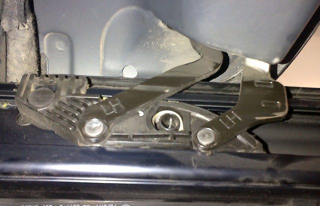

Compared to the other side which has them:

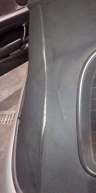

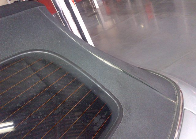

furthermore while we're at it.. the soft top itself is starting to get de-laminated near the rear glass:
any DIY tips to fixing this before it gets worse?

I don't really see how the top mechanism's tabs could possibly be knocked out by a purse strap in the window.
But to answer your question, it does seem that the only way to get those tabs is by purchasing the cable pair. (Unless you can find them from a salvage yard? Have a machinist make them for you?)
Maybe there's another cabrio owner who needs the RH cable and would split the pair with you?
