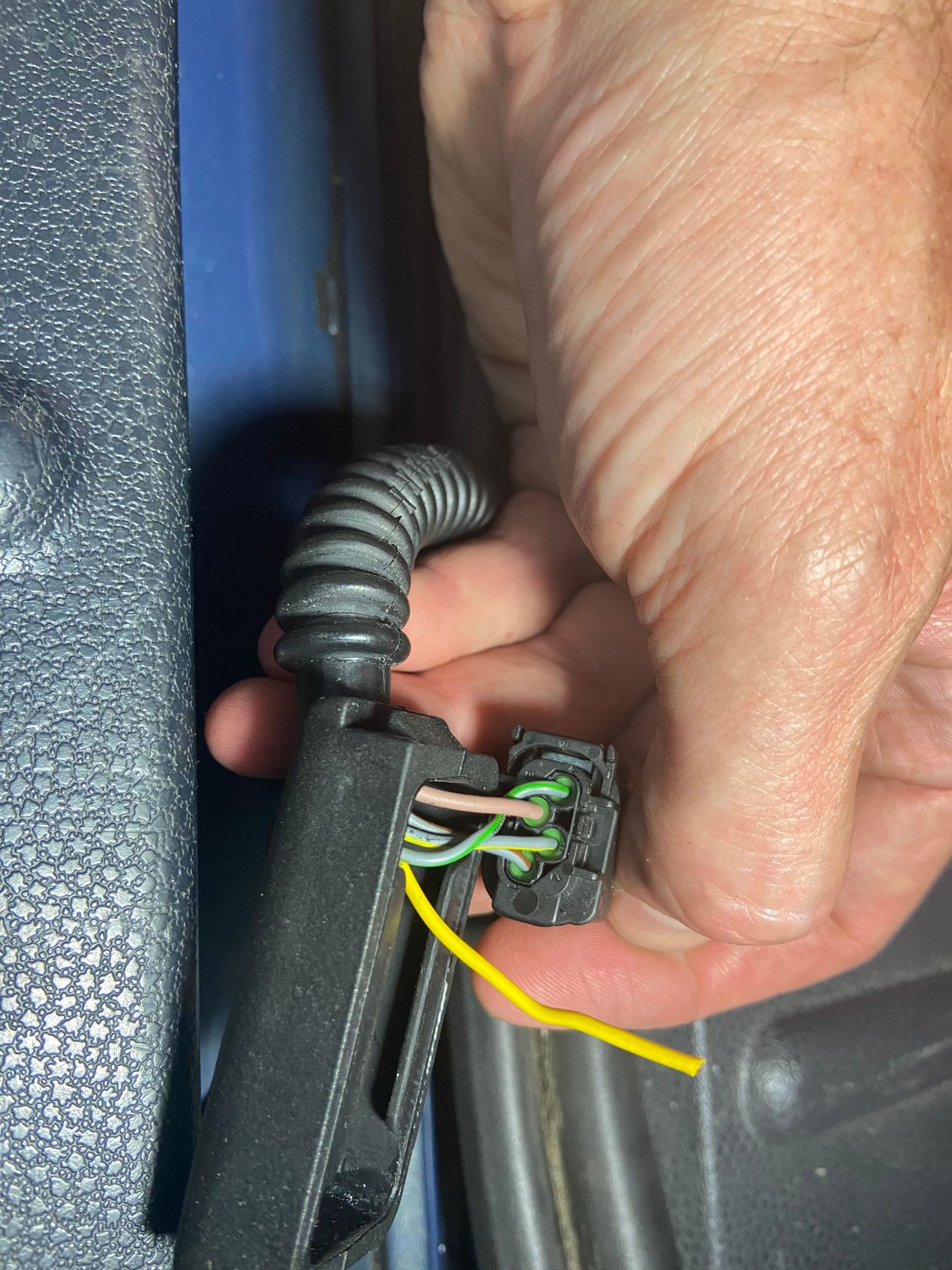

Broken Solid Yellow Wire, However…
I’m sorry to revive this thread, but my R52’s trunk stopped working months ago. I finally got an opportunity to look after considering whether it may be a fuse, switch or broken wire. I opted to look at the wiring as it was a prominent culprit in this feed. The first place I looked, where the harness feeds into the trunk, I discovered a solid yellow wire not connected to anything. I can’t find where it goes. The complement to the wiring harness has no solid yellow wire. I took the trunk plastic interior off and can’t find where this is supposed to go. Photos below.
Also, I’ve benefited from the great knowledge in this forum over the years. This my first post. Any ideas are appreciated. Thanks!

My first thought is that it goes in the open hole in the holder but you'd think the wire would show a bit at the end of the yellow wire. I looked at my trunk but didn't want to take off the back of the trunk opening not knowing whether this holder is inside the back or inside the trunk itself. Let me know that if you haven't gotten it fixed. You could always strip a bit of the end and poke it in the hole to see if it worked.

fredril12: Thanks for the prompt response. Your thoughts were exactly mine. I was going to do so, but not seeing a solid yellow on the other side held me back. I took the interior plastic off to explore where the other half of the yellow wire might be. You don't have to remove it to see the connector I photographed. It's at the base of the interior trunk hinge and just pulls out. I would love for you to take a look at yours - when it's convenient. That would help me a bunch. I couldn't find a video or other posting that showed that detail.

I checked my wiring and each of the connections only have 4 wires, no yellow wire at all. My wires are all 2 colored. I have a photo but I can't figure out how to get. in on this site as the iPhone changes the format to REIC or something like that that won't let me load it and I can't figure out how I got the pictures in before:(. If you want to give me your phone number, I'll text you the photos. I do have a yellow and white wire but it's on both sides of the connection. This all doesn't make a lot of sense. I have no idea why my wires would be different from yours. Anyway, my # is 301 767-6306. Thanks, Fred

The Yellow wire looks like the wire that is used when someone installed a back up camera
