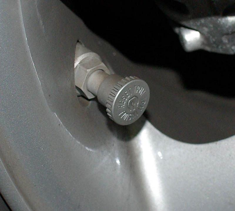

Pardon the slight tangent, but since you're talking about TPMS on an 08 Cabrio:
On of my valve caps went "missing". Is there something special about them due to their odd shape? Should I buy a direct replacement and some spares? At the moment, I just put an old metal cap on it.

Do they look like this?
CLICK HERE TO ENLARGE
I'm going to switch a plastic substitute for my metal one until I get a replacement.
