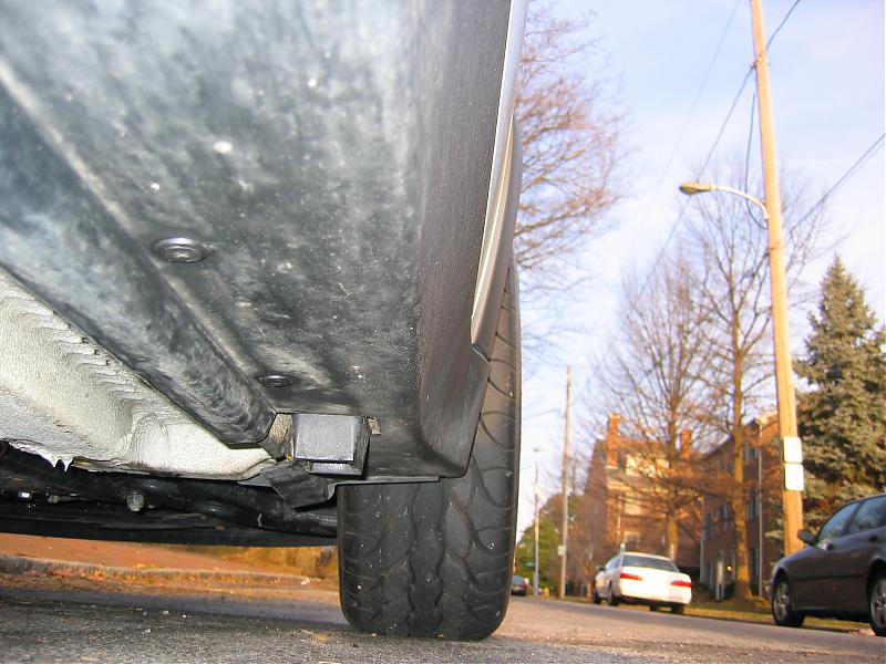

Jack Point
The picture of the underside of my car shows the jack point is outboard of the seam and is the (I think) prefered surface to jack the car on my Mini (06 non s 08/06 production).
I will use a 2x4 block just far enough away to allow a jack stand to be slid in when it is raised. I also think a 2x4 will distrubute some force over 4 feet, but will only prevent deflection over a foot or so (6" each side). You can bend a 4' section of 2x4 with your own weight.
