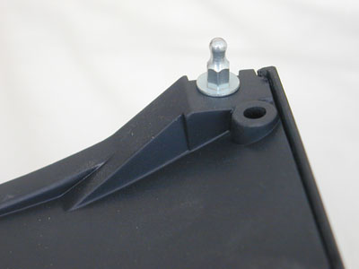

I have a 2006 convertible too and mine pulled off without much effort. Here are a couple of photos of the back side that may help you get your orientation. Give it a good sharp yank to try to get the two top corners to release. Maybe your fasteners are stuck extra tight.
I'm in San Francisco and could help, although not this weekend. PM me if you need additional assistance.

Here ya go.... Look at the picture in the above post...
now take a large screwdriver, wrap some cloth around the shaft ( to pevent scratching ) insert the driver between the space between the boster and the dash... now gently push the screw drive up and down working the driver into the crack..... she will pop down.. do this in the area of the metal studs you see the the pictue in the above post

Hmm... if it's misaligned, I'm guessing that the prong on the bolster missed its mark during fitting and the installer applied some "English" (appropriate for MINI) to force it to fit.
