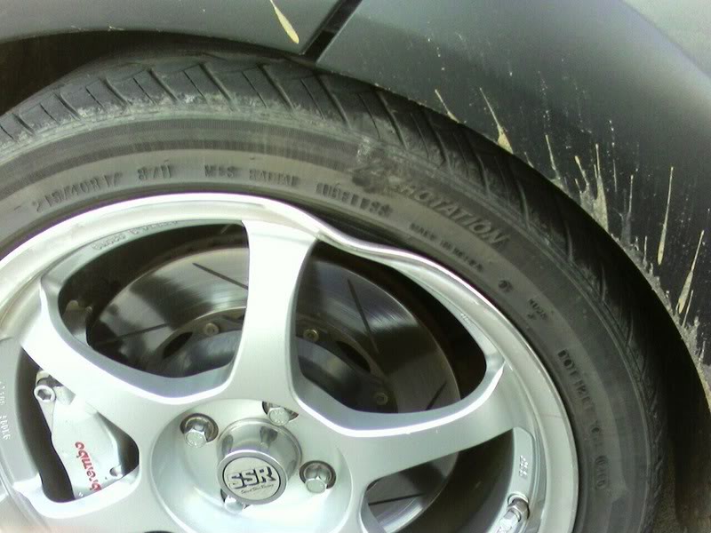

I was riding my 1 day old MINI (it is an 03, but just bought the day before)and the asphalt company had cut a strip out of a perfectly smooth new road to check asphalt thickness. This left an unmarked 4.5 inch sharp edged curb that I hit about 35 MPH....

Beautiful SSR Comps are ALL bent, Pretty violent bump. My front fender was dragging on the pavement when my tires were in the hole - you can see this in the photos above. Fortunately the Mini drove home without incident, alignment seems OK, Turned OK, no odd noises, but didn't push it as the rim looks like the tire might come off. It did start to get a bit of vibration above 45 - probably need to get the tires balanced .
Looked under the car and didn't see anything out of order. The nearest MINI dealer is 250 miles away, so need to take her to a local mechanic.
My question is - what should I have them look for?? Bent control arms? Strut towers??

I'd look for a way to get the asphalt company to pay for the damage to my MINI.
Look at the upper front strut towers for evidence of "mushrooming" of the towers. Search "mushrooming" on NAM and you should get pictures to help with this.
I'd be plenty mad about hitting an unmarked abrupt change in the asphalt thickness, and at least try to get paid for the damage to my car.

ouch... i would first check the strut mounts, control arms, hub, for any bends/fractures, and also mushroom on the tower. I would also check
the rear too and your tires for any bubbles.
i would also put your factory wheels on and get an alignment done.

I'd killed 2 runflats tires due to bubbling. One was a pothole and another a rock. So make sure the tires are ok.

If I had to guess, I'd say that the tires are damaged. That
was a profound impact!

Seeing the photos of your bent rim makes me realize why big/low profile tires are such a bad idea on this car.
If I were you, I would sacrifice the "cosmetics" of the wheels a little and spring for 15"-16" rims and tires with a higher profile (At least 55 and up).

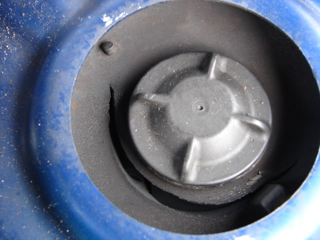

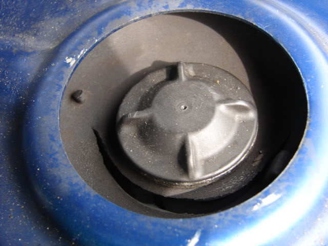

Here is a picture of my strut mount after I hit a big pot hole at ~40mph. I also bend my rim, tire (RF) was saved though.
I would call your city and complain, and take it to a local shop for a full assesment of the damage (if any) that was done, and best if you take it to at least two different companies. No way you should have to pay for that. IF THERE WAS NO! SIGN OR MARKINGS OF COURSE. If there was, then your outta luck. Make sure to take plenty of pictures, and make sure to set your camera to time-stamp the pictures...so if you go to court you have evidence. Take pictures of the surrounding area and street signs too, so they know the specific location.

Holy crap Cody! Am I seeing a rip in the unibody? POTHOLES WILL KILL YOUR MINI WITH 17" RIMS & RFLATS!!! We just got ours back from a right rear pothole repair last week. FYI, insurance companies treat pothole damage as an at fault accident. We have to pay the deductible and insurance got the rest They don't go after the city/state, etc. It's good to hear that construction zones are a different animal.

You'll note in his pics, he has an MCS-JWC. The 15" won't fit over the brakes, and the 16" are a maybe depending on the wheel design. JWC brakes are larger.

The Body shop finally hooked the car to their computer, the front of the unibody is slightly bent upward and the strut towers are slightly bent outward, even with the ProMini Strut Brace. The shop manager was amazed at how little movement the strut towers made - he kept praising the strut tower brace for preventing a lot more damage..... Still the driver side strut is toast and he is going to replace the pair of struts, put the car on his frame rack and spend 4 hours bending the car back into shape....
