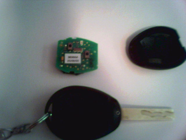

On teh MINI, they key is not actually programmed at all, it is the BCM (Body control module) in teh car that is programmed in how it responds to the key button presses. That is why there is no button sequence to do anything.
Also, if you take the key apart, you will see that there is no connection between the electronics of the key and the metal part. (sorry for the bad quality pics, I took these with a camera phone a while back and never have gotten around to using the real camera)

If there is no connection, how does the battery in the key get re-charged...osmosis? According to my owners manual for my 05 MCS the keys are recharged during vehicle operation.

Oops, the 05 key is different, the one I showed is an 04, you can see the standard battery on it. I'm sure the key is rechared by induction which requires no physical connection though. I still doubt that the metal functions as an antenna since wavelength is a factor for determining antenna size.
