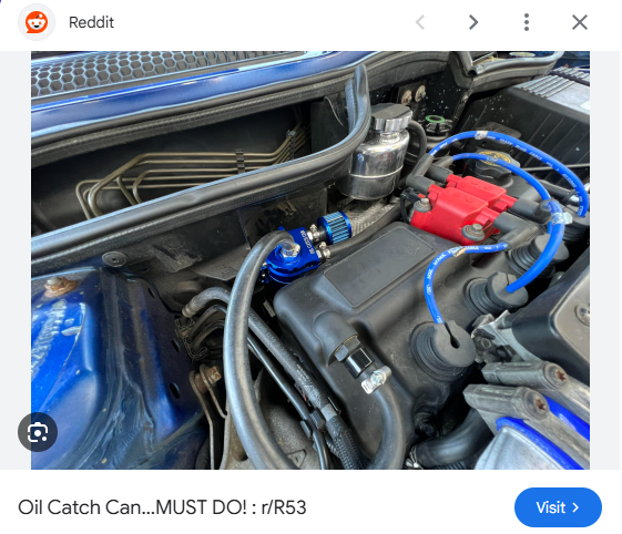

RE: vacuum leakage
i do not know the answer but bouncing around the WWW you'll see stuff like this were someone is running a breather filter which seems like it would introduce a vacuum leak but apparently not because the car was said to be running good --- makes me wonder?
