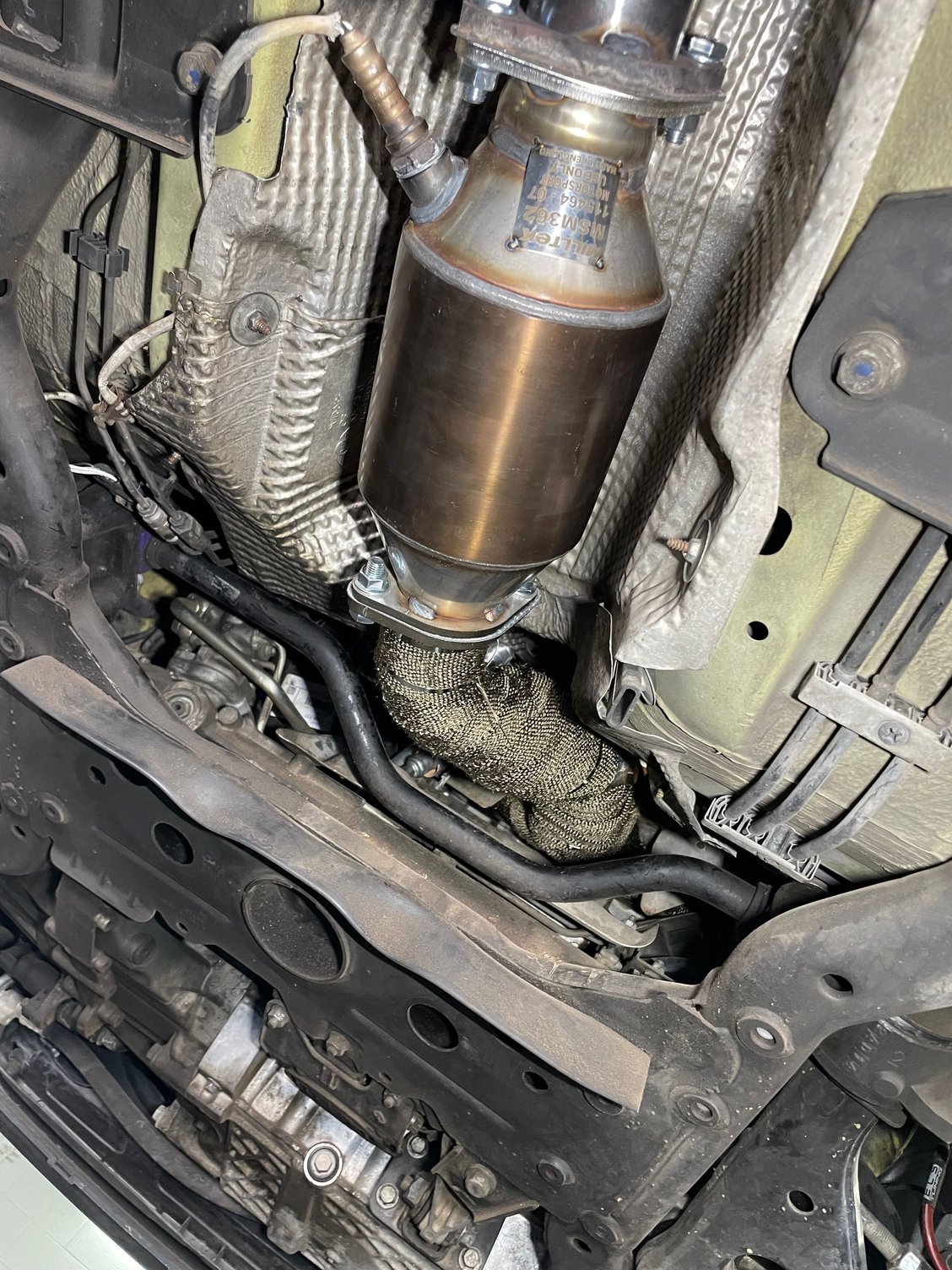

I have the same issue with my new Magnaflow (from Hottexhaust) converter on my r50. Will try banging on the heatshield to make some room for the cables.

After banging on the shield. Enough for a small gap from the cables.

yeah that is close. maybe you can bend the shield a bit more. and maybe wrap it with heat tape, heat shield wrap to protect the wires
