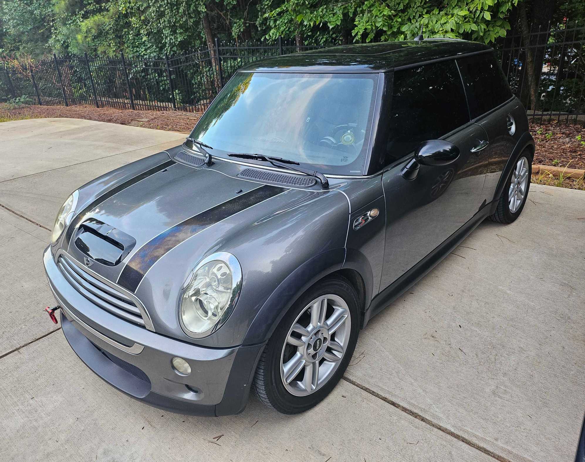

Good looking car! I love the grey with black details.
Not so sure about the towing hook though
Thanks! I've been looking around to see if there is a black-out kit to dechrome pieces (headlight, door handles, trim, etc) but haven't found anything in a package. Just piecemeal. So that will wait until the engine bits are all set. And what do you mean about the towhook?! That's a DINAN towhook worth at least +5HP!! LOL. Ok, maybe not, I just have to look through the box of odds and ends that I got to see if the tow hook cover is in there. If not, it will stay until I can replace the hole in the grill. It's not as bad looking from the front view though. All in due time. :-)
