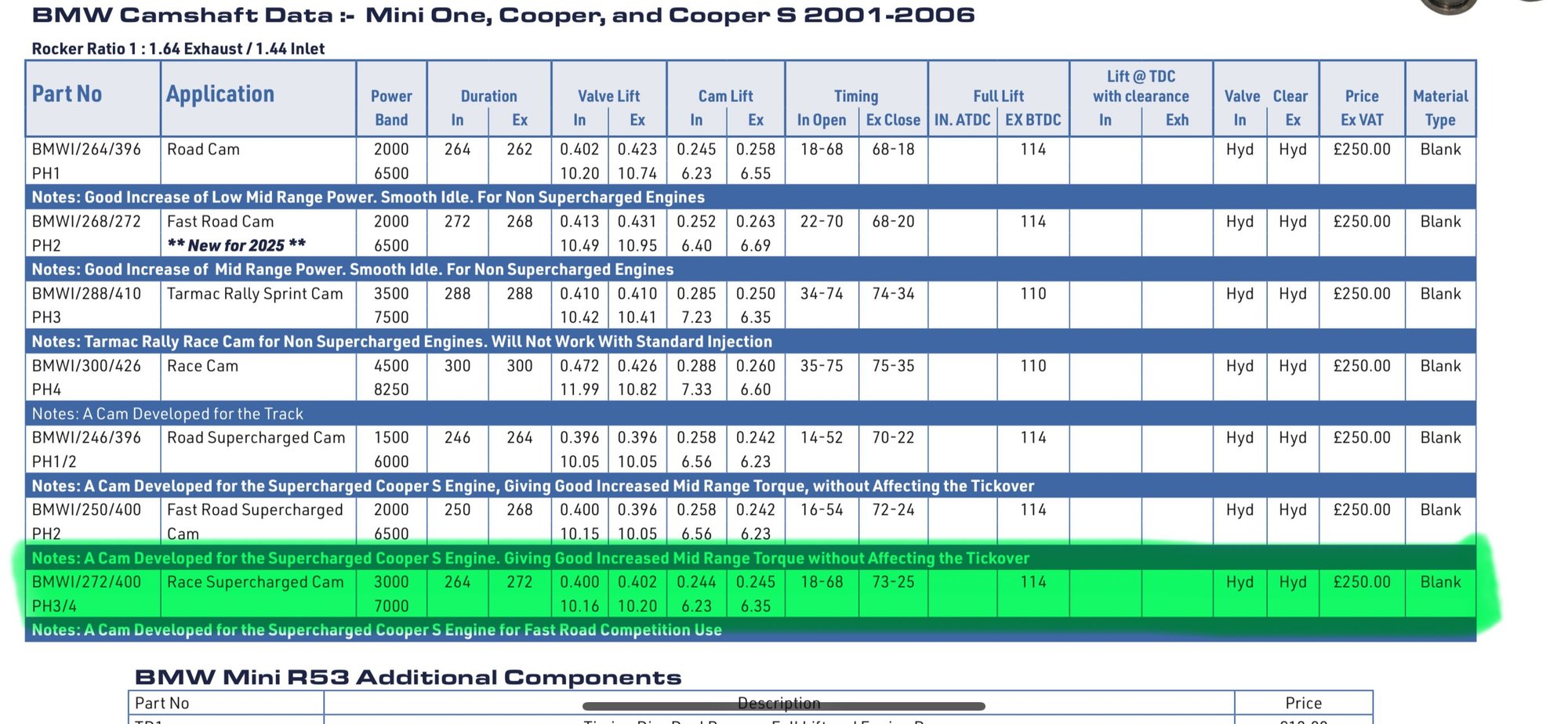

What's the lift on your cam?

Hi mate, been a minute. Hope you are well.
Camshaft details.
Camshaft details.
There’s no wear on them or the spark plug cylinders. And last time the ticking went away for a short while when I ultrasonic cleaned the rocker arms and then soaked them in fresh oil. But didn’t last long. Leading to thinking it’s the dampeners. However wondered if anything could make them go bad like oil pressure and how I could make sure it doesn’t happen again when I buy new rocker arms.
