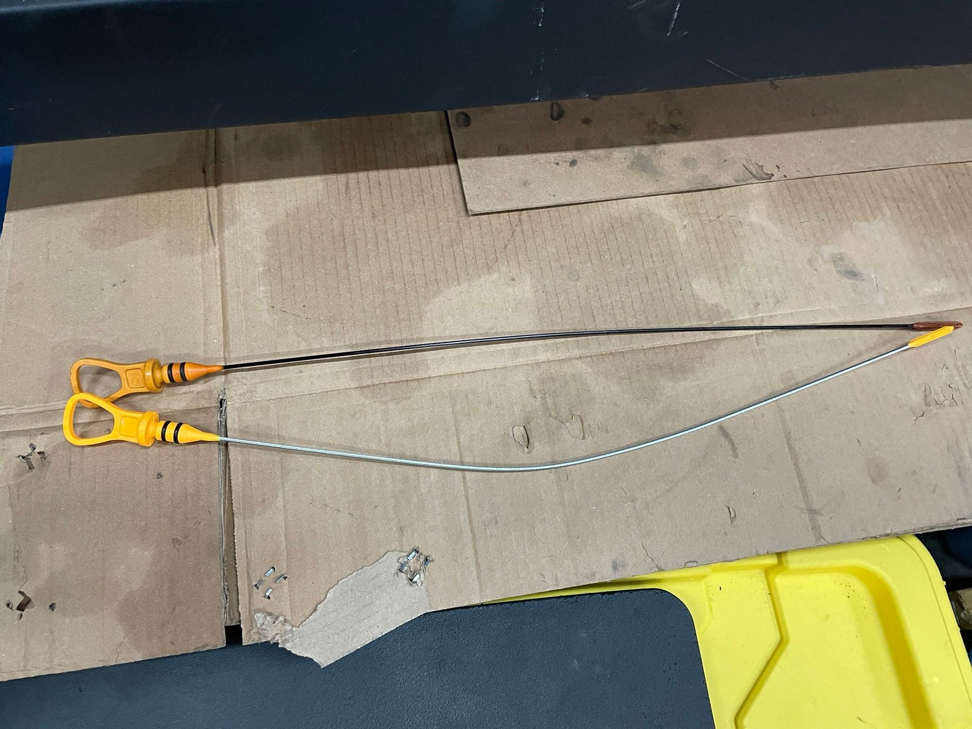

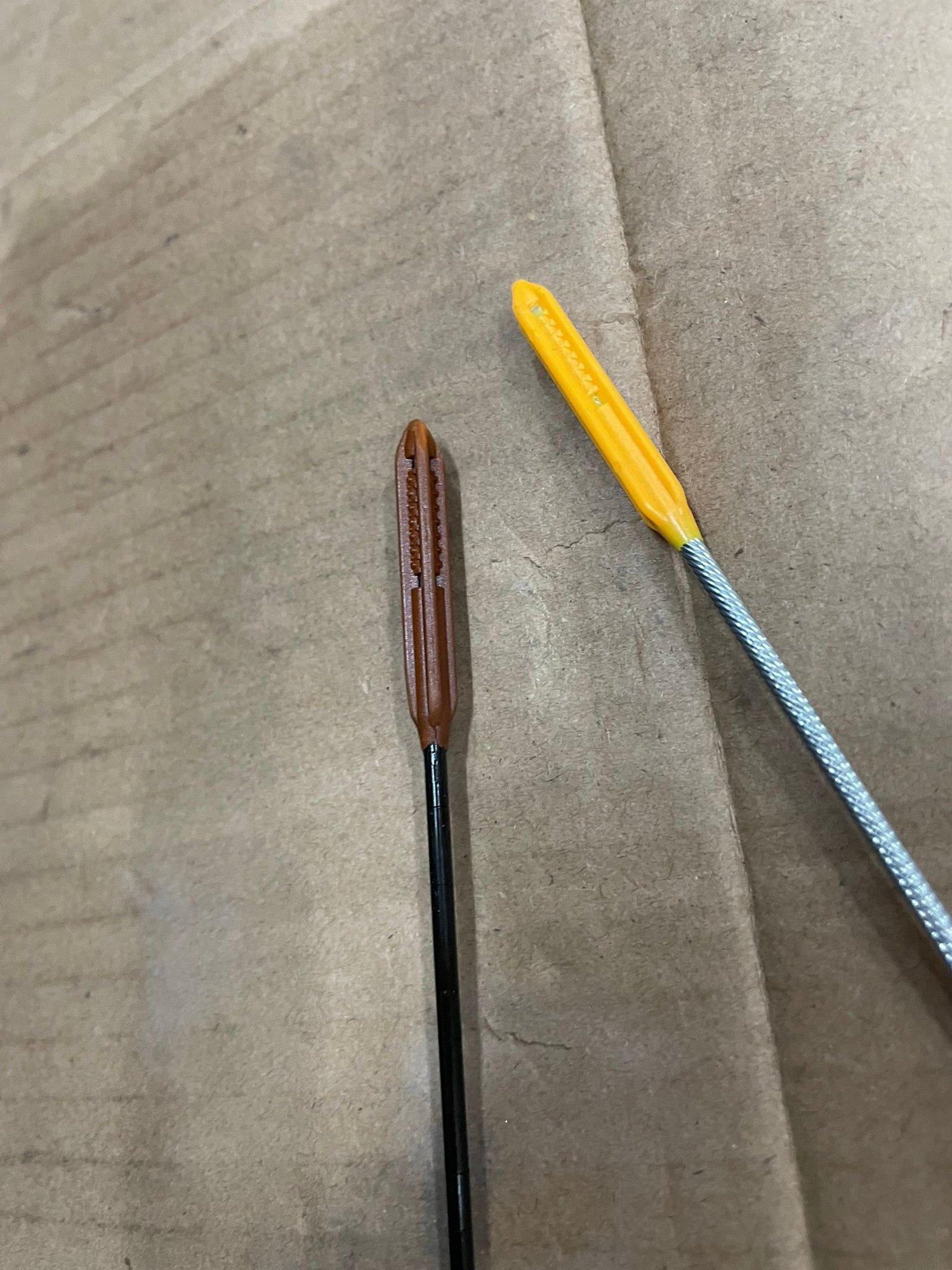

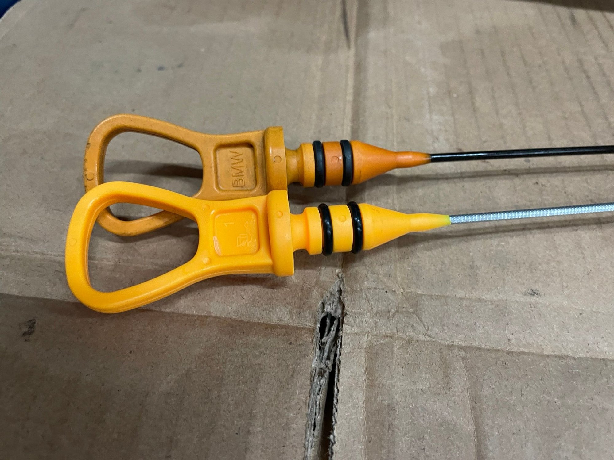

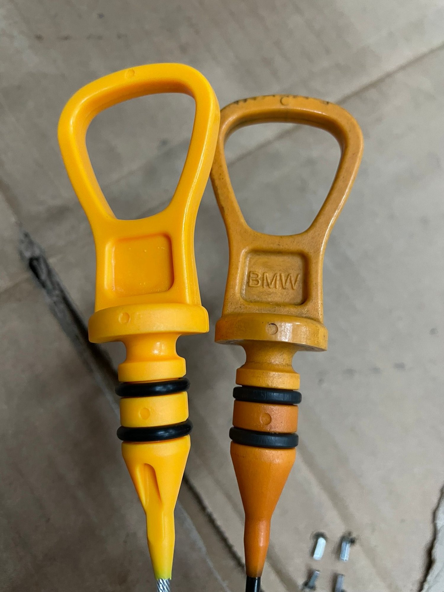

So, I've bought two dipsticks:
1- "11437509784 Engine Oil Dipstick Level Dip Stick Fit for 2002-2008 Mini Cooper S 1.6L L4 R52 R53 R56 W11B16A" (
Amazon Amazon
and 2- "62cm 24.4 inch Engine Oil Dipstick 11437509784 for BMW Mini Cooper S R52 R53 2002 2003 2004 2005 2006 2007 2008 - Perfect Check Oil Level" (
Amazon Amazon
Here they are, from left to right: #1, #2 and my original one.
The #2 is very similar to original in terms of materials, while the #1 is made of the proper wire. So, I ended up using #1.
