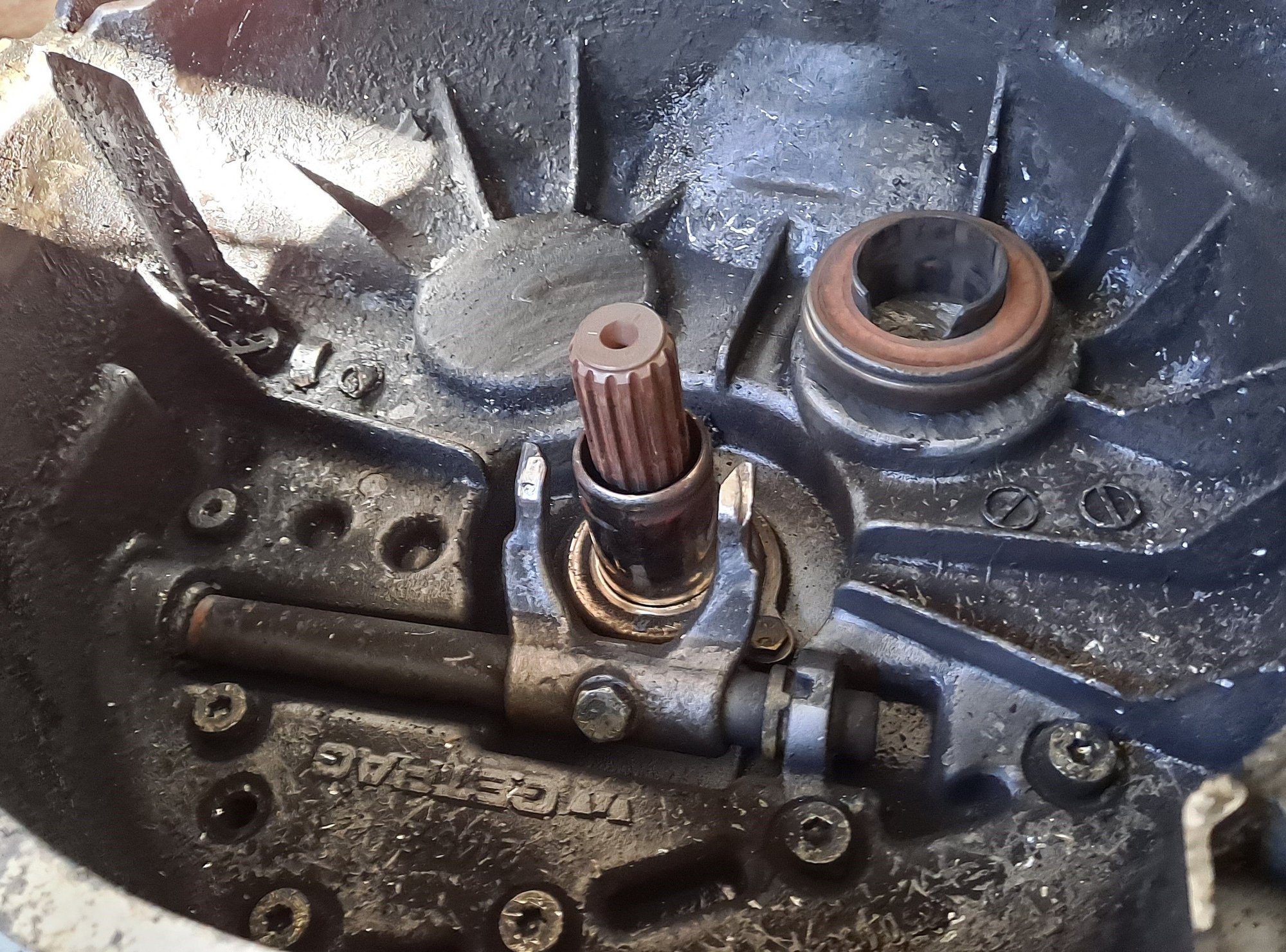

Your shift fork looks like this picture below, no?
I has been a couple of years since I took this picture. If I remember correctly, I also had difficulty with the shift fork. I seem to recall having to tap on it with a hammer after I removed that bolt to get it to move so that I could replace the bushings, input shaft seal and release bearing.

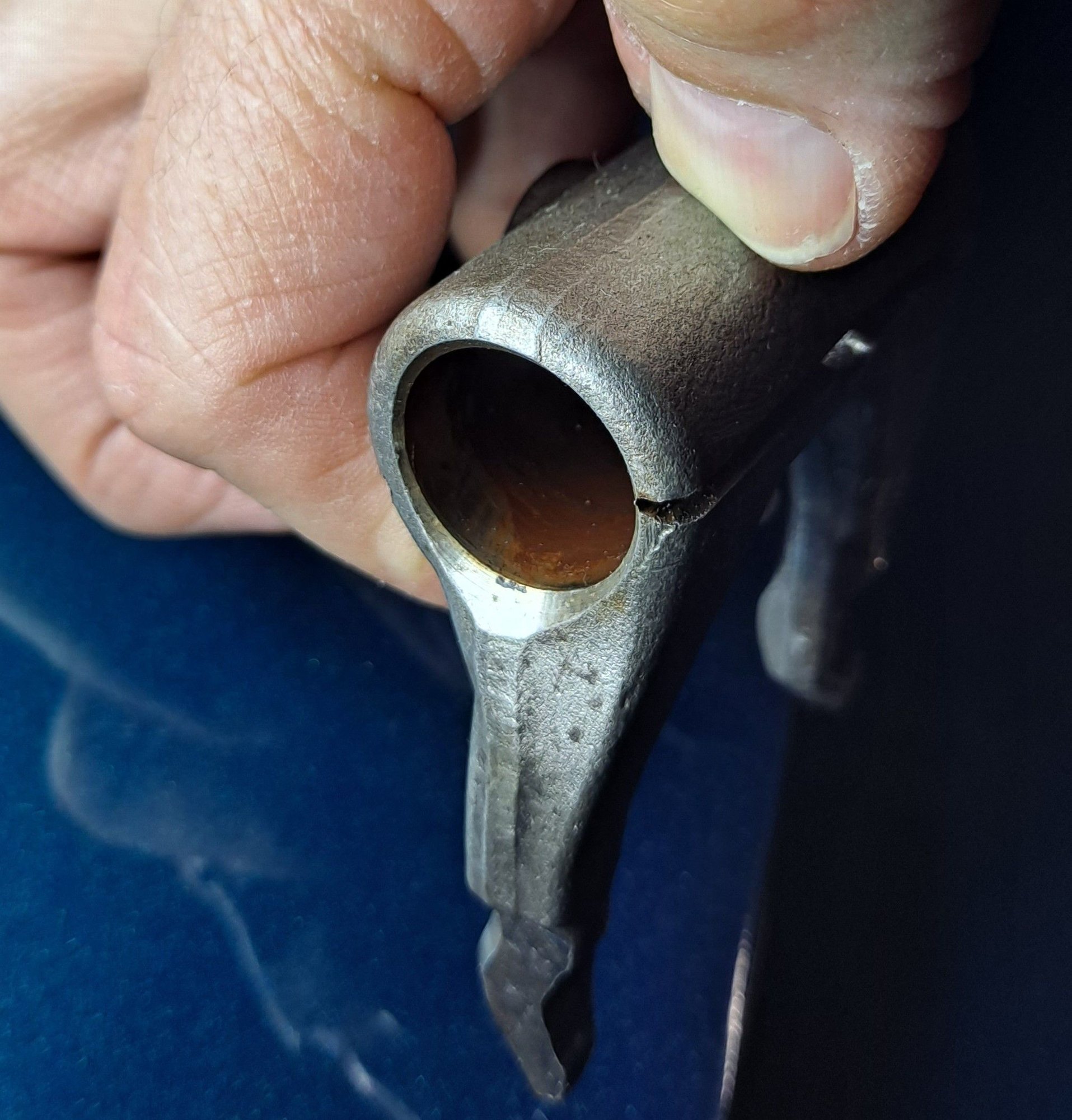

Here are a couple pics trying to show the bit of rust on the inside of the shaft. Also a pic of the inside of the housing showing all the nicks caused by the throwout bearing pieces whenever it came apart.
The cut marks on the side are where i used the cutting tool
You can see the wear on the fork here, as well as the throwout bearing sitting off to the side.
