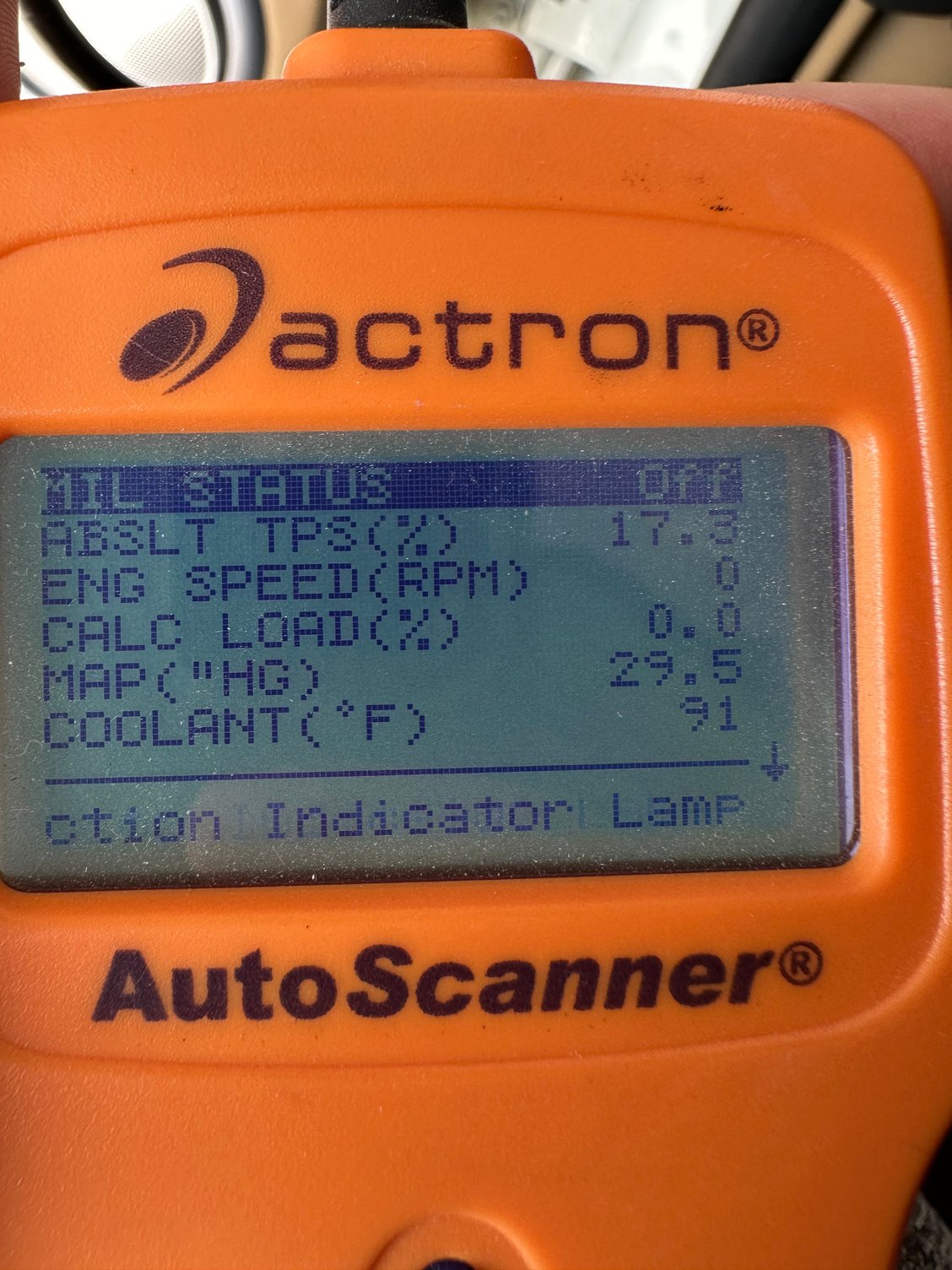

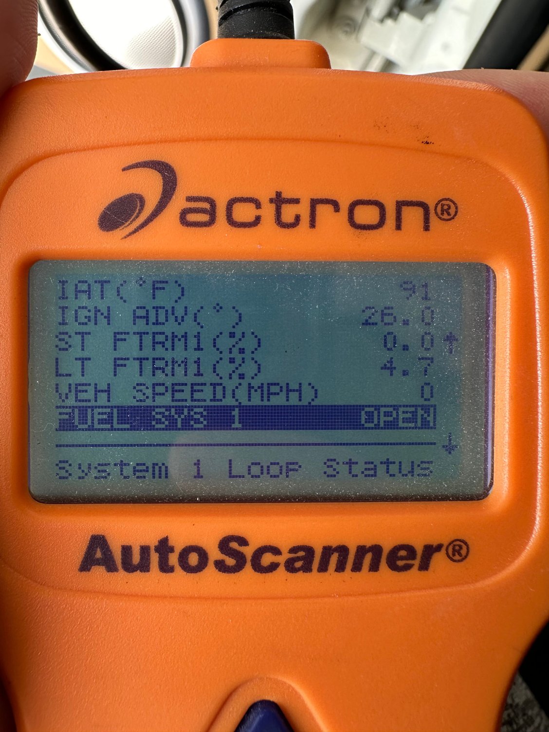

Don’t know if these shots help but this is the “live data” from my scanner if it means anything (ignition on but car turned off)

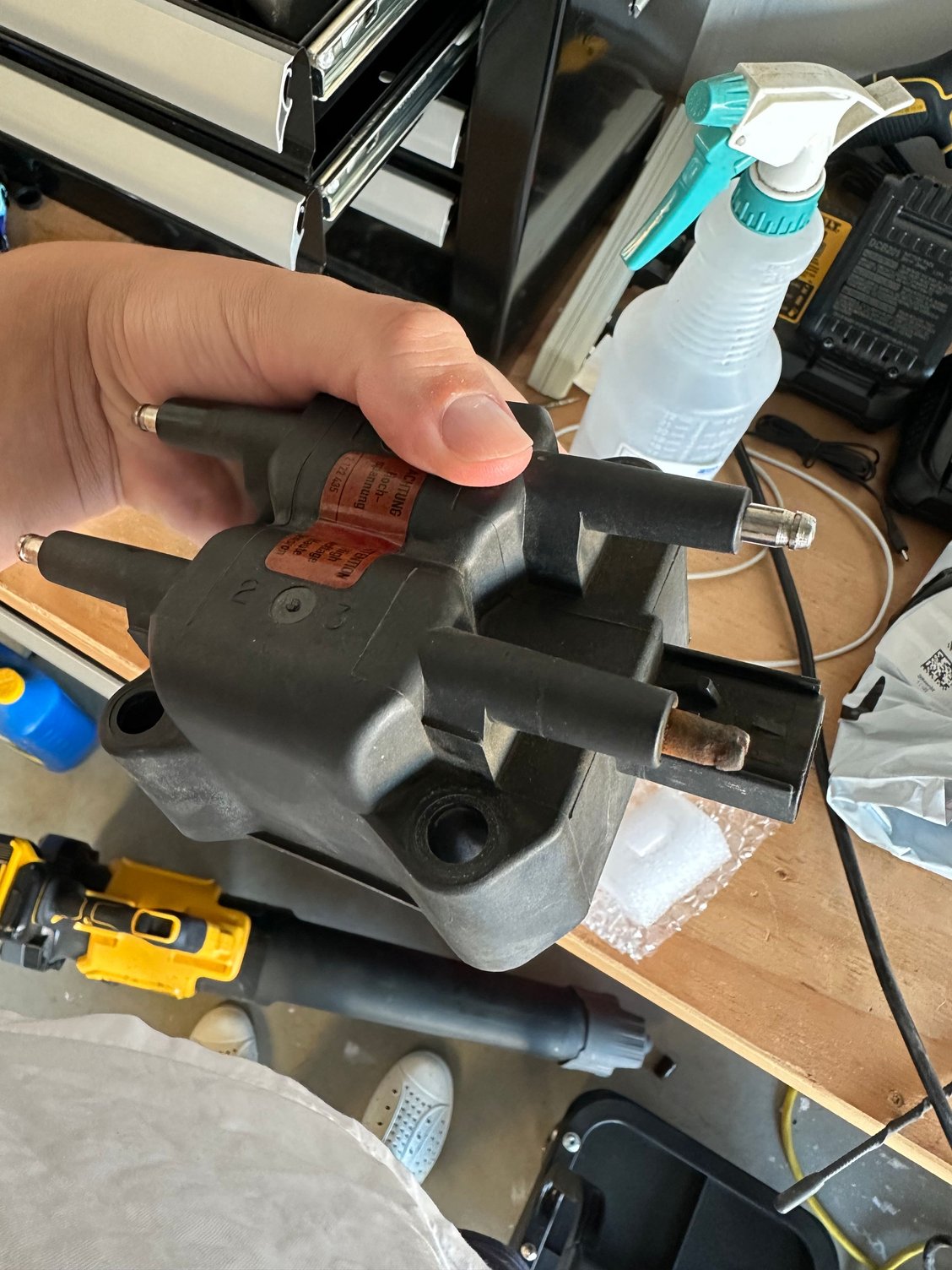

Spark plugs and wires were changed - more as a precaution bc I don’t know the history on maintenance of what’s been done. Doing so though I found out that the coil pack was bad - Post #3 was corroded so I got a new one but the original bolts didn’t fit since they were sleeved went back and ordered a Delphi one on Amazon (since AutoZone wanted double the price and a week+ to get it shipped to me) and thankfully that one can use the original bolts

After reading some more I guess post #3 is prone to corrosion on the coil packs? Weird things.
Corroded post - probably a reason why I got inconsistent rough idles and couldn’t start without a few attempts
Delphi replacement that reuses the old sleeved bolts in case anyone else wanted to know - $33 on Amazon straight from Delphi as well
