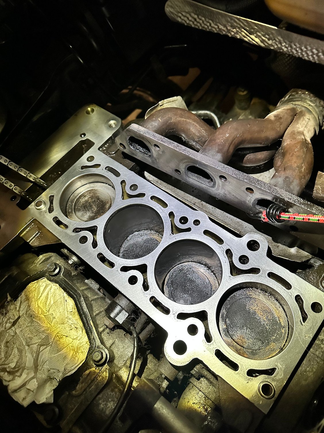

Crushing at 225kph on the autobahn sustained for 20 minutes and I lost compression in a cylinder, instantly I thought it was the head gasket when we pulled over, google said you can run on three just keep it low in the revs, the oil was good no mixing, no overheating but we still had a while driving to get back to Prague from Munich where it blew but get back we did.

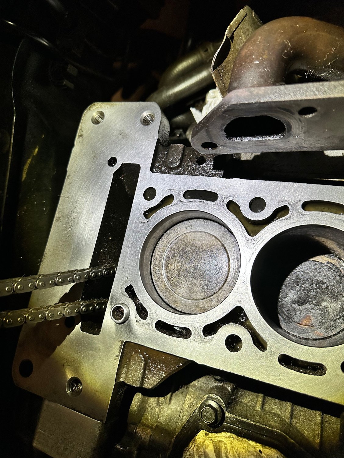

I lifted the head and dropped to the machine shop for a skim, on first inspection they said I had blown a piston due to the aluminium residue on cylinder 1 valves. So I dropped the pan today and pushed out the piston but looks identical to the secondhand replacement that arrived today.

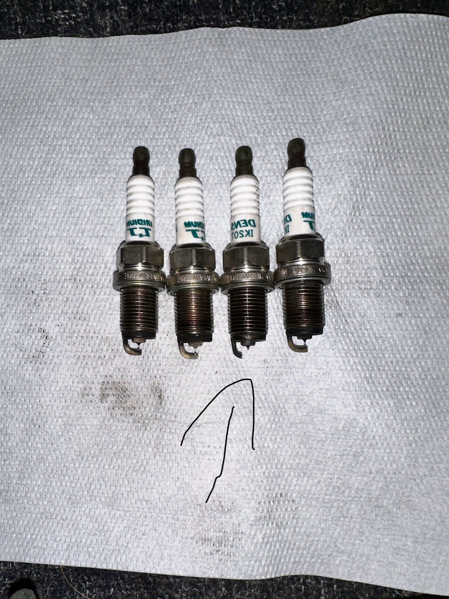

So I’m just trying to understand where this residue came from and if it’s safe to put back together? The plug was missing 4mm off the anode but this is too little material to account for the residue on the valves + plug aren’t aluminium.
