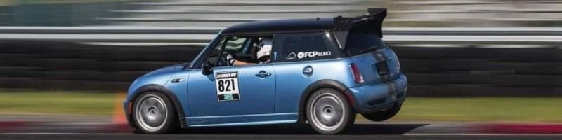

I'd guess that they were a reputable brand since he went full RMW with everything else --- he was runnin' hardcore max ragged edge at GridLife TrackBattle TimeAttack!!!
Found this viddie of him driving his 2003 RMW 1.8 stroker at NJMP circa 2019:
