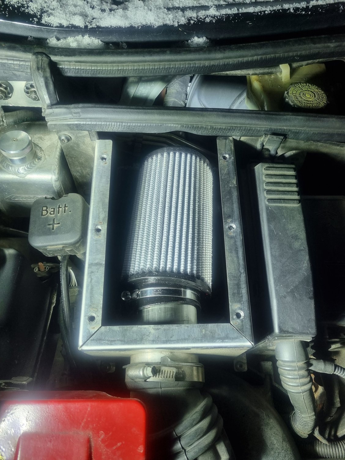

Done!
For those interested...
I was able to get a hand on the AFe filter 21-90082.
It's got the 2-3/4" ribbed flange mount, 4" diameter x 7" length.
Also the same 10 deg mount.

i have that exact filter. i messaged AFE to ask about a filter wrap and they recommended this one 28-10213. it's not a perfect fit, but it pretty close and way better than nothing!
