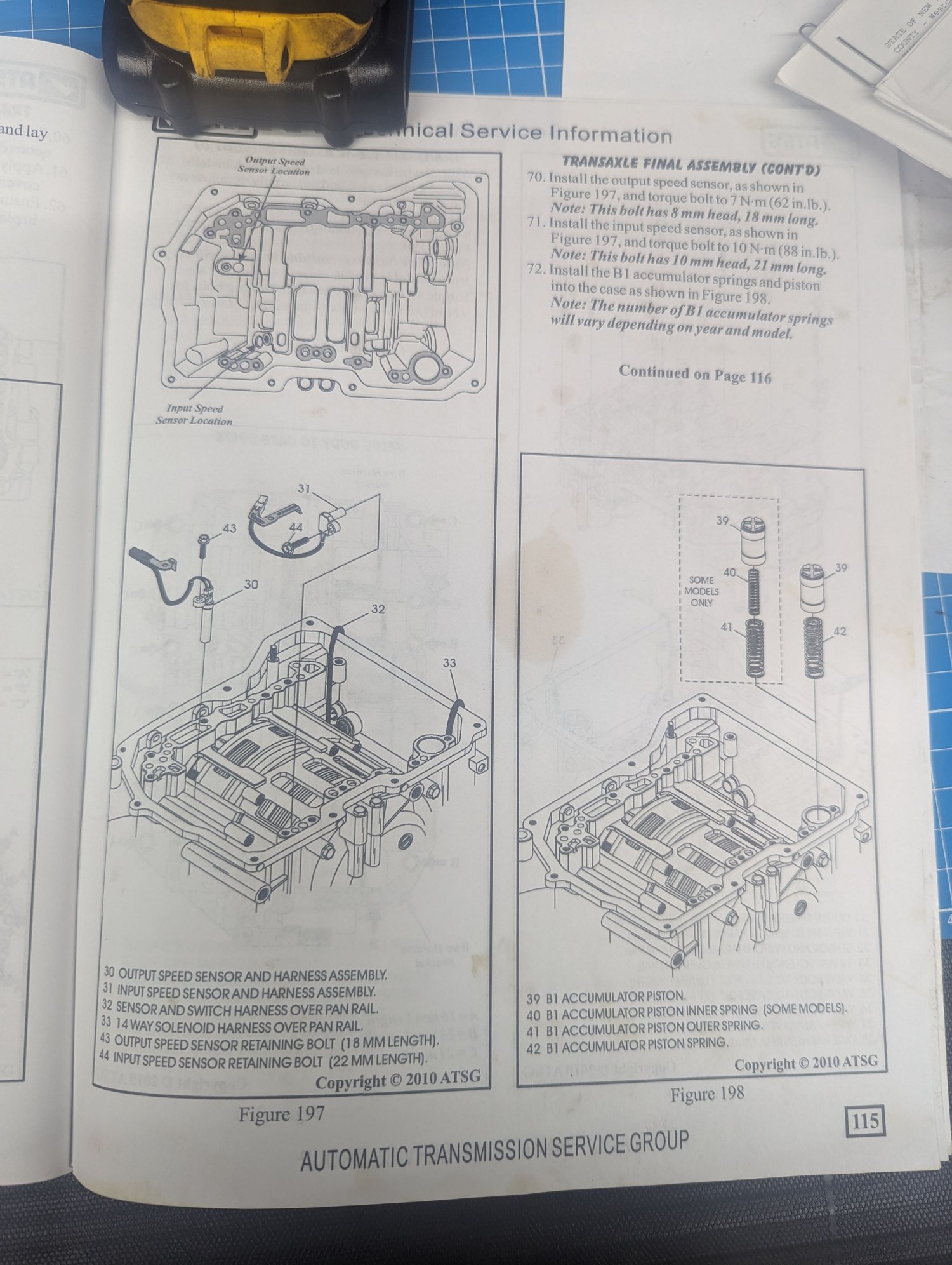

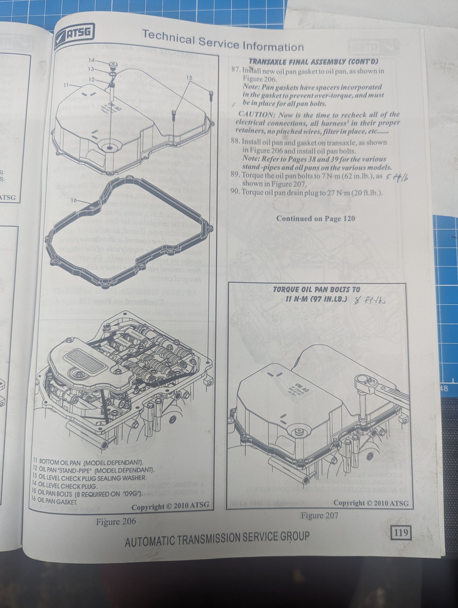

Update: I replaced the entire valve body with a remanufactured one and new set of ATF. Reset adaptations and it's running well.
I'm about 70 miles since I reset the adaptations and the shifting is getting much better, it really does learn. I read somewhere it takes 50-100 miles to learn so I'm well on my way. And I answered my own question, my scan tool does work for this:-)
I bought the Aisin book for my rebuild. it was helpful. I'm posting a few pages here relative to the valve body to help anyone who might stumble on this page in the future. One thing it doesn't show is the wire connections to the solenoids, which is what I wanted. But I took enough pic before my original disassembly.
