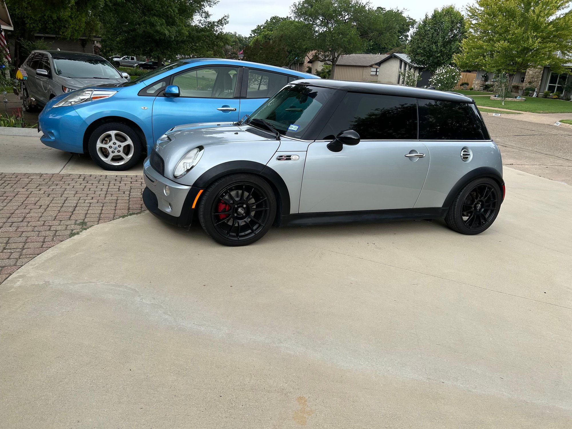

Just picked this up last week. 82k miles. Pretty clean all around.

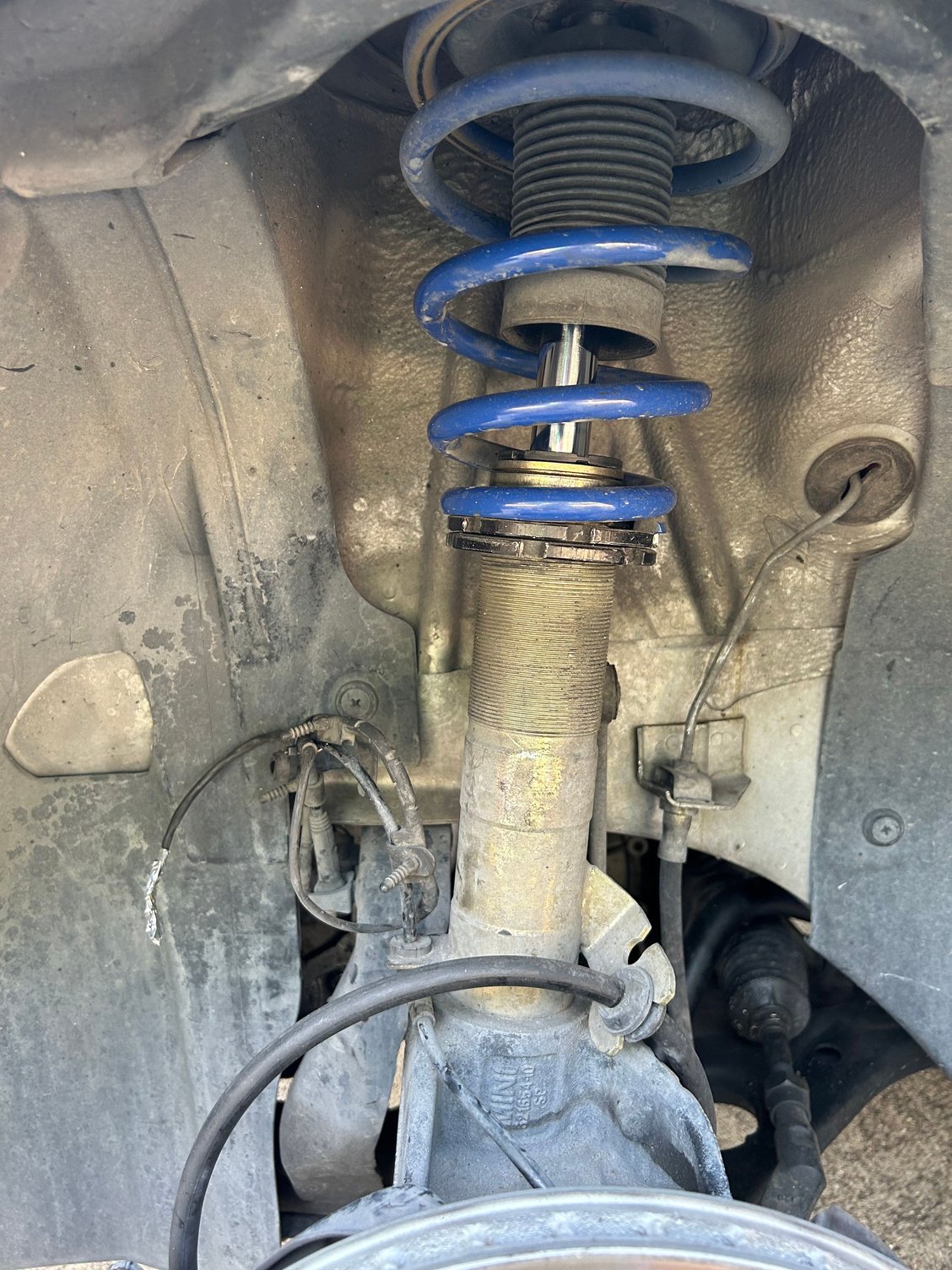

appears to be lowered on an aftermarket suspension - any ideas which one? Top hats look stock.
Did a wheel speed sensor and the top engine mount so far. The mount really made a difference shifting - much tighter and more consistent now. Especially when taking off from a stop.
Looking at doing the crank pulley and maybe resonator delete next.

Those are coilovers. Definitely not stock. From the pictures it is evident they are in their highest setting, so if you clean them up some, you will be able to see what brand they are and also lower your car if you like.

NOT 100% sure - so take this from a non expert:
They appear to me - perhaps Bilstein B14 (???)....
I just ordered/received a set of front & rears last month but haven't installed them yet.
Just a guess.
Nice looking car btw
EDIT: My B14's are still boxed. When you do clean your struts; see if this # is stamped anywhere on the tube 47-126916

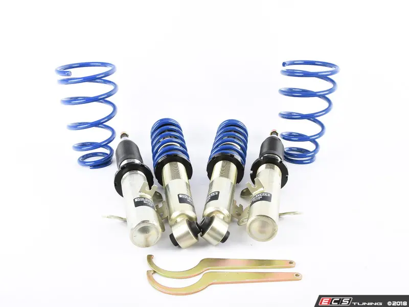

Solo-werks from the looks.
https://www.ecstuning.com/b-solo_wer...s/s1mn001~sow/
