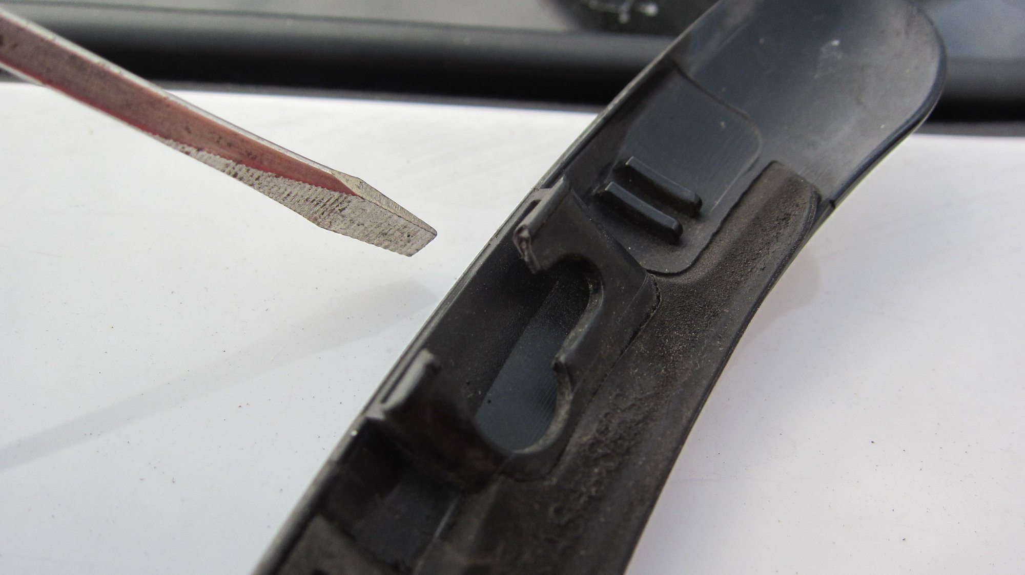

Firstly, they broke the small trim piece/molding that fits to the car above the A pillar.
This has a keyhole-shaped location slot in it that slips over a clip attached to the body.
The correct way of removing this trim piece is to slide it forward about 10mm and pull gently toward you.
I guess that they learned from this side because the driver's side is just fine.
Now this little piece of trim cannot be purchased individually.
So, unless you can find this piece in good condition from a breaker, you have to purchase the whole length of trim from front to rear.
I got mine from ECS Tuning, plus a few extra clips just in case, at a cost of $141. Yeah. And that's for each side.
