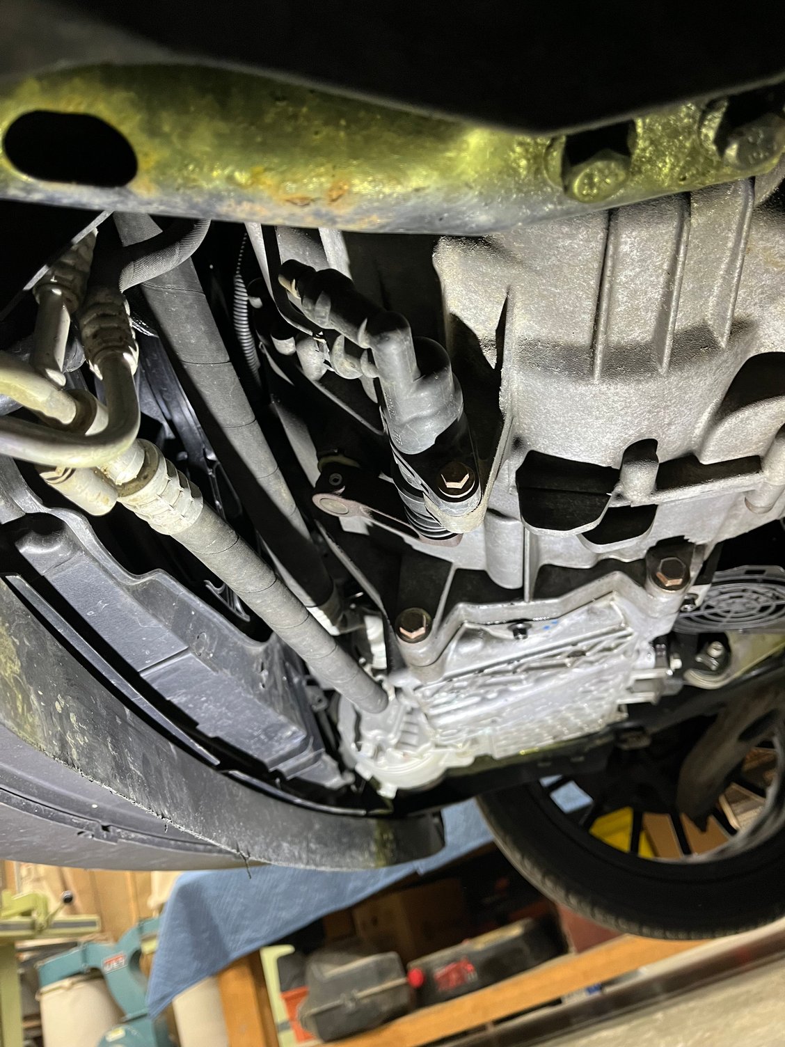

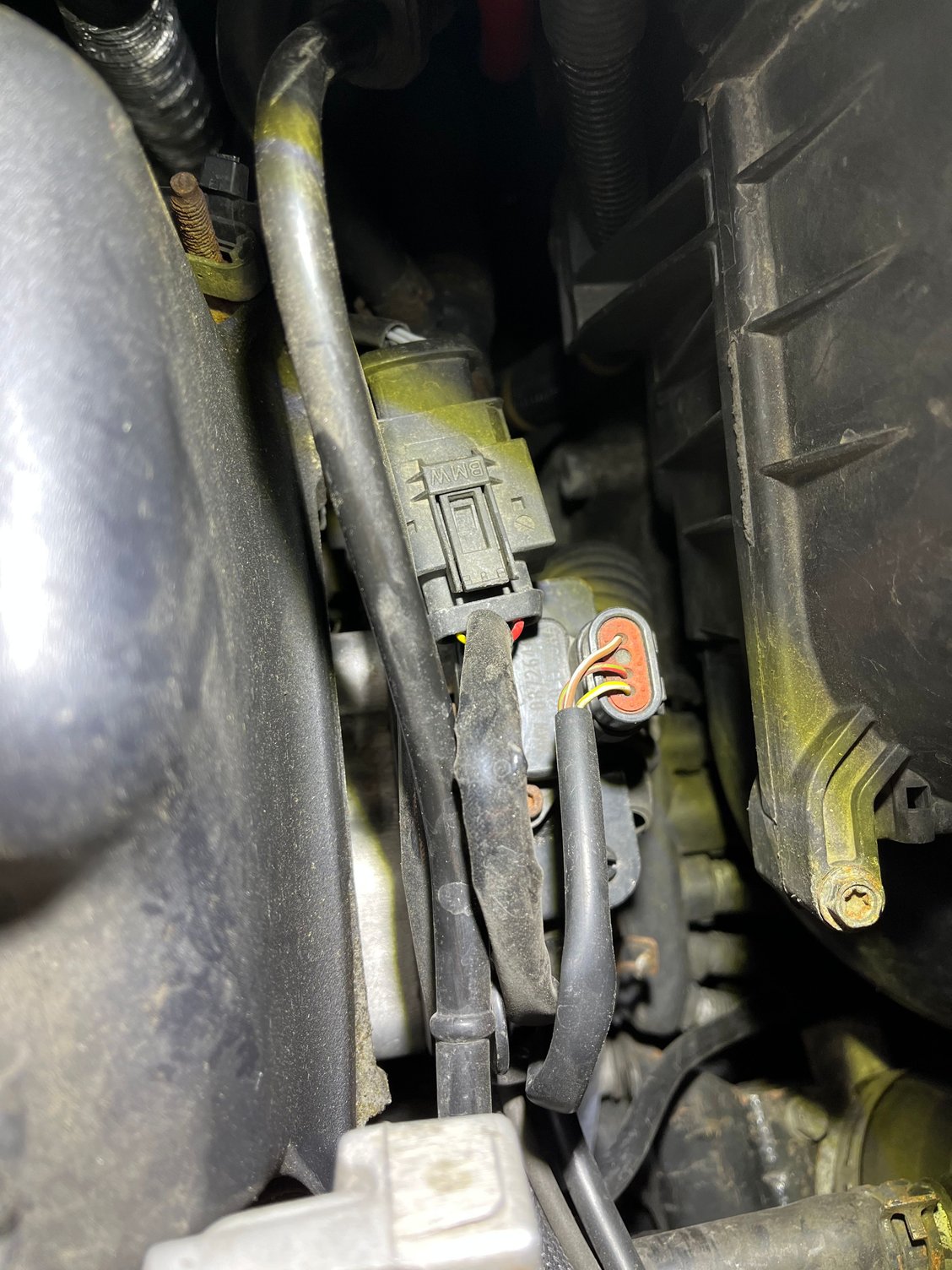

So I finally had a chance to work on the water pump “issue” …. Had car on the rack, started it up and let it warm up for 15 minutes…. No leaks!😳😳!! Took car off the rack and took it for a ride of about 20 minutes, going through all the gears and using the heater( it was 32 degrees in Ohio today) brought it back and upon the rack…. No leaks😳😳!! I have no idea what the leaks could have come from before, bone dry today, looked all over? We’ll have to wait and see…. Here’s a few photos of the non leak

See a lot of antifreeze residue. As much as I am not a fan of washing engines I will make an exception to remove coolant residue after a spill during refill or after a severe leak has been fixed. The coolant residue can smell when the engine is hot and whenever I smell anti-freeze I think leak. So I prefer to have the engine clean. With the engine clean any odor of anti-freeze is a leak.

Yep, wash it off and them smell for something sweet. And look at it again after a couple heat cycles.
