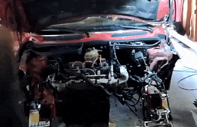

I've seen great results, but it's definitely tedious. When I had longer garage workdays I'd set up my phone for timelapse video...because why not. I have an iffy quality video of an engine bay steam clean. It's not great, but you can definitely see the color change on the strut towers.
Have lots of rags on hand!
