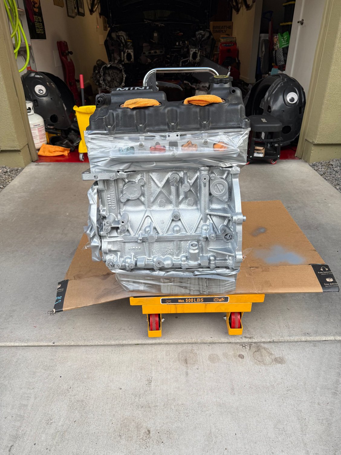

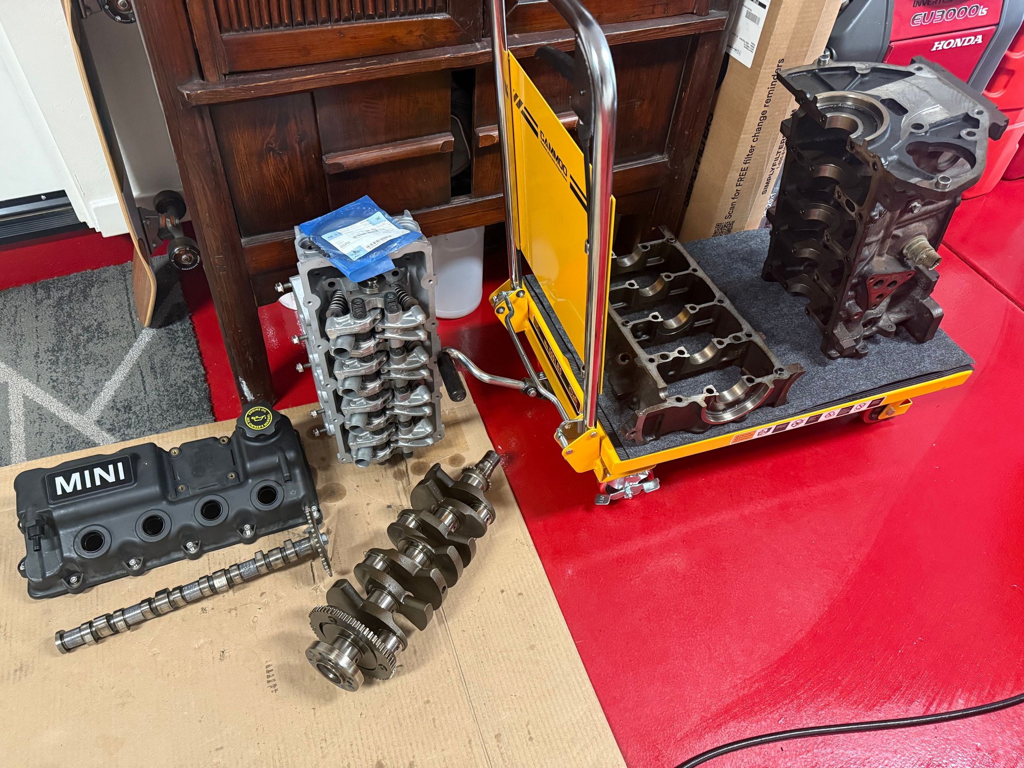

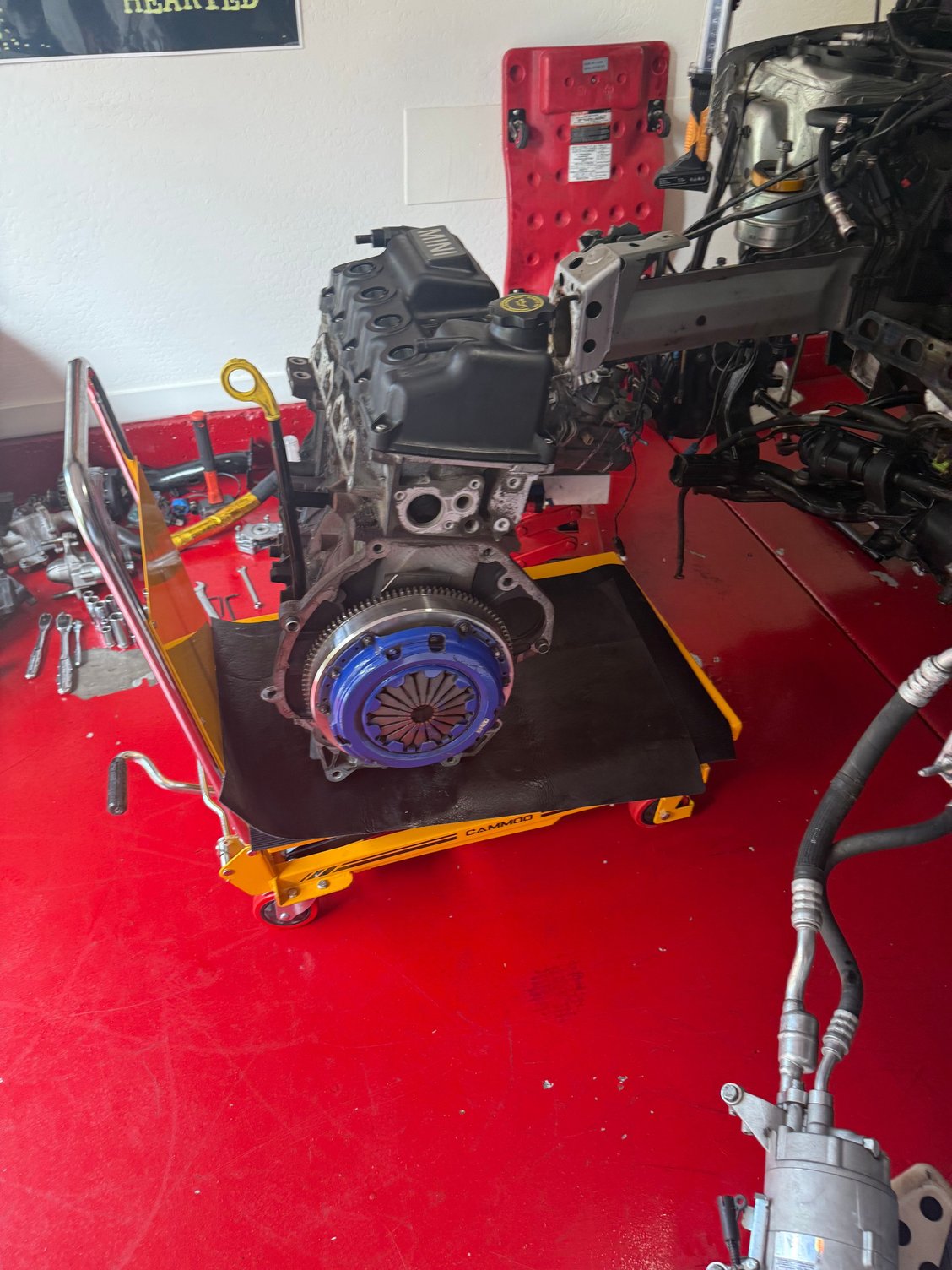

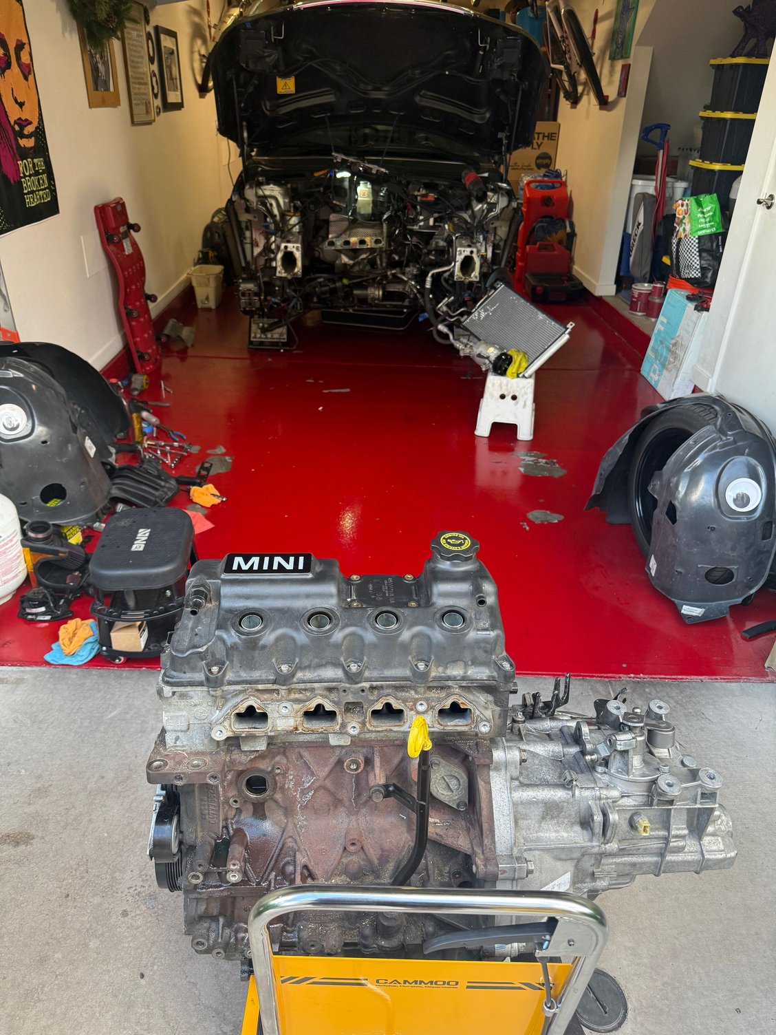

Engine rebuild
Decided to rebuild my engine with ~160K miles on the clock. Everything was running fine, but the compression was low (even, but low) across all cylinders (it was about ~135, which is well below spec). Honed the cylinder walls, new bearings, new seals, new gaskets, new pistons, rings and rods, new/refurbished head. Still have to break it all in, but the first couple short drives seem good. Will be installing a "street fighter" Cat Cam in mid-September, and then we'll really see. Never thought I could do a job like this myself, but it wasn't that bad.

man looking fantastic
how long is the break-in period?

Thanks man. Opinions seem to vary on the break-in period. I'm changing the first oil and filter after just 50 miles, and then will use Amsoil break-in oil for 500 miles, and will then do another oil and filter change 1000 miles after that. All varied driving but nothing too high-revving or sustained for long periods (like driving on the highway for five hours at a consistent 4500 rpm).

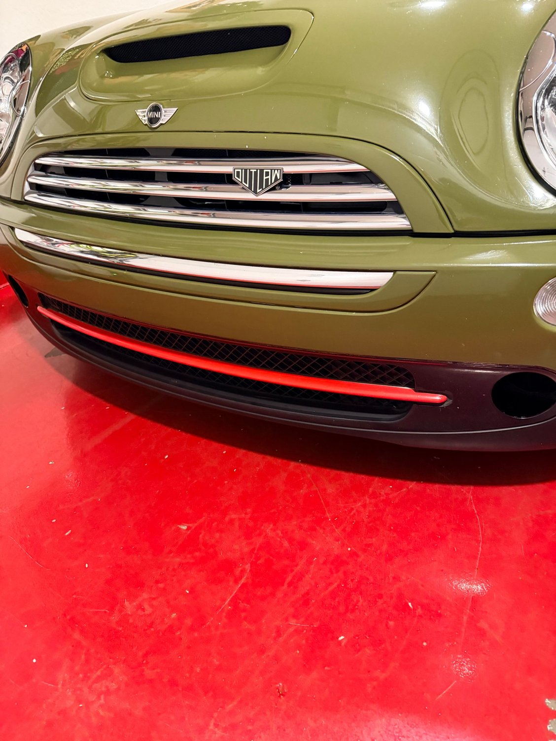

Installed brand new headlights over the weekend and got the hood fitment sorted out a bit better. The hood doesn't fit the headlights properly, so I had to do some drilling to the mounting points and fabricate a bracket that would hold them securely. Removed the blackout tape on the beltline. Car's looking pretty good, IMO.
Killer looking R50 & nice mods . Are the new Xenon headlights OEM or aftermarket & did you have to replace the E- brake cables to fit the R56 trailing arms?

Thanks! The new headlights are OEM (Hella) and they weren't cheap! But the originals lasted almost 20 years, and there are all kinds of new products on the market nowadays that prevent yellowing, so I decided to make the investment. It was a bummer to have to replace them; the driver's side was fine, but the passenger side developed a "lazy eye" as one of the adjustment screw brackets broke and would no longer hold the DRL in place. I have no idea how long it had been that way, but my wife mentioned it to me after I followed her to take her car in for servicing one day. Didn't have to replace the e-brake cables, no. The only difference is to the lower shock mounting point, but most vendors that sell these arms include the required bushing (it's just a machined, press-fit piece of aluminum). I highly recommend upgrading the trailing arms; saves a bunch of weight, looks better, and they don't rust. One word of warning: because the arms are aluminum, there are only so many times you can undo and redo the lower shock bolts before they strip. Both of mine did, and I solved this by replacing them with 80mm titanium bolts that I just forced into the arms to create new threads where the old ones ended (and used anti-seize compound). About ten threads stick out on the wheel side, but they're nice and secure.

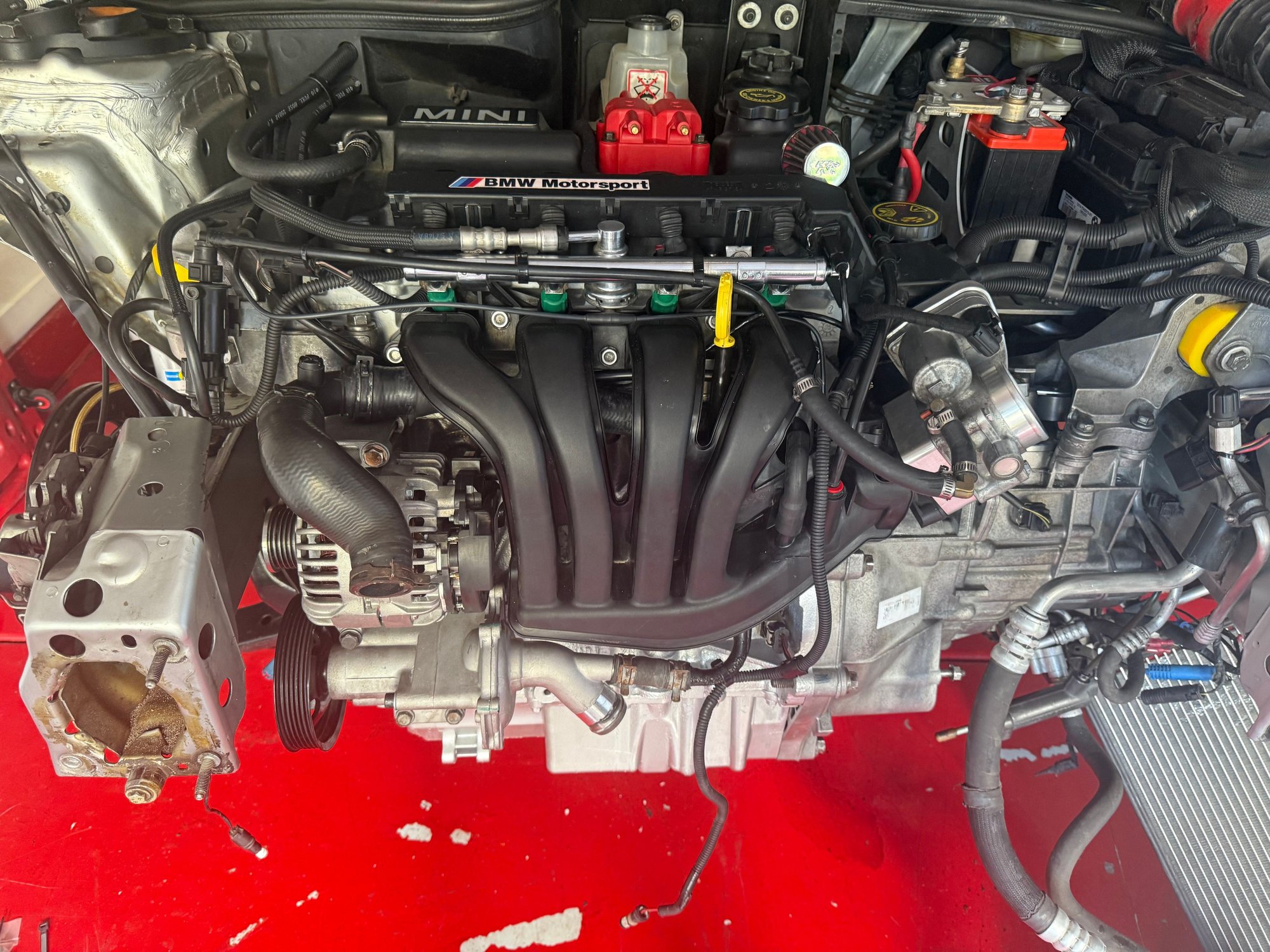

Did a bit of work on the car over the last couple of days.
1. With my recent engine rebuild and tune from Adrian the car revs higher and, it turns out, the stock radiator cap on a R50 is a LIMFAC (limiting factor). Whenever I'd do pulls over 6K rpm there would be coolant all over the place because the stock cap couldn't take the pressure, so I found a higher-pressure cap made by Mishimoto and this solved the problem.
2. The next issue I solved is oil cooling. I always knew the internals of the R53 and R50 engine are different (I installed R53 exhaust valves as part of my rebuild) but I never knew that R53s came from the factory with an oil cooler but R50s didn't, so I installed an external oil cooler. With the rebuild and tune I'm regularly pushing the car above 6K now that it's broken in, so I want some extra insurance. Plus, I sometimes use the car for road trips between Phoenix and LA, where traffic often moves at 80-90 mph in 100F (45C) heat. The cooler itself is a 10-row, again from Mishimoto, and the thermostat, AN10 hoses and fittings are by Hel. I fit the cooler just above the air conditioning condenser, routed the hoses underneath, and the thermostat sits just beside the crank pulley. I wanted the thermostat as far away from the exhaust manifold as possible so it's sensing oil temperature and not exhaust temperature (I've seen some over-the-top installations where the thermostat is sitting close to the exhaust manifold). The cooler's fittings make contact with the underside of the (carbon fiber) hood just a little bit, but the hood still closes normally.
3. With the oil cooler installation came an oil change. This is my third oil change since rebuilding the engine ~3K miles ago. I am using Redline 5w30 this time, but am not sure if this is better or worse than the Amsoil 5w30 I've been using. I've read that Redline is "racier" and can unlock a bit of extra horsepower and fuel economy, but we'll see. I'd appreciate feedback from anyone who has first-hand experience using the two.
4. While I had the front end off, I also installed a 9" SPAL puller fan behind and inside the crash bar. I had to cut out a portion of the crash bar to fit the fan, and it is bolted to the front inside of the crash bar. I used a Hella auxiliary light switch kit with an inline fuse to activate the fan, and the lighted switch is located in the knee panel below the steering wheel where it's not noticeable unless it's turned on (the light is blue for "cool"). The air conditioning in these cars was not designed for the brutally hot summers we have in Phoenix and anytime I had to sit in traffic for more than a few minutes my AC began to blow cool-ish, not cold. (Last year I installed a new compressor and condenser, so the system is otherwise 100%.) The intent is that when it's super hot out and I'm stuck in slow traffic, I can turn on the fan and it will pull fresh air towards the condenser to help the system keep up. As a bonus, this fan is much quieter than the stock high-speed fan.
5. This one was a "nice to have." I installed a Rennline fire extinguisher mount under the front of the passenger seat. The thing was a pain to install, but it looks cool and now I have an extinguisher where it's readily accessible (my extinguisher was previously behind the passenger seat and was ineffectively held in place with Velcro).
6. Last, I replaced the power steering pump. My stock pump failed in March of 2025 after having been replaced by the dealer in 2014 as part of the recall. I bought a Chinese rebuild off of eBay for ~$500 and it only lasted nine months. This time I bought a Cardone unit which seems to be much better quality. Genuine MINI pumps seem to be in low supply. So we'll see. I'm paranoid now. I dropped the subframe to install it, which also made installing the oil cooler much easier as I had to replace my R50 oil filter housing with a R53 housing. (NOTE: Switching from the R50 to R53 oil filter housing requires a M8-1.25 x 80mm bolt; all three of the R50 housing bolts are the same length, but for the R53 housing you'll need a 80mm bolt.)
HOPEFULLY this is the last major work I'll have to do on the car for a while. Everything is sorted and the car runs and drives like a dream.
