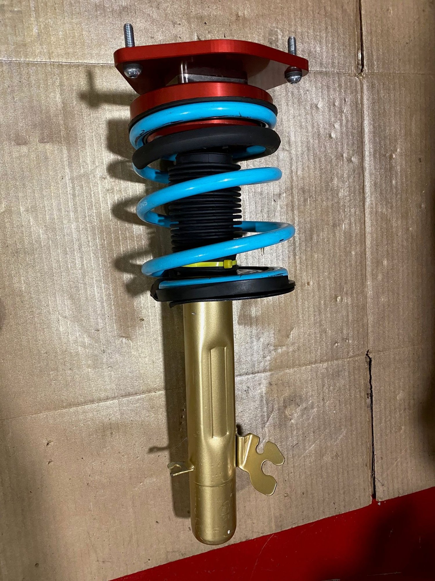

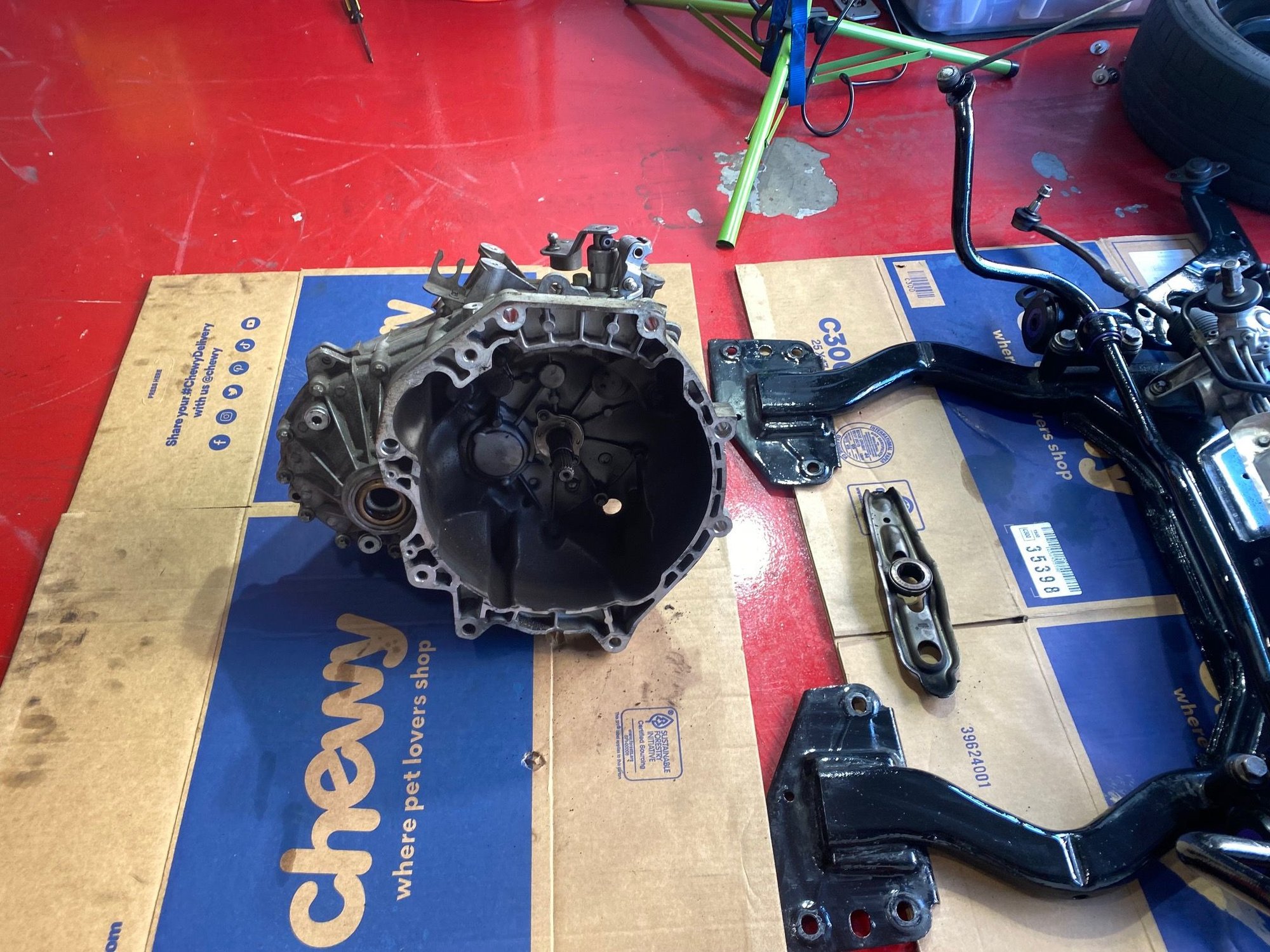

Just completed a fair amount of work on the car. Clutch had been making a squeaking noise when I pressed the pedal in. I got my wife to press the pedal when I had the car on the lift and it seemed to be coming from the slave cylinder, so I replaced it. It wasn't the slave cylinder, so, I knew it was time to go "inside." I got a great deal on a Spec Stage 1 clutch a couple of years ago and it had been sitting on the just shelf waiting. I also picked up a forged chromoly flywheel. After watching how-to videos over and over, I felt confident enough to tackle the job. It turned out that the clutch throwout bearing was completely shot, and the pressure plate had definitely seen better days. While the subframe was out I decided to do a bunch of other work. I replaced the bump stops and boots on my front shocks and got them all cleaned up and looking like new (I got the Powerflex kit with yellow bump stops, which I had to trim an inch off of to accommodate my lowered suspension). Cleaned the whole engine bay and removed rust from all the bolts I could find. Replaced the center tunnel heat shield. Sprayed Boom Mat on the floor pans and put Kilmat in the wheel wells to dampen road noise. Generally just refreshed and restored everything I had access to. I also replaced the fuel pump and installed a new battery (Odyssey PC680) as start-related precautions... and I checked and adjusted the camber and toe. When I was replacing the subframe I noticed a bit of play in the control arms. Turns out the nuts that secure the control arms to the lower ball joints were BOTH loose, so I got those tightened back up. But when I got the car all back together, it wouldn't start! Turned out the starter solenoid had gone bad, so I got that fixed. I am covered with bruises and my wife was pretty pissed off with me for a couple of days, but the car's running better than ever.
While I'm still breaking in the new clutch, what I can report is this. When I'm approaching my house there's a one-block stretch next to a vacant lot never has any traffic on it. When I give the car the beans, I can get it up to about 50mph. Yesterday I reached 50 in about half the distance it normally takes, so, yes, based on that I would say that the car definitely accelerates faster. And while it was only a small amount of play in the suspension, the car feels tighter than ever. What a difference!
Here are some pics in no particular order.

Hey, I'm running Koni FSDs with Godspeed Traction S springs (lower by 1"). The springs are nice and plush. The FSDs can be lowered 1" and still work properly, but not more than 1" as that would mess with the dual-valve action. I've got Vorschlag camber plates on the front and Hotchkis adjustable arms on the rear; Powerflex purple bushings at all the contact points, a WMW rear sway bar and the R56 aluminum trailing arms. It's really comfortable (well, for a MINI), and corners flat as a pancake.

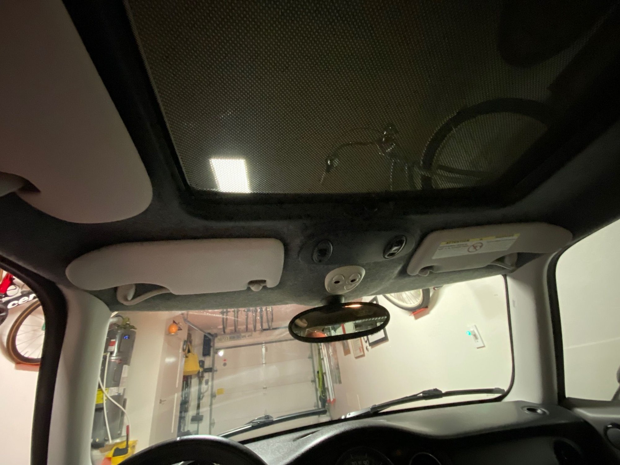

Just replaced the headliner. This is the second time I've done it in the last ~5 years; I wasn't happy with my first attempt. What prompted me to do this (besides not being 100% happy with the headliner) was a noise I've been getting from behind the dome light. It's like a stuck-stuck kind of noise when I go over some surfaces, as if two very clean pieces of plastic are rubbing together. So I ripped everything out, put some 1mm sound deadening on the roof side, and used grey felt instead of foam-backed headliner fabric. The felt looks really nice, it's very tough, and I will never have to contend with headliner foam getting old and crusty. Actually, the only crusty foam on this job was in the headliner support itself. It turns out that there is a foam layer between the roof-facing cardboard side and the cabin-facing fiber-board side. When I went to peel off the old headliner, the two layers of the headliner support came apart in places and it was difficult to get them stuck back together. I ultimately used a silicone adhesive and left it overnight to cure, but the support felt a bit soggy in places and had lost some of its rigidity. But it all went back together nicely and hopefully I will never have to touch it again as long as I own the car (which will be until I die). Here are some photos. It's difficult to capture how it looks installed with the lighting I had, but the photo of the alarm cover should give you an idea how nice the felt looks. But the stuck-stuck noise from behind the dome light is still there! I'm guessing it's something to do with the rear sunroof panel seals. I shot some PB Blaster all around the sunroof panels, and we'll see if that makes a difference after it's soaked in overnight. I am NOT removing the headliner again!

Man I like the way that looks! I painted the headliner in my slick top R50. Came out great but stunk terrible for some time. I used black felt on my wife's land rover and love how that came out. Thats been in there for 10+ years and held up great. But I like the way that gray felt looks a lot
