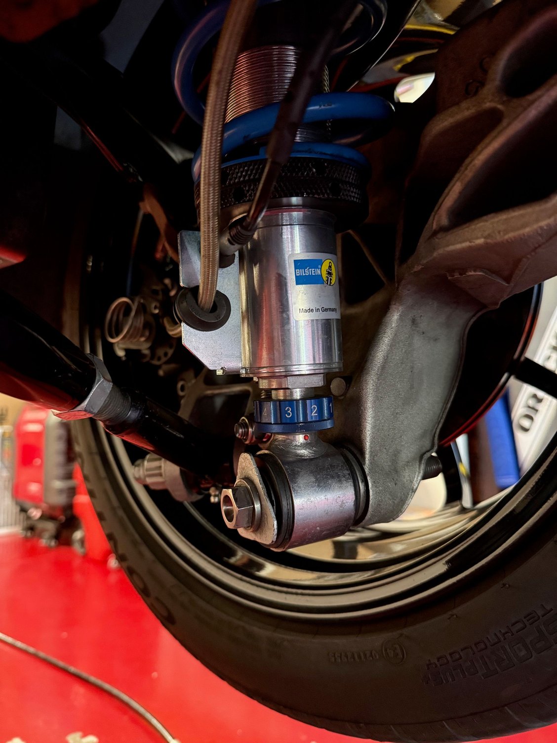

Did a bit of work this weekend. I've been going between Phoenix and LA a lot and the car droned like hell cruising at ~85 mph/4K rpm. I've got the Borla cat-back bolted to the Milltek 4-2-1 headers. On YouTube I saw a video about a baffle system from a company called Car Chemistry. Intended to be a substitute for mufflers on hot rods where there's no room for a muffler, or a muffler would look ugly, this baffle slips inside the exhaust and is basically a perforated tube held in place with three perforated discs. It works. I pulled the exhaust and inserted the baffle after the resonator but before the muffler, and if I want to remove it, all I have to do is undo a clamp. I cleaned everything up and re-wrapped the exhaust while it was out of the car.
I also replaced the rear subframe. The original subframe was 20 years old and very corroded from Canadian winters earlier in its life. While I had everything out I sanded and repainted the upper control arms (stock), readjusted my rear camber, and applied soundproofing in areas that were previously inaccessible.
And lastly, I installed the M7 under strut system. After years of pulling into a driveway with a rolled curb, I think my car's torsional rigidity has taken a bit of a hit (my sunroof has been making an odd creaking noise, and I think it's related). We'll see. Installation went smoothly except for installation of two M10 rivet nuts. The M7 instructions say to place a washer over the nut, so there will be a washer between the body of the car and the lip of the nut, but this prevents the nut from biting into the body. After wrecking two nuts attempting installation with the tool M7 provides, I bought a nut installer off Amazon for $40 (the "hedge trimmer" style) and, without the washers, the nuts installed smoothly and are holding nice and tight.
Oh, and I changed the oil.
Some random shots below.
That's all for now. 😄

This is how the car sits on the new coilovers. I think it looks pretty good. No rubbing, but I did have to remove the rear 10mm wheel spacers. I kept the front 10mm spacers and, surprisingly, the front and rear track widths are now identical.
