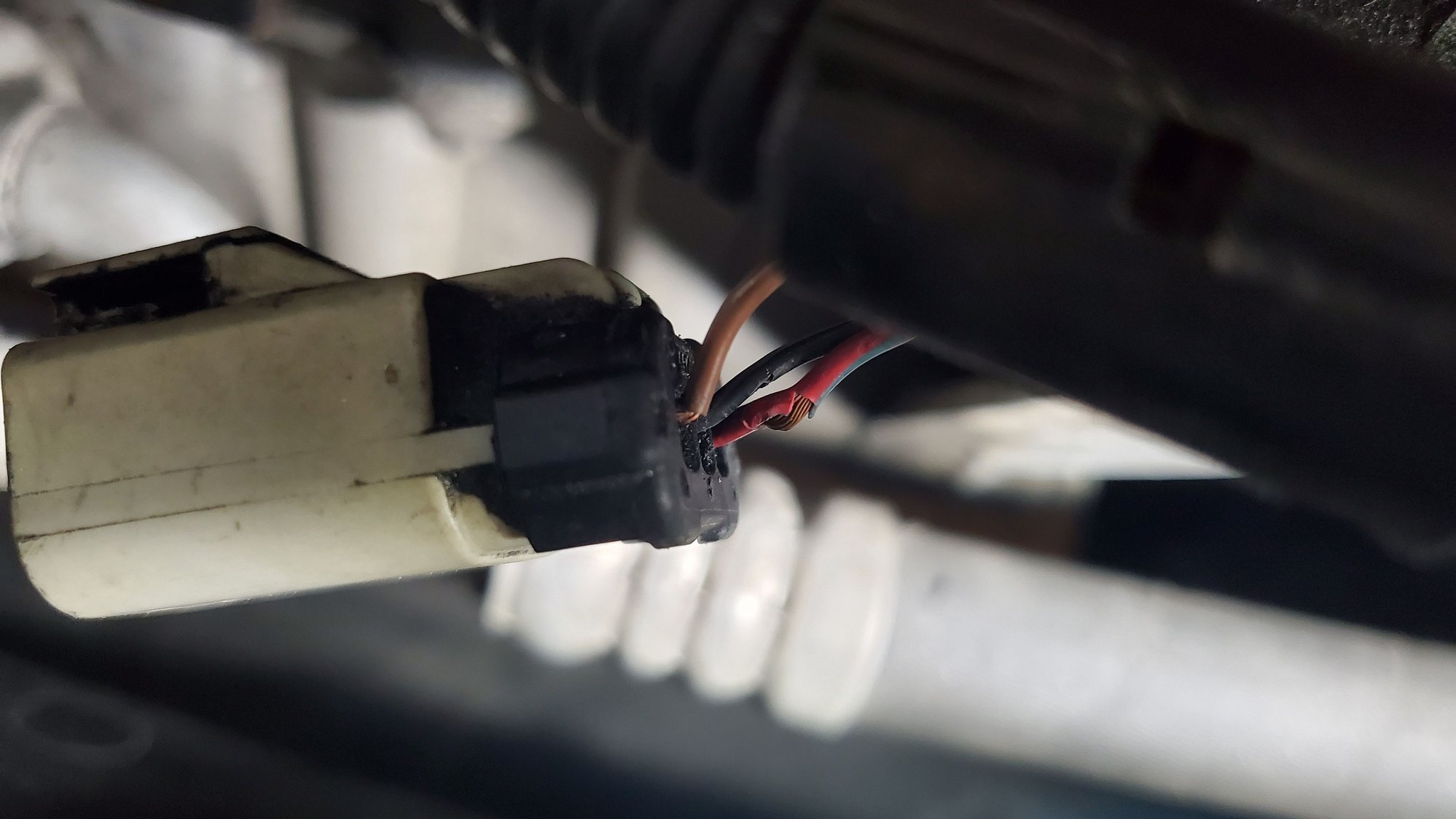

leads me to believe the ebay crank sensor i put in when i did my Sprintex install is failing already.. i cracked the old one during install and threw in an ebay one as money was tight.

GOD I hope this is the cause of my issue..I will order a new harness now too and replace this also....
sure would be nice to not have to use ANY of the new sensors I'd ordered though I might as well just keep them and have them as spares. I cheaped out buying the sensors because I needed so many and they were all shots in the dark OR I would have gone oem.. atleast what sensors I have in now , if still good ARE oem so if I don't have to replace them I'm not going to.
but I think I'm going to start with replacing the harness , then the sensor and move my way on up the engine then...

Id already ordered the harness with sensor which shoooooould be coming tomorrow. I appreciate the offer though..
I put liquid electrical tape over the exposed wires but no change..

Lol my valvecover was cracked underneath under the coilpack so I put on my carbonfiber dipped one finally. That Crack would explain my little oil leak on the rear of my head I'd seen that I assumed was the gasket. Also half the bolt grommets were bad ..
I'm so frustrated i actually shed a few tears after i put on this valvecover because it looks sooooo nice and my car was finally figured out ect..this is just so disheartening.
when it rains , it POURS !... UGH......
