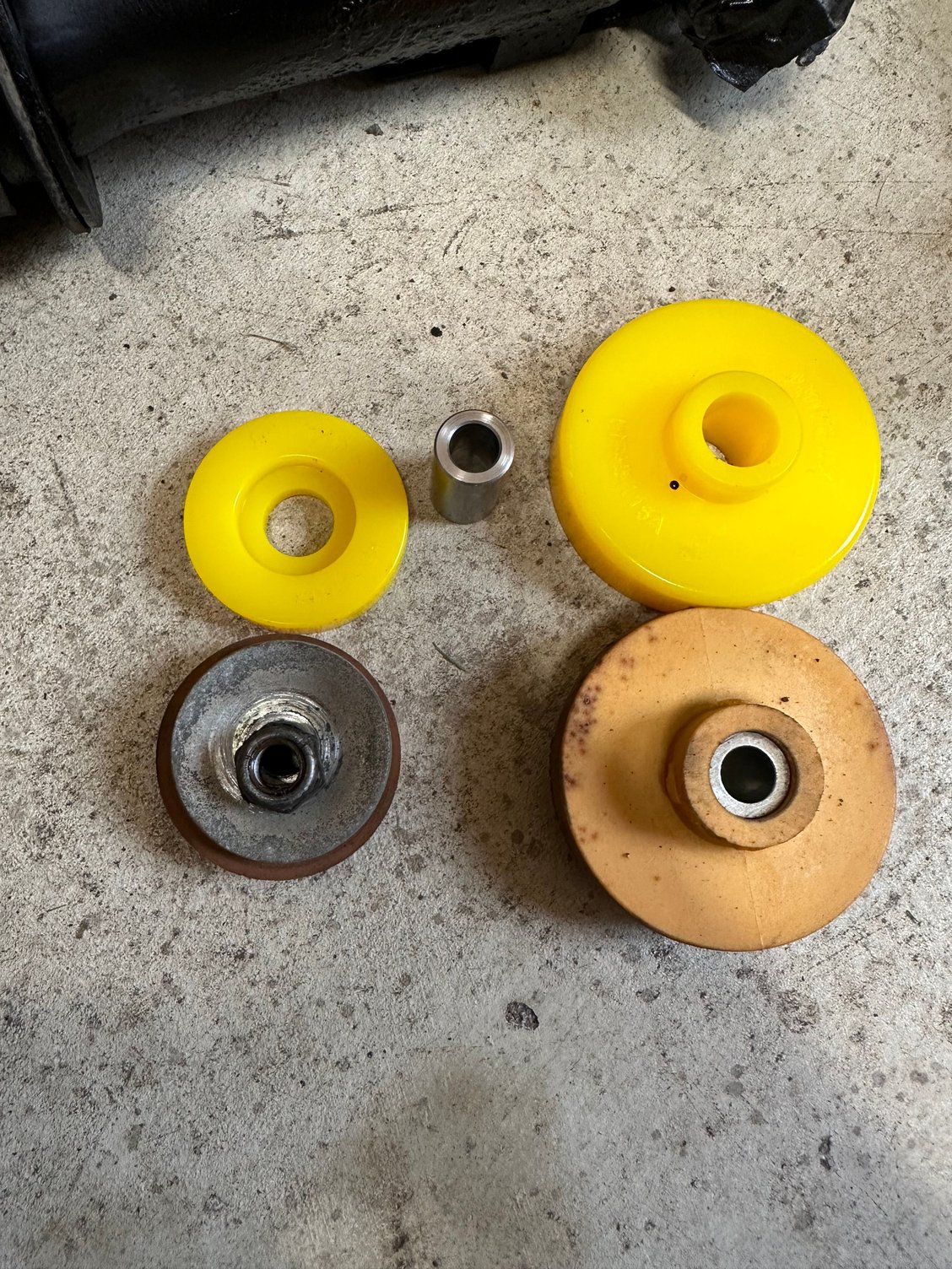

New strut mounts and Indurators

Mount comparison
Not 100% sure, but these may be original. BMW is showing on there. If they are, not bad for 1/4 of a million miles.

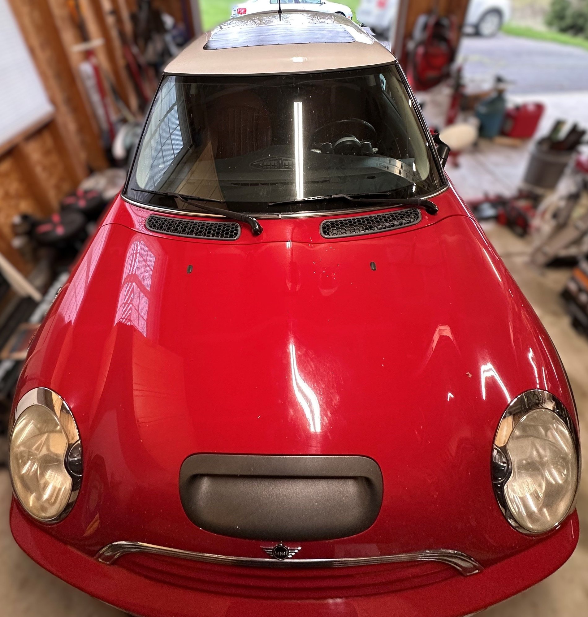

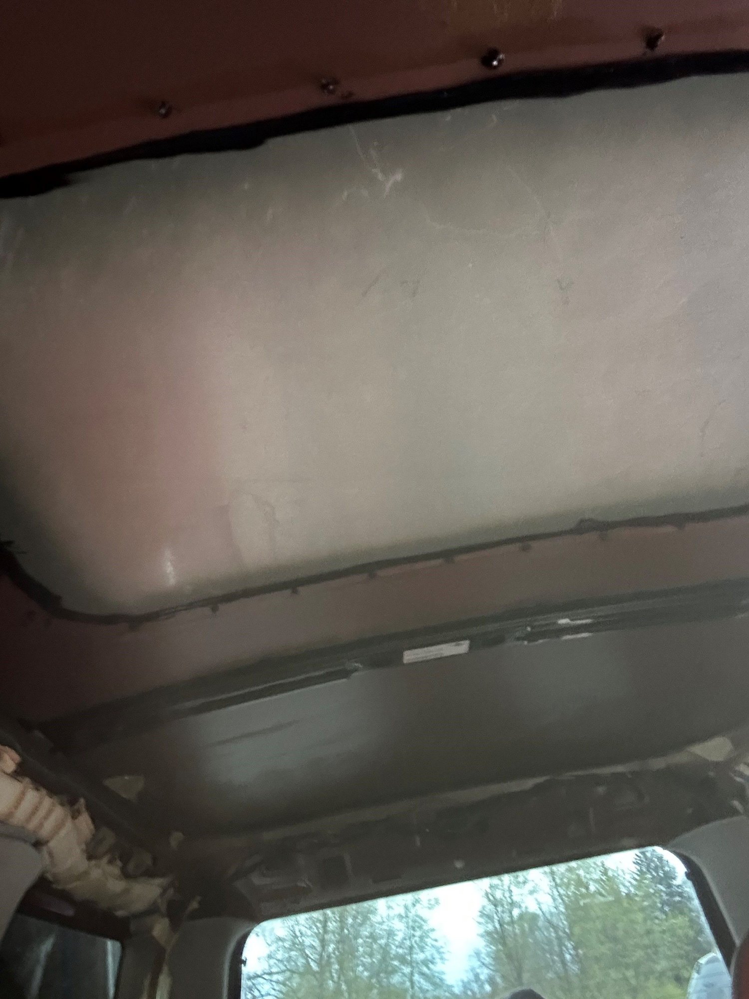

Sunroof Delete
Got a sunroof delete panel from LRB Speed to delete the inoperative Webasto unit. These were essentially installed by the dealer as an option. It would even be shown on the window sticker. However, since these were available with sunroofs anyways, I am not sure why they would decide to do that.
Delete panel was relatively straight forward to install. Most of the time was spent to paint and mock. Luckily, I was able to source a new roof bow from Mini for about $35
Webasto unit
Missing roof bow
Delete panel and new bow

Delete Panel Exterior View
Car is very dirty in this image due to winter storage but I will try getting a better image after cleaning it up. The panel is the same color as the scoop. Clear is still not completely cured yet so too early to cut/sand.

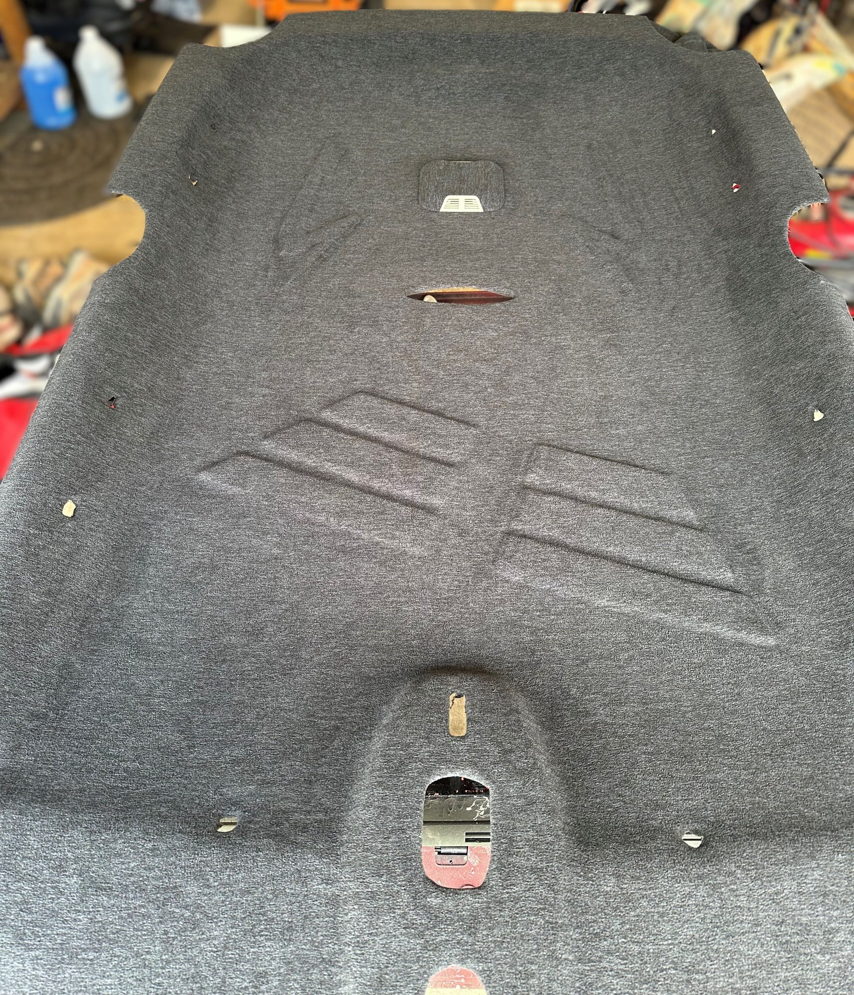

Headliner
Also obtained a new headliner and re-covered it. Raised graphics are from 1/4 inch foam and material is a gray/gunmetal microfiber, meant to somewhat match the exterior details. Cost $24 for all from Michaels. I will grab another image once I finish installing it.

Headliner
Here is the headliner after installation. This car didn't have front visors/grab handles before due to the AM sunroof, so I mistakenly cut the holes. I just have to figure out something to put there now.

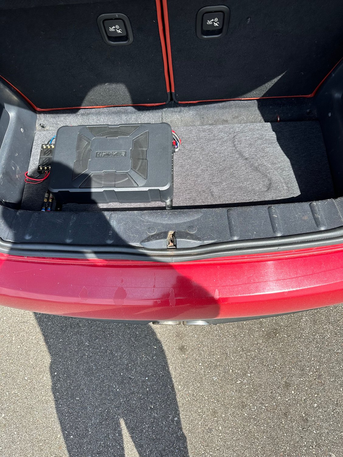

Audio
Here is some additional audio related stuff. This is a hideaway 8 inch sub. The mount is a pine board from Lowes ($6) that I covered with the same fabric as the headliner. The board fit without modification, I just sanded all the edges.
I also wanted this to be plug and play/completely removable. Whole thing can come out in less than a minute with no tools. It can stow behind the front seats as well.

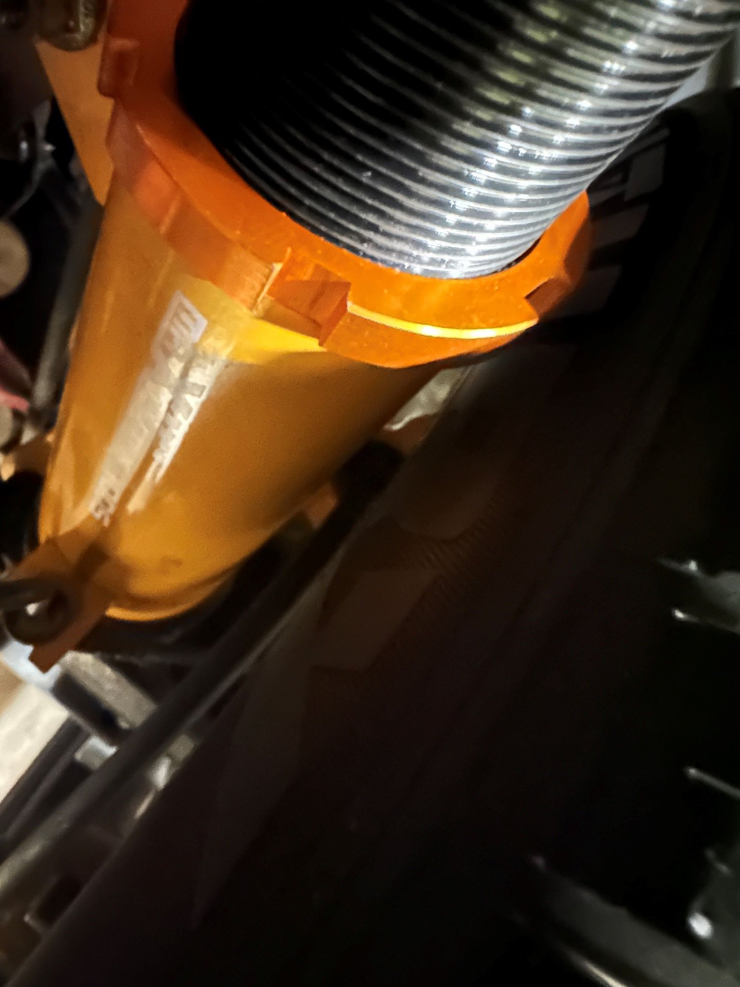

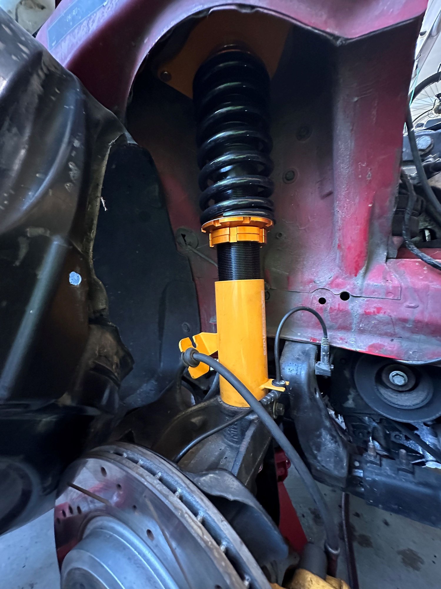

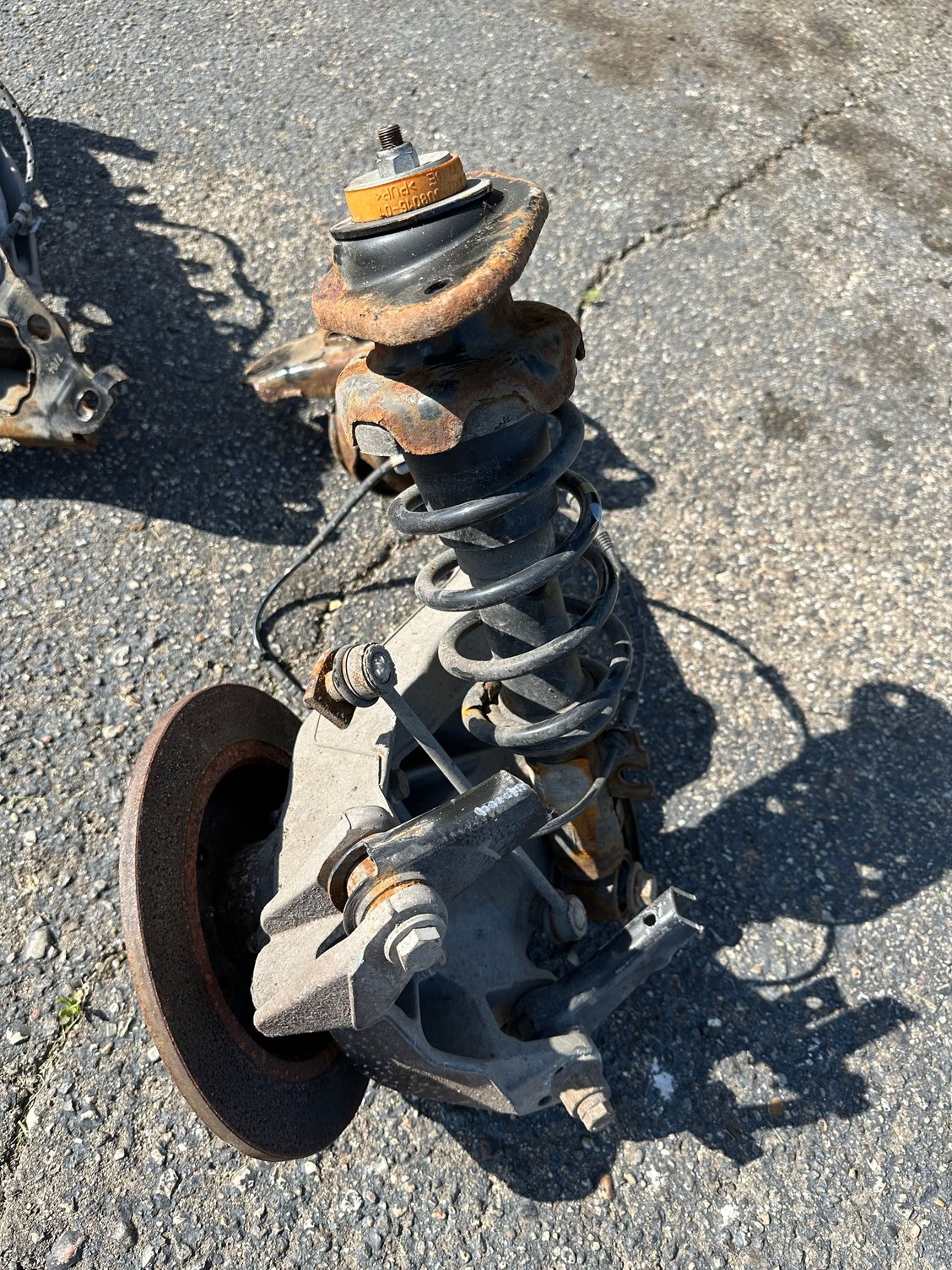

Some new updates. Installed a new set of Maxpeeding Rod coilovers to replace the Racelands the car came with. They were not leaking but they were pretty beat up. I also think the RF may have had an issue because the mount on that side only lasted about 1500 miles. Install was pretty straight forward but I will say that in my case I had 2 issues
  1. The bottom of the coilover was loose in the knuckle when fully tightened
  2. The brake line bracket required modification to not hit the wheel. This involved cutting and bending.
Overall, they seem to ride a bit better than the Racelands, although I have no idea how old those were.
Racelands
New Coilover
Close to the tire, but dose not touch
What I used as a spacer for the knuckle. Good thing I had a spare since I also just had the head off to replace a valve.
I have had to remove and tighten this nut several times due to a rattle (the marble sound) on the Racelands. My potential fix is here. The lower washer goes over the center bushing so the fit is tighter and it is also curved to keep the bushing from "spilling" out. Time will tell if this works.

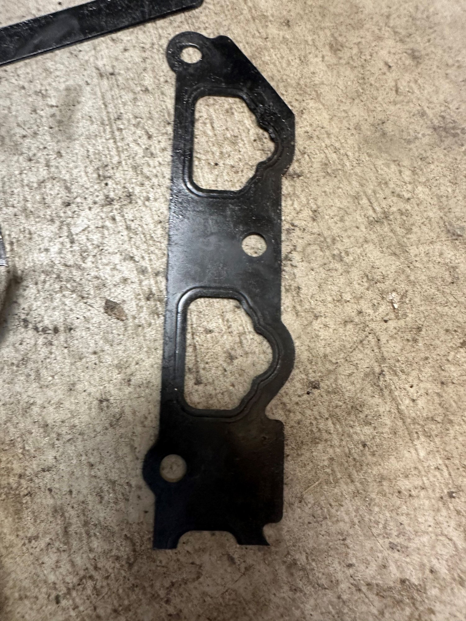

Some additional new items for the Mini. I decided to replace the timing chain, which turned out to be slightly stretched. I also did some "while you're in there" items including:
  • New tensioner
  • Alta tensioner stop
  • New belt
  • Speedmaster damper
  • Idler pulley
  • DDM Intercooler boots
The tensioner was making noise due to looseness and that did resolve the noise. I added the pulley images since not a lot of people seemed to have used this one. It is thinner than the original but the weight is the same. Went on easily and I have had no issues so far. The Super Damper may be superior, I just couldn't justify an extra $240 for it.
I replaced the intercooler boots because one of the originals was starting to tear. Not bad life on the OEM ones at 260k. I originally got the Alta boots but I had issues getting them to seal and they were hell to put on. After researching, many said the DDM ones were the best and I would agree. Had no issues getting them on. They are softer and thinner than the Alta ones and being slightly thinner makes the clamps slide on much easier.
