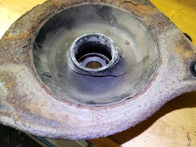

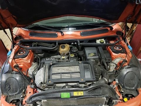

@Rebound , here are some pictures of the strut tower reinforcement plates I installed as part of installing the new struts and upper strut mounts on our car last week. I'm not sure which brand these are, but I bought them used here locally for a reasonable $30 price for the pair. On our Mini (with 162k miles), I did find some minor mushrooming on the LF (driver's) strut tower - I was able to massage it back with a 2x4 and 5lbs. sledgehammer. I'd like to find the strut tower brace that bolts between these plates, too, eventually, just for a little added stiffness and handling benefit.
And here is a picture of how bad our original upper mounts were torn. It's a must-replace item, for sure.
I got this answer in the "What did you do to your Mini today?" thread - it looks to be reinforcement plates from M7, and their strut brace would bolt in there. I'll have to check with them if I can just order the brace, as they only show it with a kit on their site.
