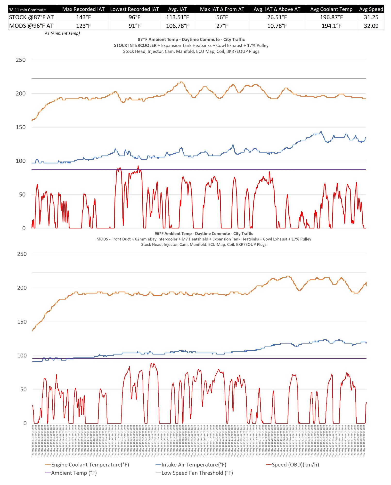

Sorry in advanced if anyone finds some mistakes. I'm just a normal dude who knew nothing about cars before I got my R53. I tried my best to gather data using my OBDLink LX bluetooth dongle and Torque Pro.
Before mods, I have been logging every drive on my daily commute and during more fun driving. So I felt like I had a lot of data to get a sense of what is normal and what is an exception and why. I tried my best to find and compared data that was as similar as possible, however sometimes I couldn't get a perfect 1:1 environment due to seasonal change.
City Driving, Daily Commute, Traffic
These graphs are made from my daily commute home from work. If you look closely, you can see patterns in the speed lines due to it being the same course so to speak. There is obviously some variation in traffic, as you would expect, but it should be similar. This test was most important to me since I was very concerned about IATs just commuting around.
1) STOCK VS MODS NO FMID
2&3) STOCK VS MODS + FMID
4&5)MODS + FMID + IC SPRAYERS
WOT Test.
Conclusion....My Personal Experience So Far.
Again, this is not to be thought of as a meth replacement, since meth would be better overall and more instantaneous for better performance. The goal for my project was mostly centered around thermal management and improving the stock cooling for city driving and avoiding overheating. IAT have big influence on the engine coolant as well, especially with high % Pulley
My setup works well, but it still takes some time to get the IATs back down after a lot of traffic, albeit not very much. The FMID and other mods do a great job slowing down the heatsoaking process and creates more temperature plateaus rather than spikes. I have also notice that my R53 is far less reliant on the low speed radiator to stave off overheating. Driving for 30 secs at speeds as low as 30 mph are enough to curb the IATs and coolant temps, making things alot cooler in stop and go traffic. The IC sprayers just further enhance the effects, however it's nice to know that it will still function well if I were to run out of fluid.
I'm happy that I could share this information with anyone who may find it useful
