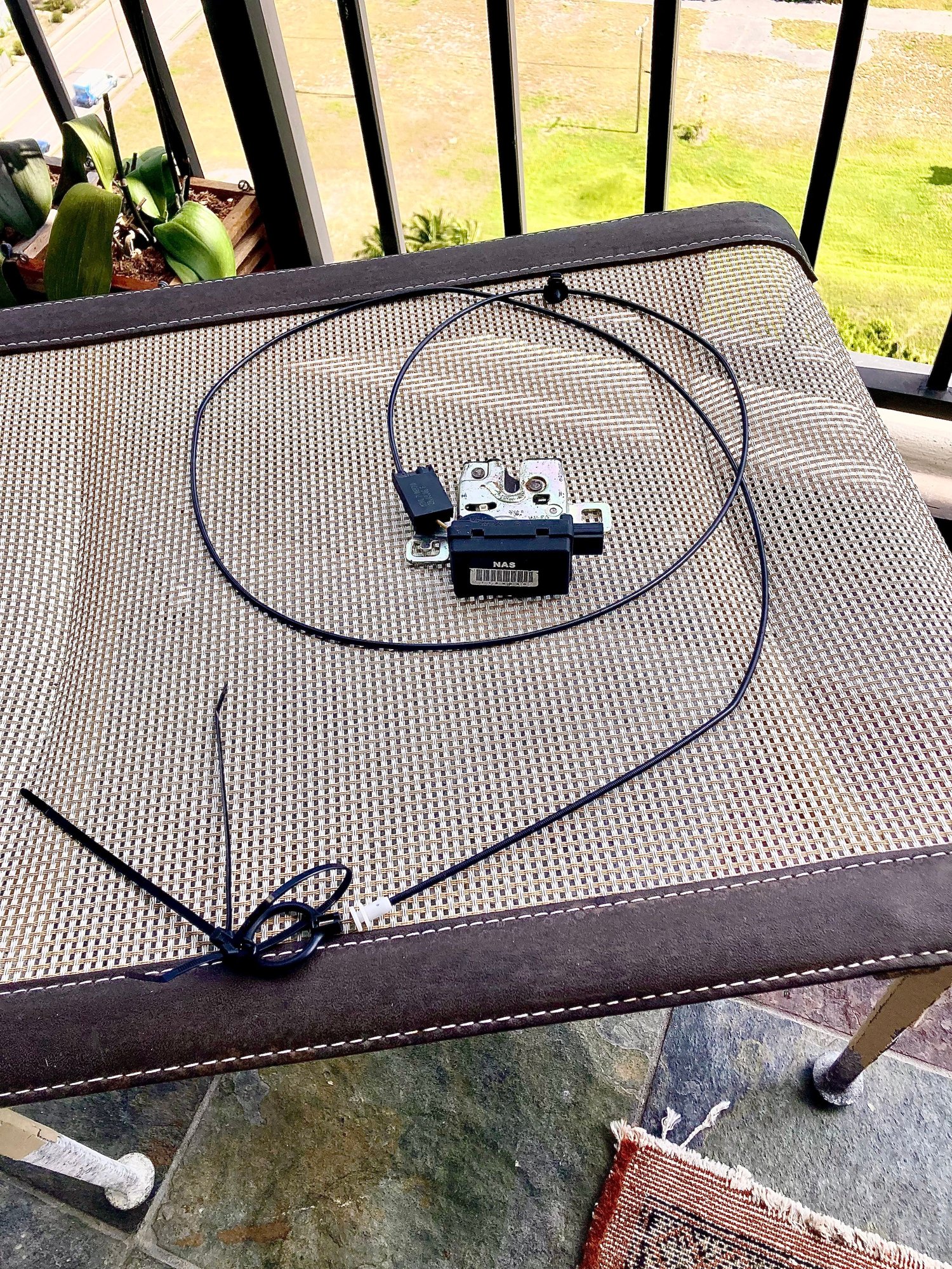

The pre-owned latch assembly arrived today (Thank you Dan). The long cable looks to be intimidating! I will know more soon. I am learning.....
Best,
Monkey Juice.
ps this will be the first used part ever attached to my little monster.
