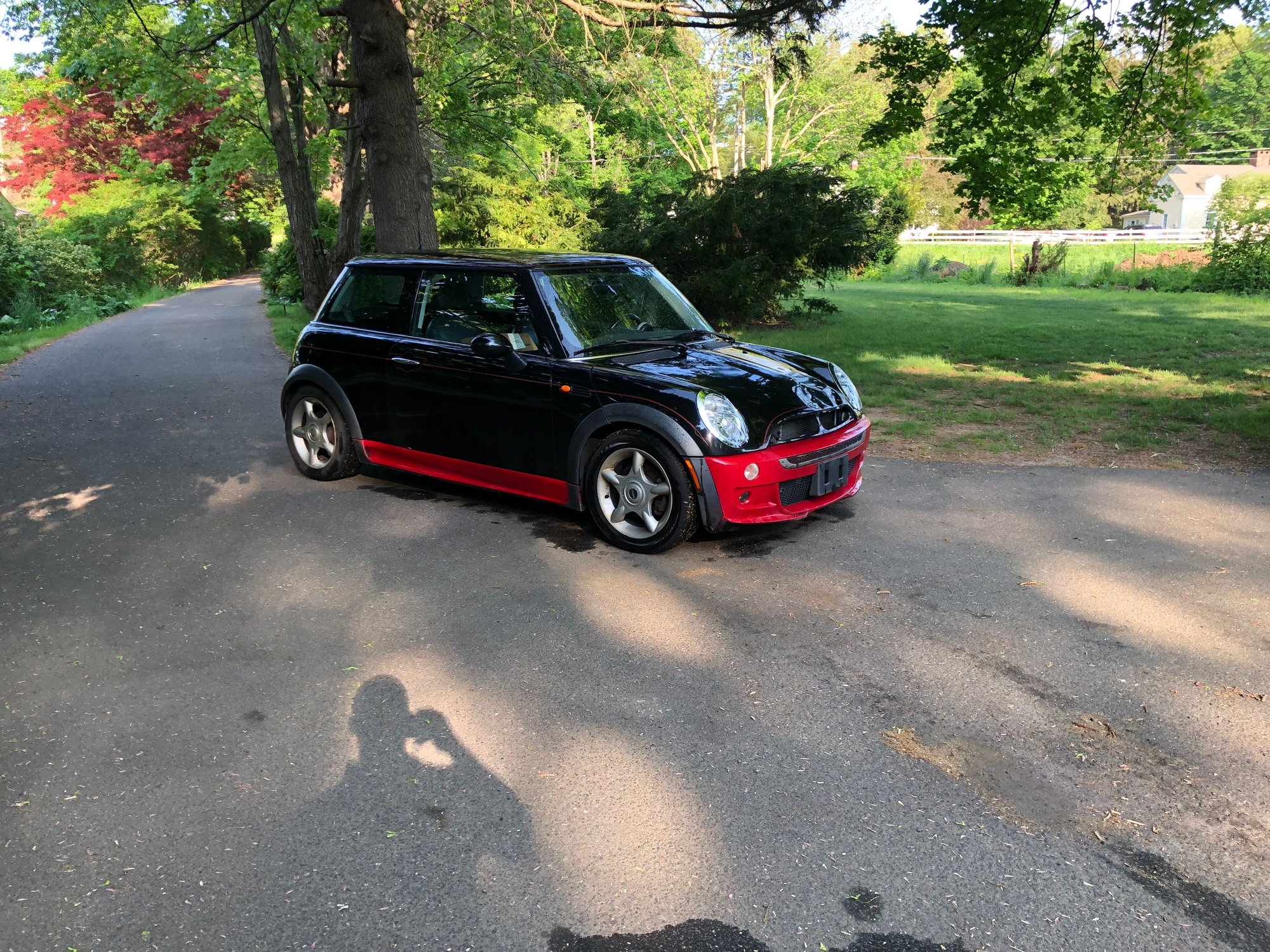

I was supposed to be swapping the 6-speed into my 2003 R50 but had not slept whatsoever the night before and postponed. The next day a friend that flips cars randomly calls me and asks if I want any parts from an R50 he has, so naturally I ask for more info. Long story short it was a 2002 with 116K miles on it and a bad midlands in it. The guy that was going to be fixing it started removing parts and gave up, so I ended up buying it for $750 instead of just taking the motor and various other parts for $400.
I will try to attach a photo but it is a 2002 Chili Pepper Red R50 with 116k miles. minimal options compared to my 2003 but the body and paint are in much better condition other than a mismatch fender. The driver's side steering was all replaced due to a deer strike I was told. The engine ran super smooth and no oil leaking anywhere which was a surprise.

After that I'll likely take the "bad" midlands from the 2002 and put it in the 2003, as the guy described what was wrong with it, and during my tests I did not find anything wrong, I think it was their mess up when they screwed with the linkage. I may or may not take the aero kit from the 2003 and put it on the 2002 as well. and finally sell the 2003 :(
2002 R50
2003 R50
