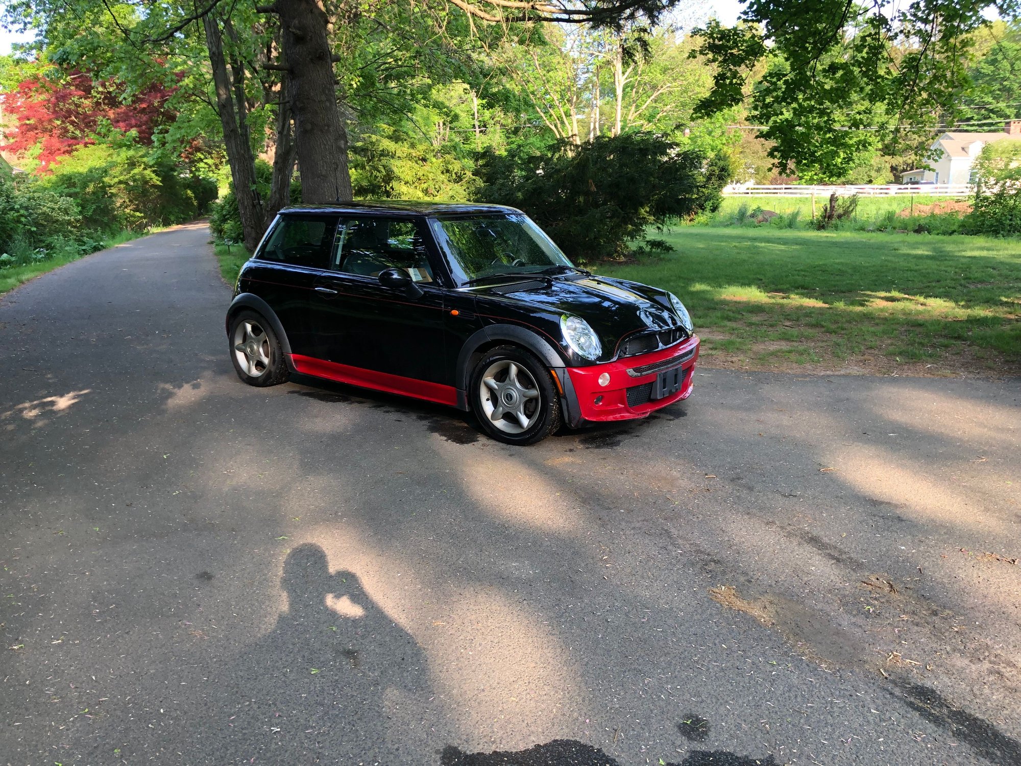

I’ve loved these cars for years and just never bit the bullet. I first drove a mini at a Saab proving grounds event where I drove the justa and S. Loved them both but liked the justa and the way it was smooth at the time . Anyway, I have driven many cars and been very fortunate with good friends but always wanted a mini.
My best friend convinced me to buy a car for autocross so I started looking and within 24hours I purchased this:
2003 R50 with sport package, aero kit, cold weather, and premium.
I am the third owner with complete service records since new. It got a new transmission at 32,000miles….. it now has 247,000.
motor runs strong, transmission shifts as it should, though the throw out bearing or something else makes a ton of noise while clutch is engaged and rolling….
list of things wrong,
passenger window didn’t work- cable was broken, fixed now
air conditioner did not work, changed coil, it worked for 10seconds, ordered new clutch, going to replace. If needed, new compressor
cooling fan low speed did not work- replaced resistor, still did not work, finally worked when I had the ac compressor working, but only for the same 10 seconds… will report back when ac is working right.
PS pump fan replaced, old one seized
various bulbs changed,
front brakes pads changed
new serpentine tensioner And belt
new timing tensioner installed
new crank position sensor seal
air box pipe from throttle body deteriorated, I installed an intake for the time being
Front bumper has cracks from age and hitting deer back in December(previous owner)
front of hood also has dents as of said deer sat on it…. Replacement hood being prepped for paint soon
factory exhaust tip installed
passenger speaker replaced
third Brake light replaced
rear wiper washer was clogged, replaced wiper arm and cleared washer.
engine oil and filter changed, fuel filter, cabin filter
headliner needs to be replaced
replaced two floor mats
I have new rear struts to install as well as poly front bushings
I have collected most of the parts I need for the 6speed swap already, so hopefully this winter that will be my project as well as acquiring a spare engine.
There will be many things I’ve forgotten but I’ll try and add things as I go
the plan for the car was to use it for autox only but I enjoy driving it so much I have been commuting with it as much as I can as long as the transmission holds up
