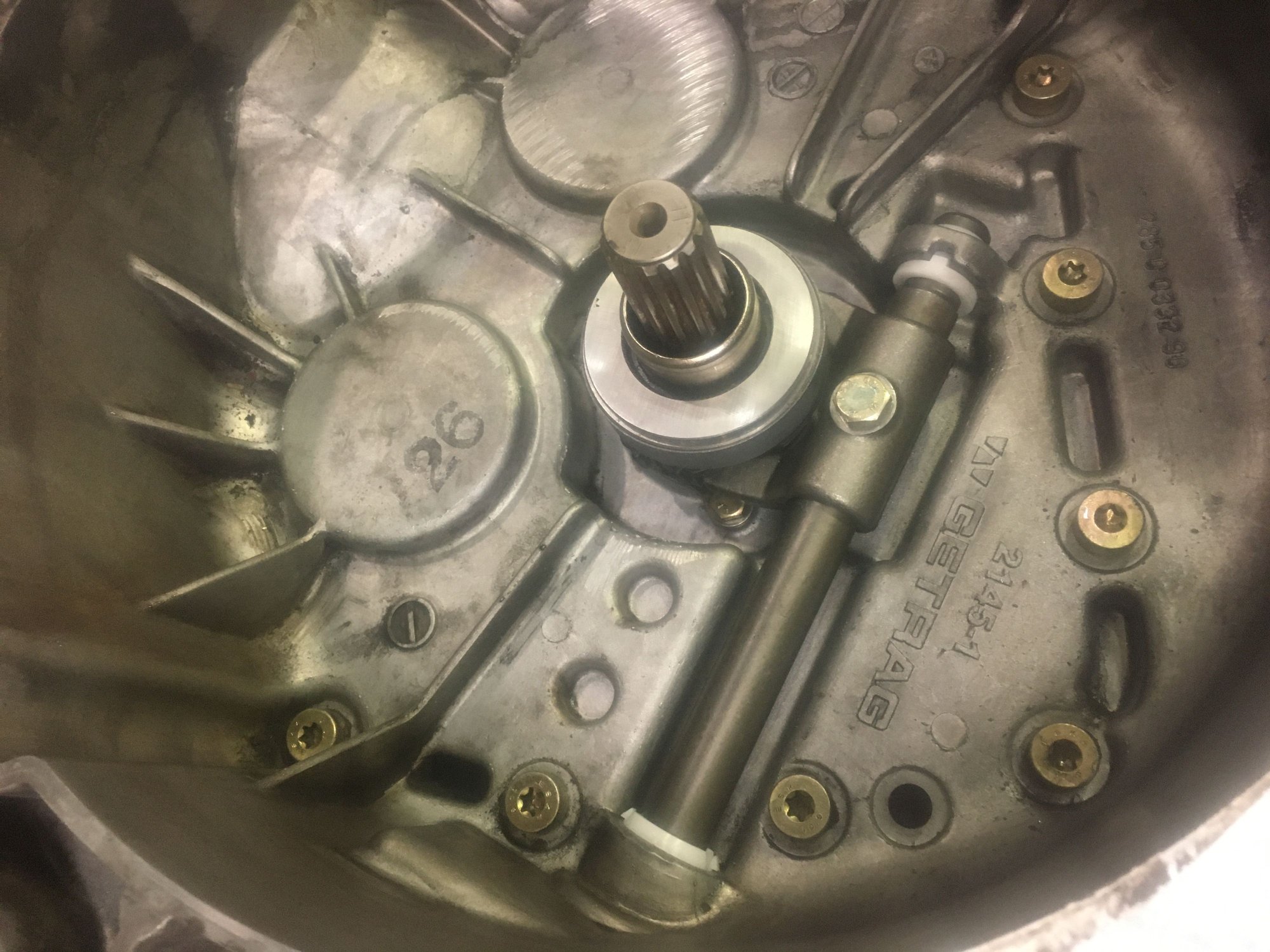

Next, I put the transmission on a cart so I could clean whatever fluid has been leaking in the bellhousing (oil from rear main seal or gearbox oil from the transmission input shaft seal) and then replace the input shaft seal, the shift arm bushings, the throwout bearing guide tube and the throwout bearing.
I could gave cleaned it better that that's all I cared to do.
