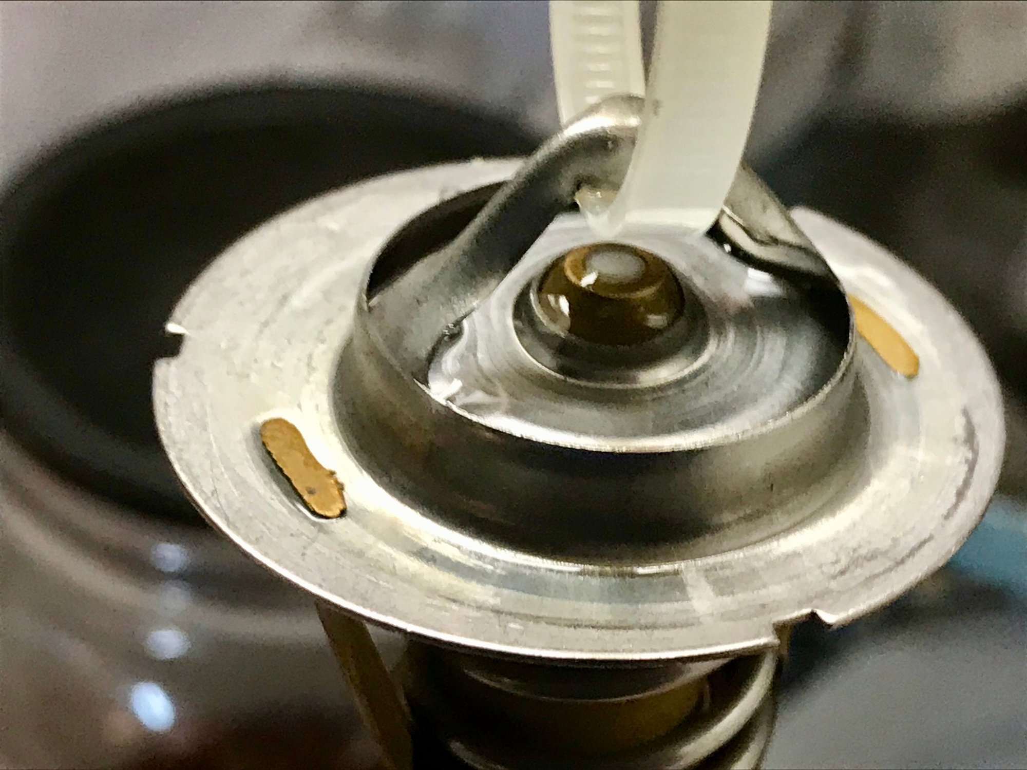

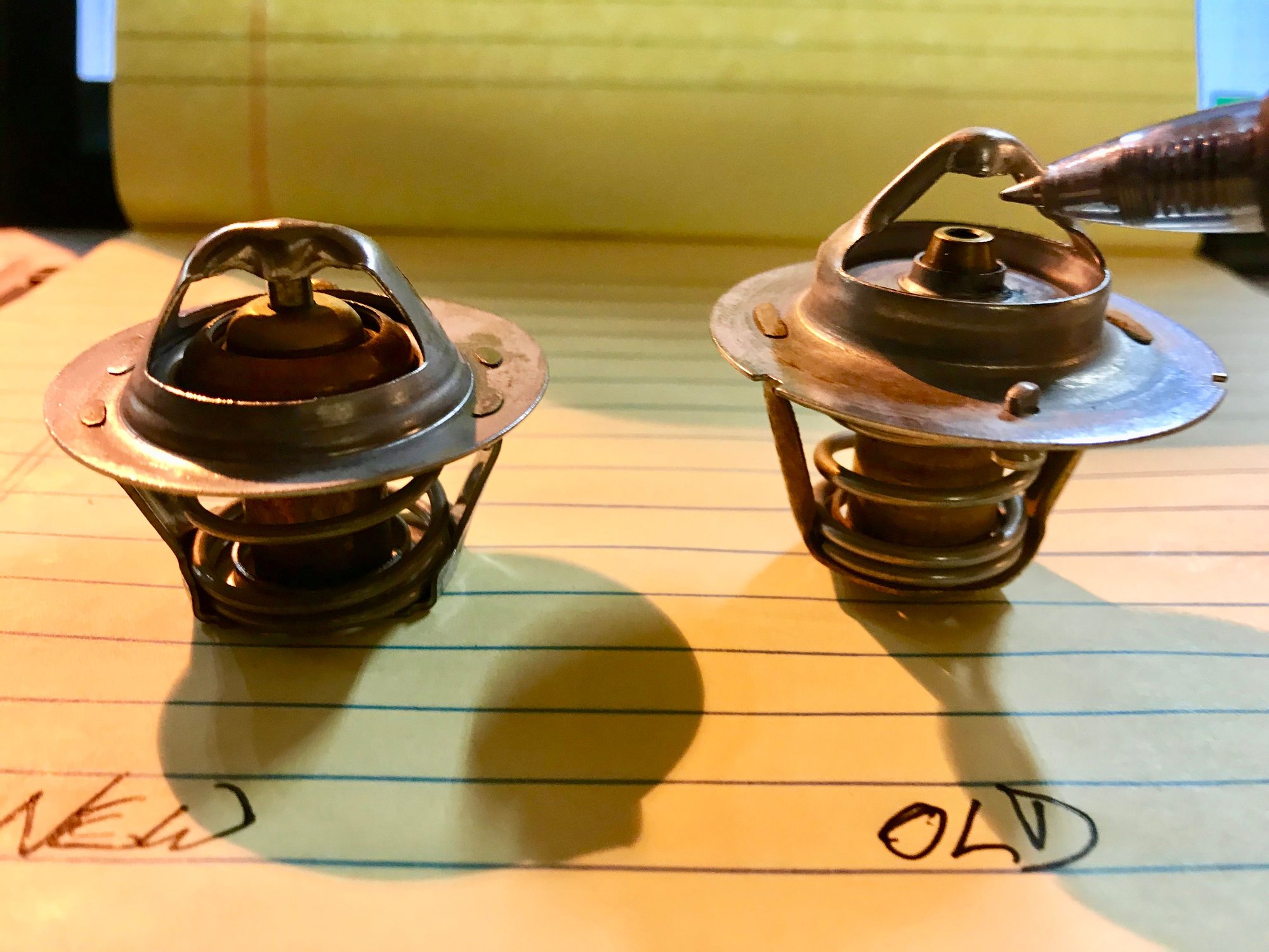

I took the thermostat out and it was installed correctly.
On close examination the top of the post was missing and there was just what looked like a piece of nylon remaining, so I have to assume the entire post was nylon.
The new thermostat has what looks like a brass shaft.
When heated up the new thermostat opened correctly. The old one did nothing and eventually. spit the little piece of nylon out.
My advise is to reject any thermostat that has a nylon shaft.
And don't forget the cap on the "Powerbleeder" , brake system pressure bleeder, fits the aluminum coolant tank and can be used to pressure test your cooling system. I can't say if it fits the OEM plastic tank as it's at my shop at home but I'll check.
Rob.
Right under the wire tie is the small nylon piece that remains of the shaft. It should go all the way to the top above the wire tie.
New thermostat on the left. Plastic part POS on the right. Just say "No" to plastic...
