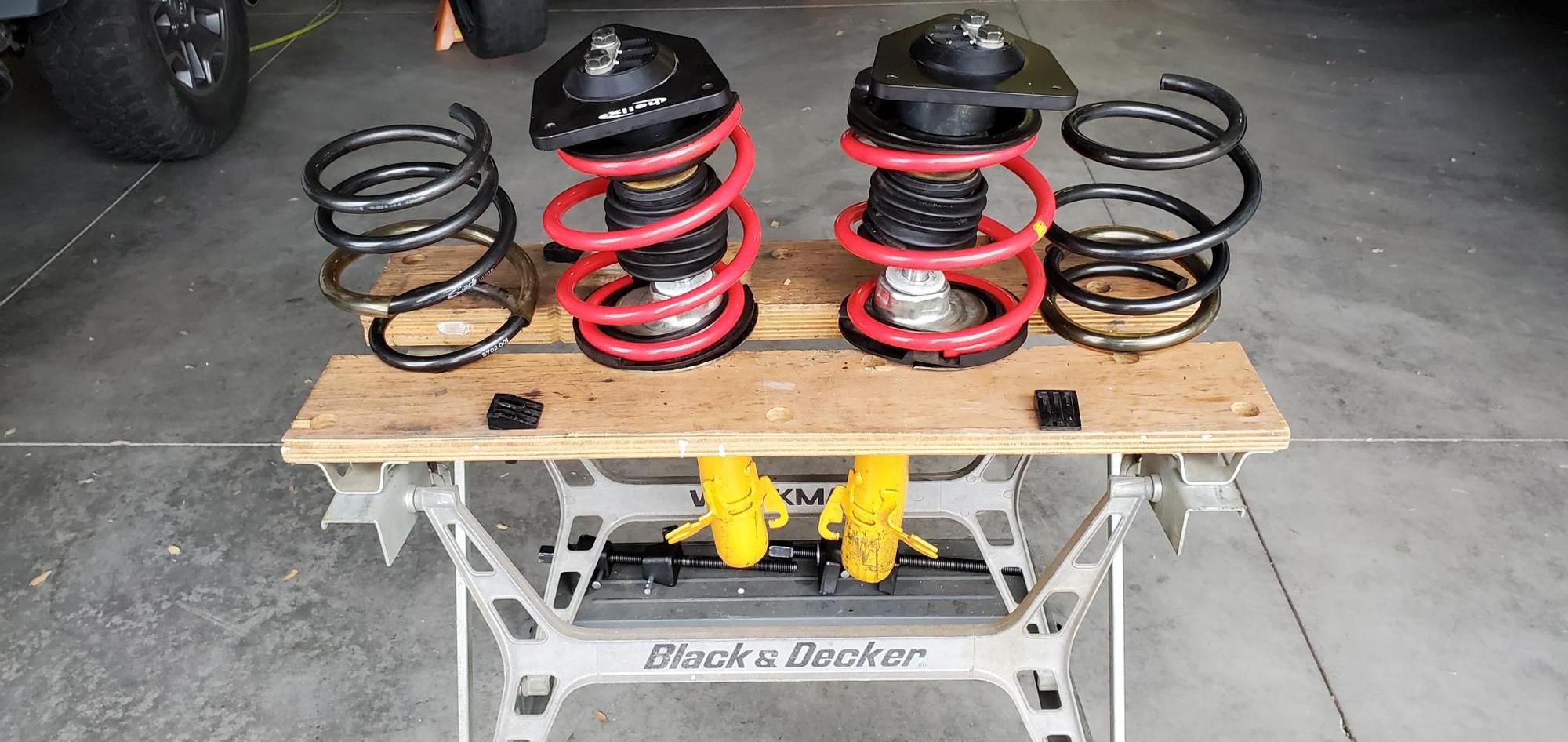

Agreed, the only way the knuckle bore will allow the strut securing bolt to pass-through both knuckle tab and strut tab is with the strut fully engaged into the slot. I used combo of wedge to spread the knuckle slot slightly, a shot of penetrating spray and floor jack with wood block to slowly raise the lower control arm with knuckle onto the strut while rotating the steering lightly to help alignment. Sorry, didn't take pics of that but these show front struts assembled and then installed. I followed up by wiping any chemical residue off the rotors to prevent being transferred onto pad surfaces.
- ^^^ That's gorgeous!

^^^ Thanks! Total of 5175 miles since new as of today!
