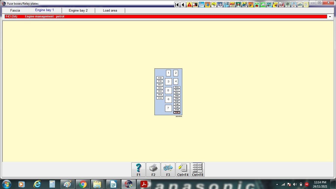

Can you try to check for fault codes?
Must check 3 fuse.Fuse F15 -20A located fuse holder behind left footwell trim,F1-5A, located left side engine comp.,FL3 -40A, left side engine comp.
F1 fuse
F15 fuse
FL3 fuse

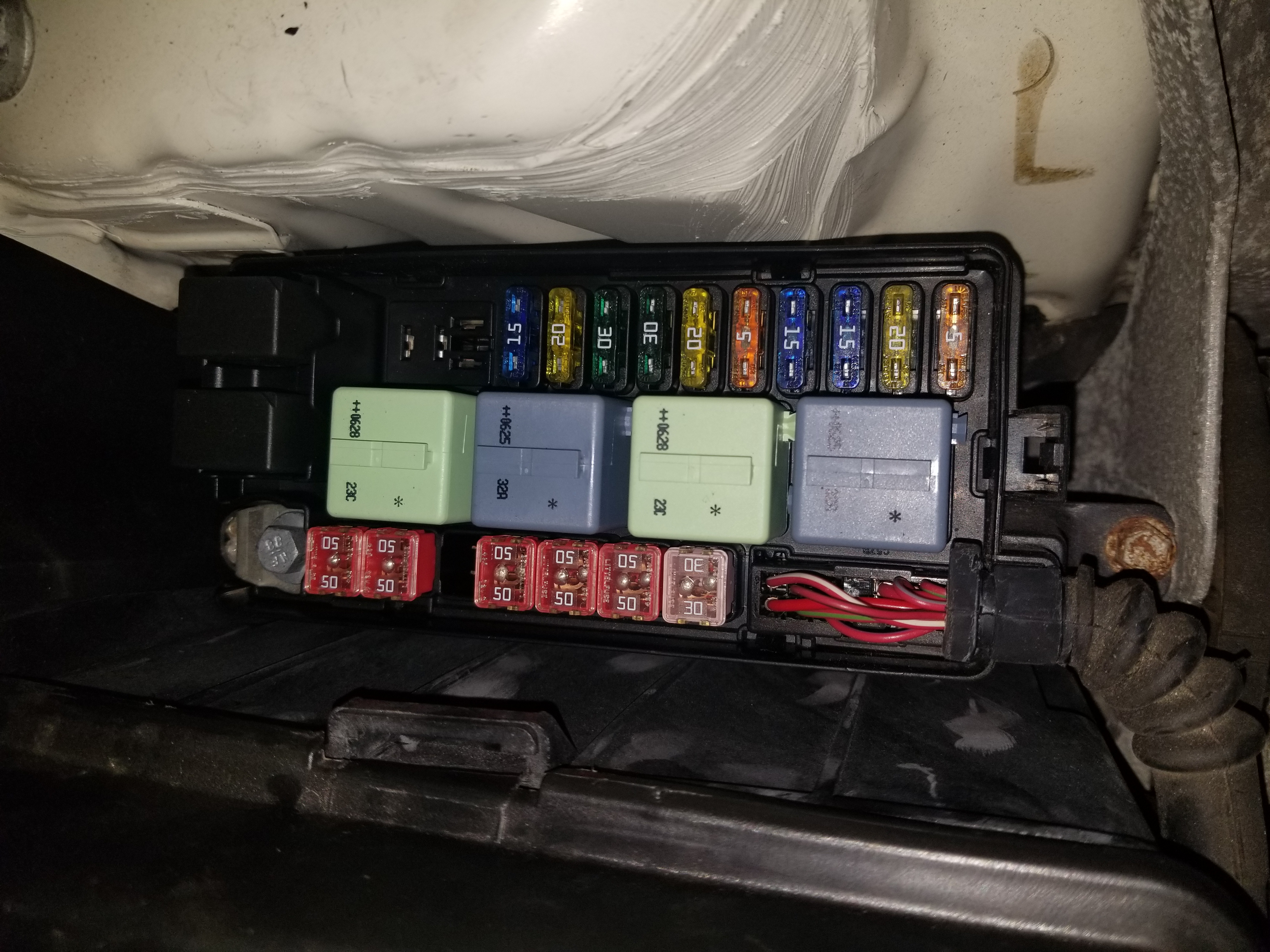

Thank you for the response. So I checked F15-20A, and F1-5A. Both are good. However I cannot locate FL3-40A fuse. I don't know where that fuse is. It doesn't show up in the fuse box under the hood. Is there an alternative location for that fuse? Thanks.
