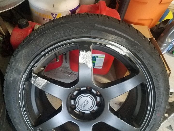

Front wheel is bent and scraped to heck

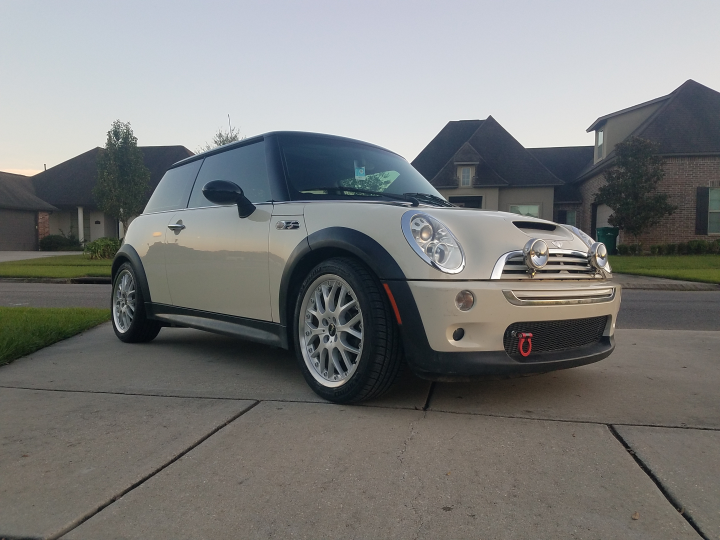

Here she is, new to her BBS 2 piece 8Y design wheels, Michelin Pilot Sport 5 All Season (Continentals I ordered were out of stock so the tire place asked if Michelin's were ok for the same price...heck ya!), stainless rally lights from Ebay UK 5" Rally Lights Ebay
