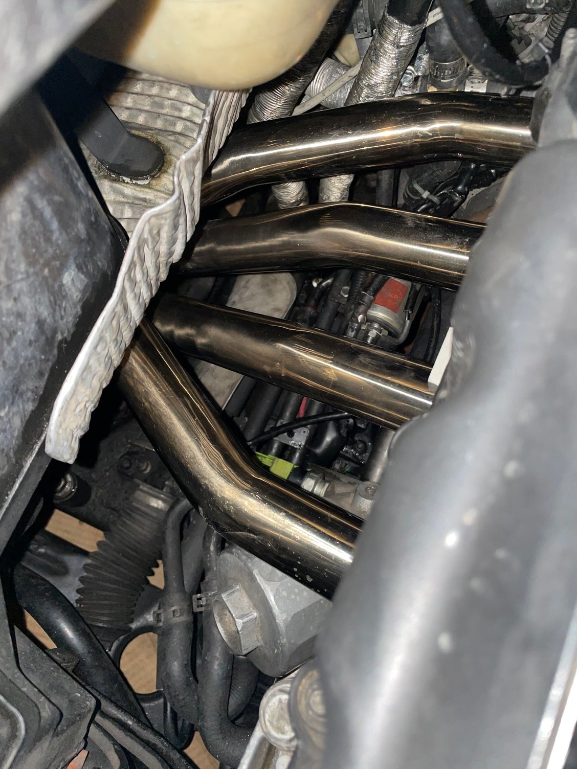

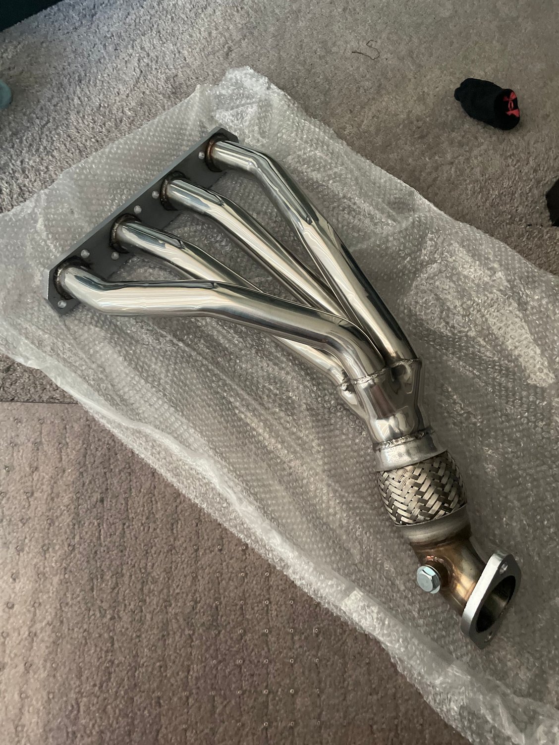

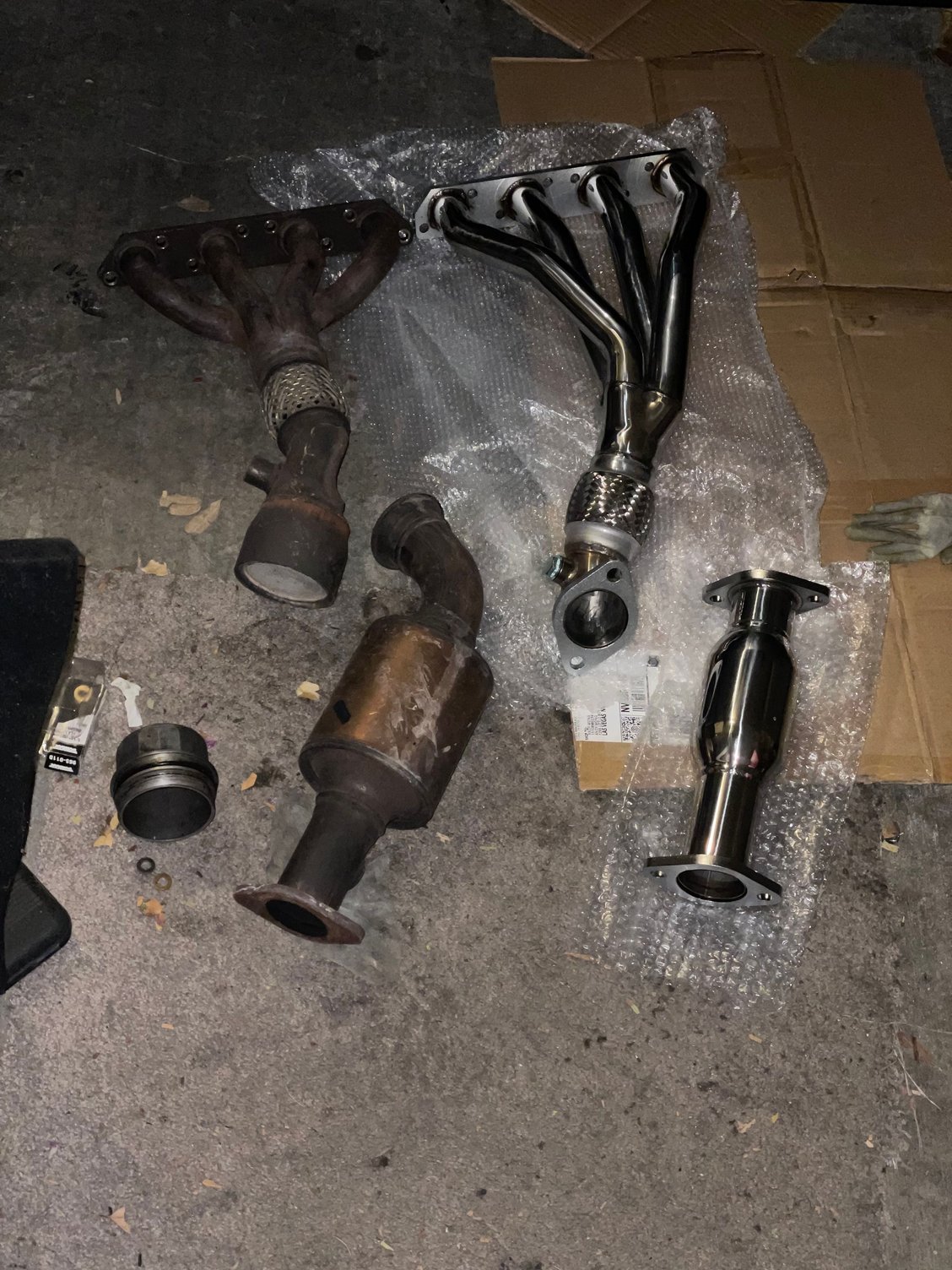

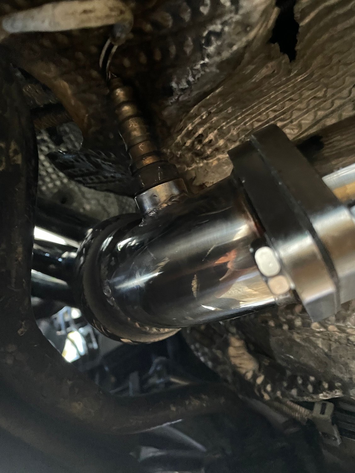

Any header is better than that cracked header , but make sure you weld a cat on it i bought mine two days ago on eBay cuz of the price and it works , only prob is you need to get defoulers for the first o2 sensor

It’s also easier to self install as well cuz it’s two pieces, 100% a work out because you have to get that perfect angle to push it in .
