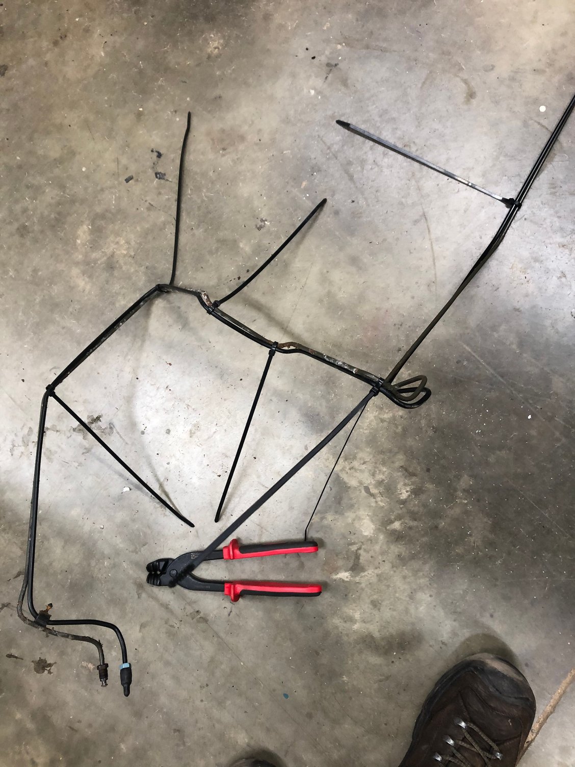

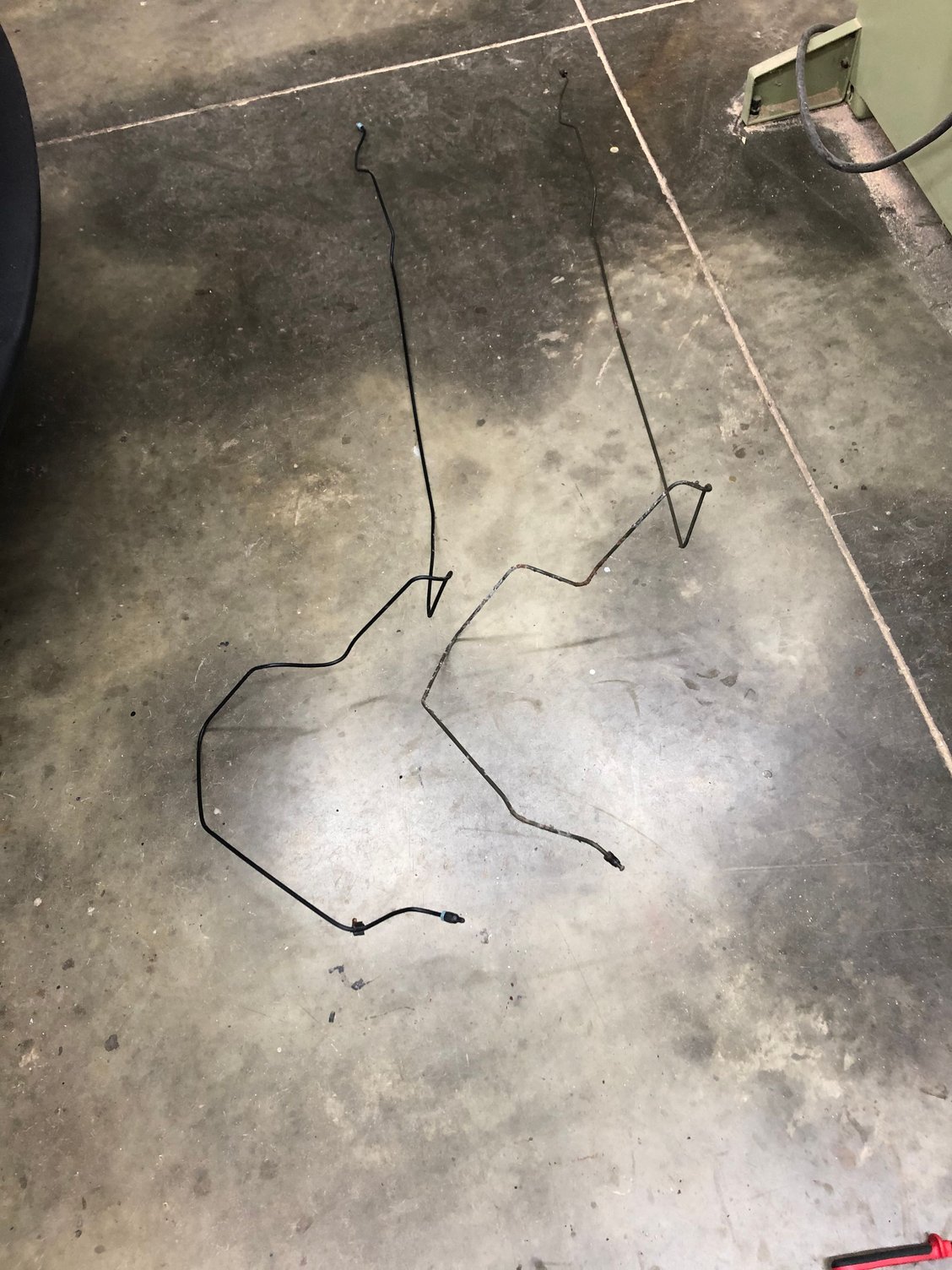

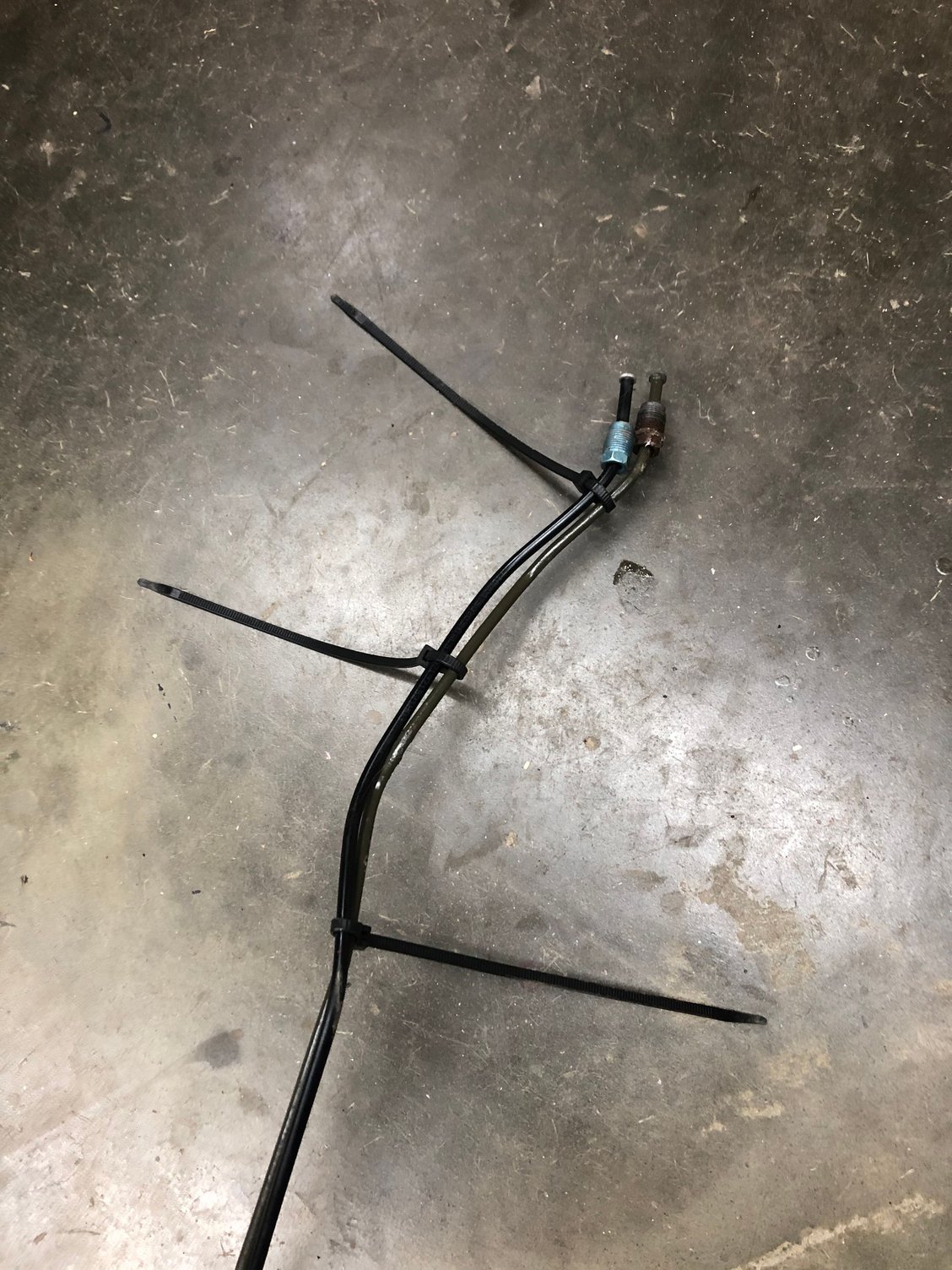

Just did a brake line replacement job on my R53, all rubber lines and rear steel. Looked for a few posts on how to do it, here’s what I did.. Removed drivers side rear line in one piece, passenger in 2 pieces. Used pre made brake lines from ECS . Zip tied on new line to original line as I was bending it, got a very good match to original. Passenger side bent up line until it went over muffler, the left the rest straight since you have to fish it around fuel lines and other components, much harder but can bend the rear of that side slowly as you fish it through,
connect the rear then work the front. Hope this helps anyone attempting this! Worked for me!-E

That looks very good!
Bending brake lines is a job I abhor.

Thats what i did when we did my one line. Used that tool also.

Great idea to use zip ties to keep the new and old together. I didn't think to do this when I changed out one of the brake lines. on my son's car Had to keep lining it up to get it right which wasn't easy since its 3D. I also used the same tool to bend.
