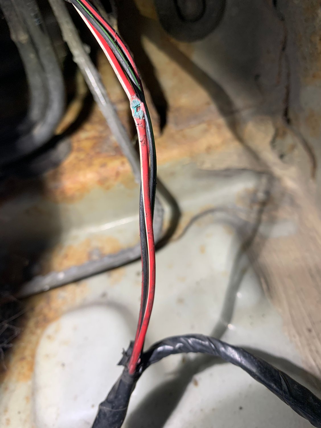

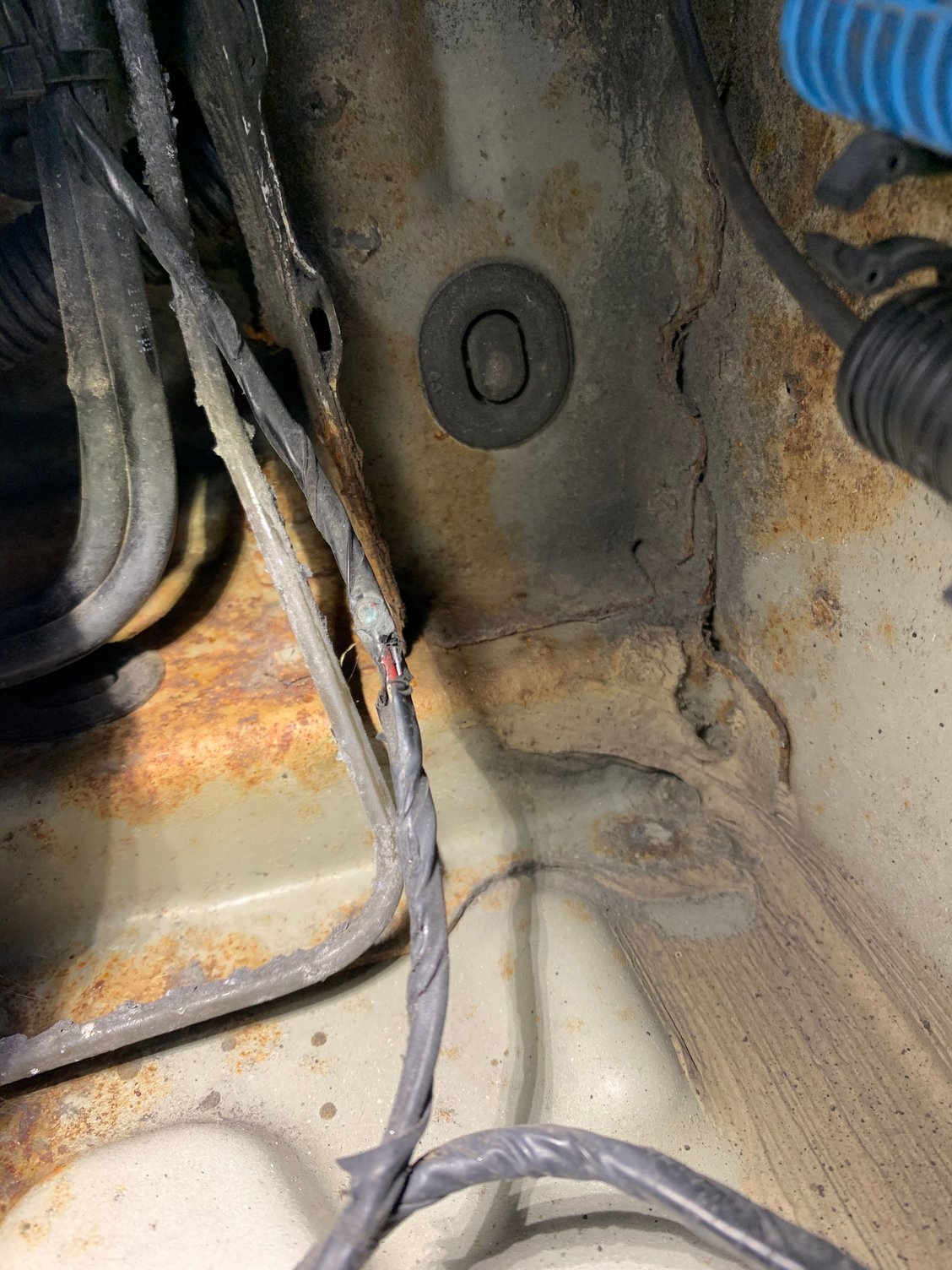

I dropped the pump/canister assembly to replace the pump and noticed a tiny wear spot on a wire (front side of canister). I stripped back the insulation and the wire was completely rotted. A 6” long section was corroded so it’s been exposed for quite a while. I cut it out, spliced in a new section with heat shrink tubing and fully wrapped the whole harness. So far no more Evap codes. Still had a O2 sensor code that I hoped was related but is still popping up even with a new sensor.
