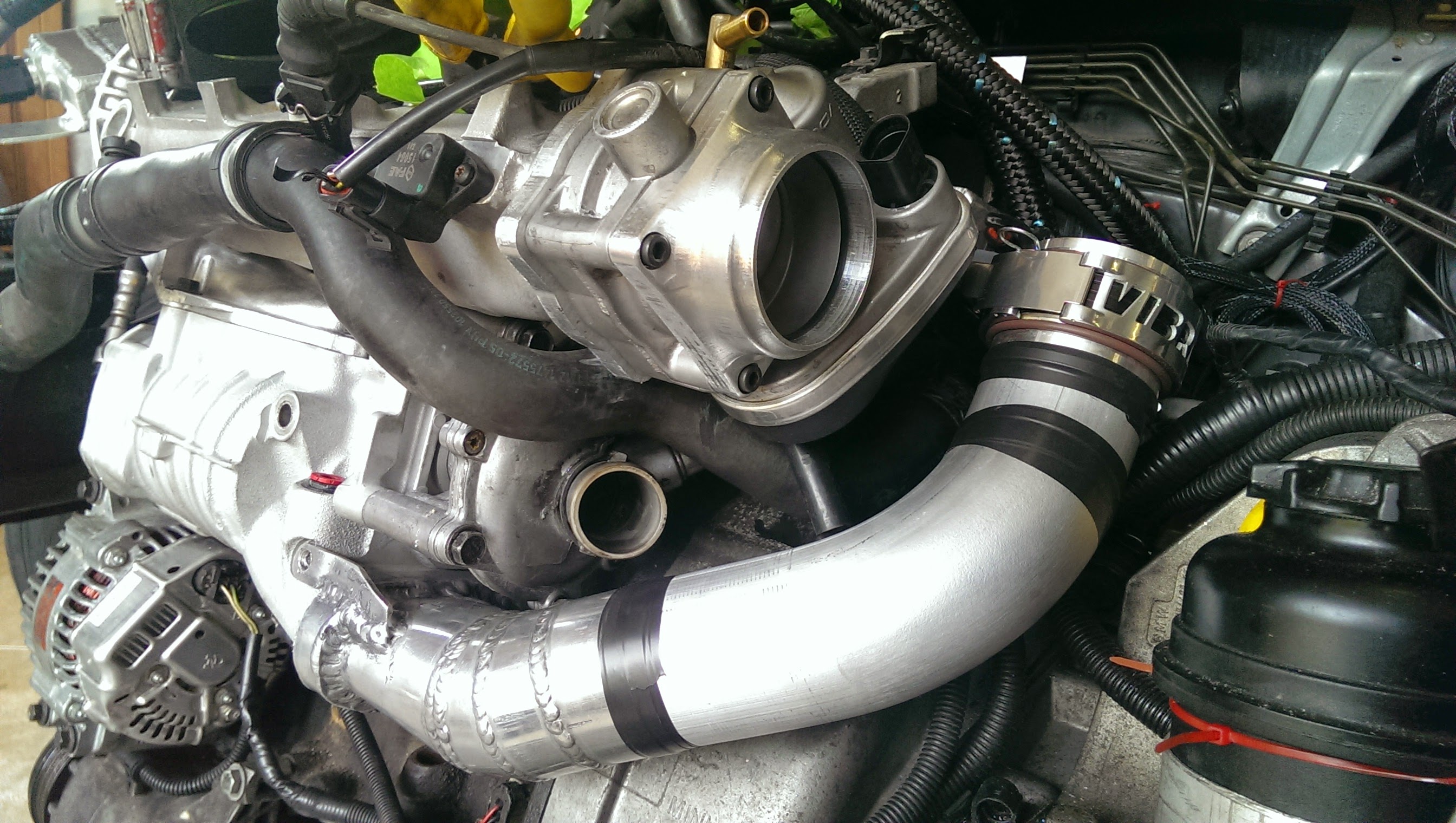

That carbon fiber tube is NOT a bad fit.
The tube has gone thru various iterations both for fit, strength, and airflow. It's also gone thru dyno and real life street tests.
While the gains have not been huge, there are gains in his design. One is going thru a long term, street test now. While I don't know exactly were he is in the testing, I also know that it was more of a design task, to see if big gains could be had.
He also had a full set of larger tubes up to the air filter that he was going to build. I'm not sure if he ever finished them.
I can contact him to see if he will ever have them made for sale.

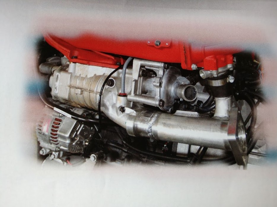

Recently scored a big stack of old MC2 magazines and was looking at issue #3 from 2006 and saw an M7 ad for something I had never seen before, did not realize that they made such a bit of kit.

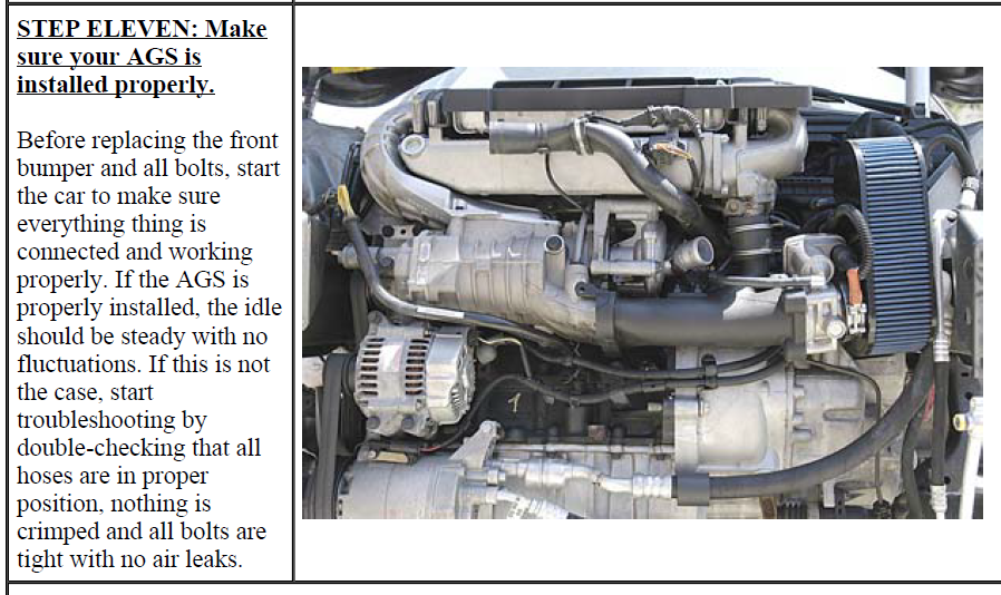

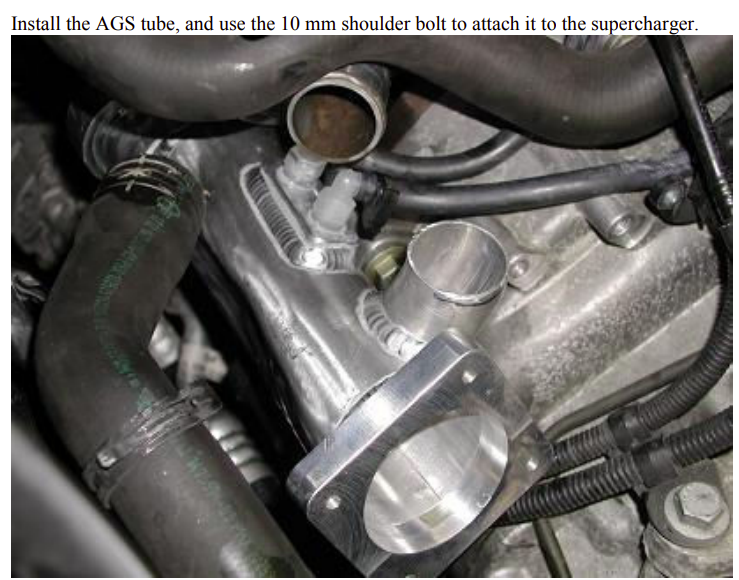

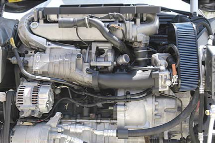

There exists on NAM a link to a pdf of fitting instructions:
There is a large thread on the topic:
https://www.northamericanmotoring.co...gs-thread.html
Looks seriously well-built:
I wonder how many they made?
My only guess is it was very expensive so not many got sold?
