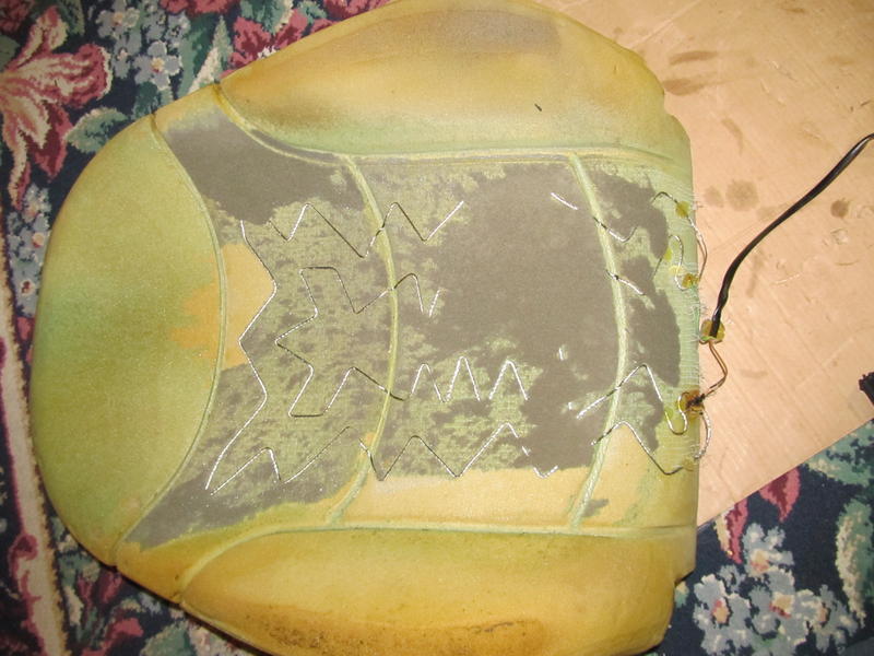

I don't think that the heater elements themselves are available, you must buy the entire cushion which is mega bucks $$$
I have no direct experience but I've investigated because I plan on installing aftermarket seats at some point and I absolutely love the bun warmers --- came from the factory on my car and they work brilliantly in my opinion so of course I'd want to transfer them but the bugbear is that they're embedded in the foam...
...as seen in these pix:
Those images were found in this thread which also offers a warning on potential problems as well:
https://www.northamericanmotoring.co...ml#post3881649
The later R56 design used more easily replaceable pads:
I have read of people using the easily-found universal style pads,
like explained here:
https://www.minitorque.com/threads/h...t-swap.208480/
Seems a good solution.
