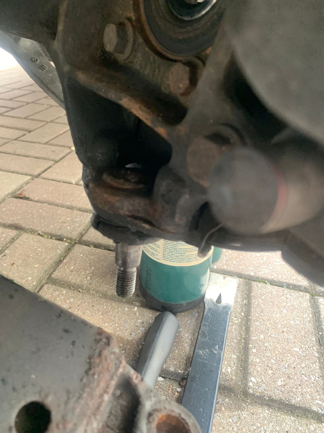

Stuck outer ball joint
Anyone have any idea how to get these out. I soaked them with pb for days and beat with a hammer and nothing

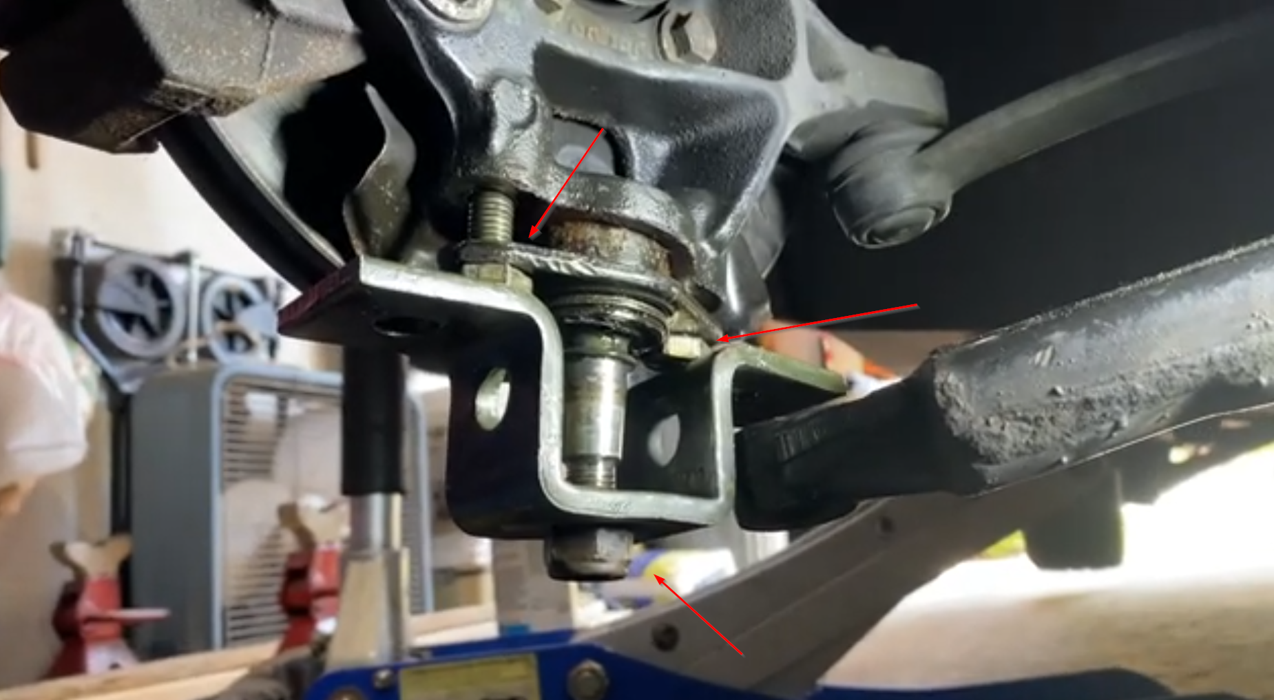

Here's one from You Tube.
