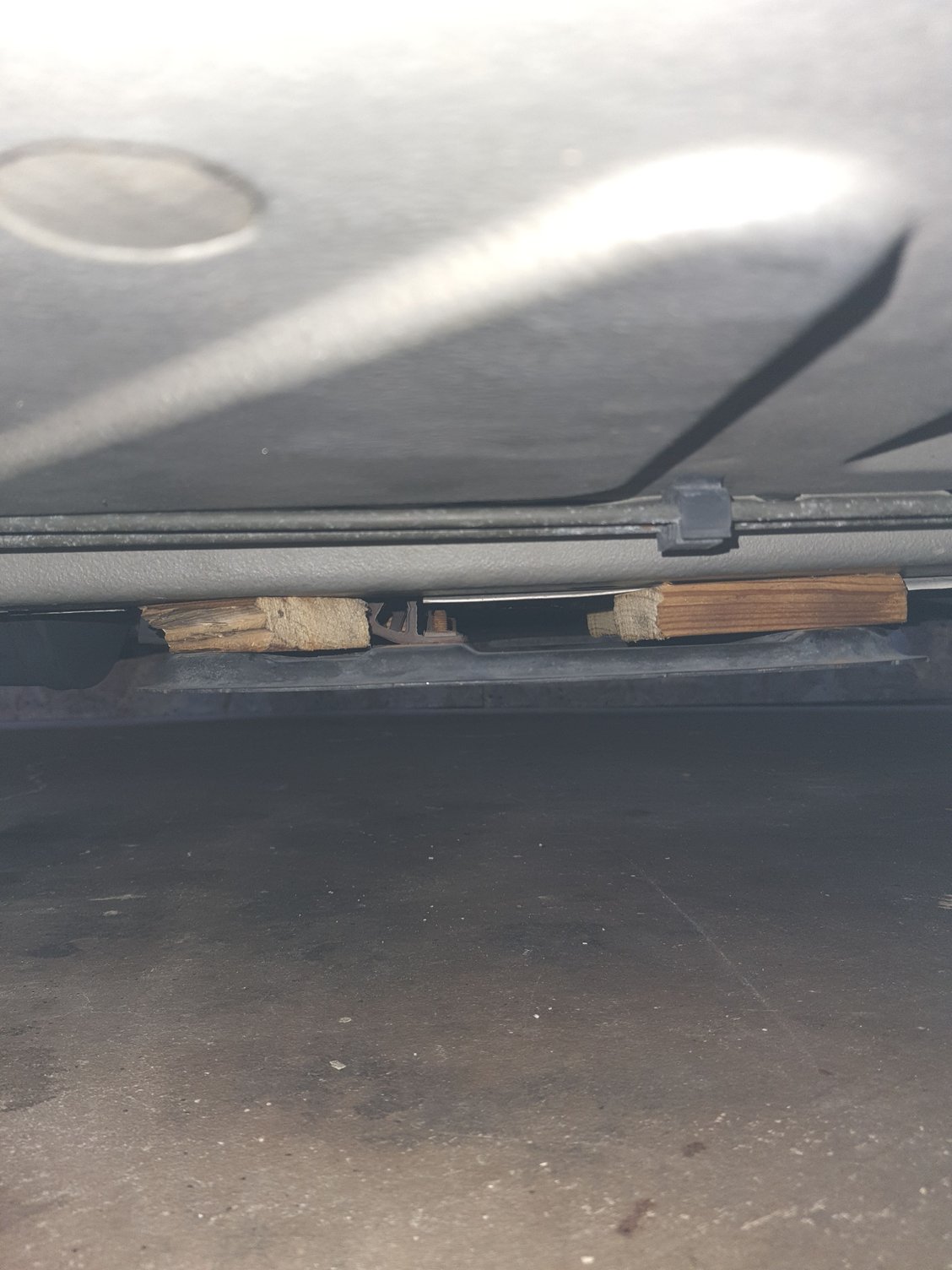

I'm not aware if it was removed or not though I think its still there beneath the heatshield.
I rigged this up and it worked enough to make it not smoke but it did still get a little warm in that area. I used the wood to pull down on the exhaust hanger that's above that plate, its just temporary as I find a better solution.
would it be ok if I remove that box and possibly then be able to put in more heat shielding or atleast give it enough area for heat to dissipate better..
how loud or bad would my exhaust sound if i just deleted that resonator there with a strait pipe?
