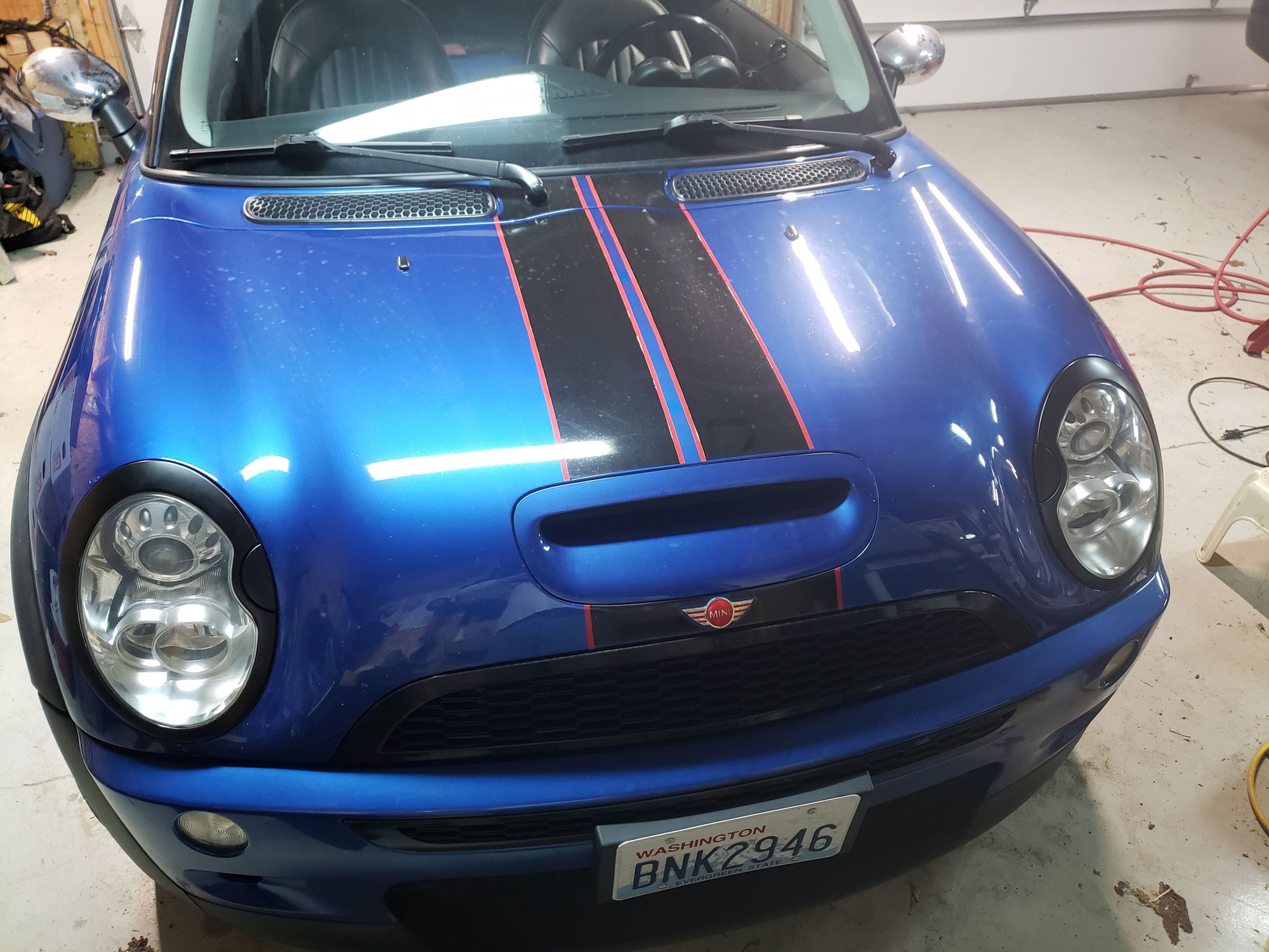

Body color headlight rings
Changed out my headlight rings for body color. I like it better than the blacked out look I had before.
Previous look
Old Nov 28, 2020 | 04:35 AM
