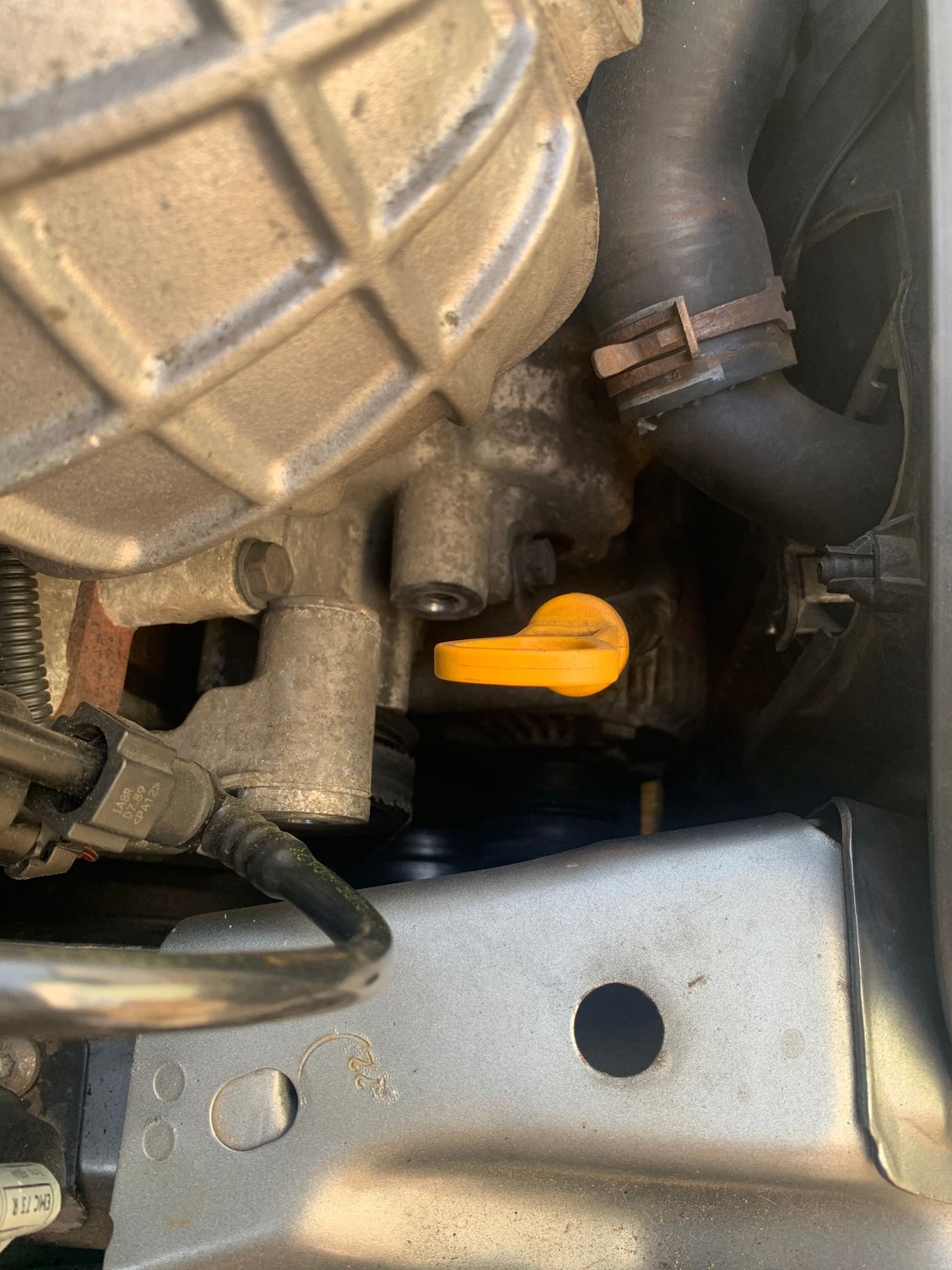

Can anyone please help and tell me what the bolt is that’s missing in the picture. And if possible where to buy one in the Uk?

Sorry as I'm no help but my 04 doesn't even have that mounting point. It maybe used for mounting of something on a different model or I would guess the a bracket to support your dip stick possibly might bolt onto there.

Ummmm, there should be a bolt going through that piece to the left of the hole in your photo. It holds the tensioner on. Should look like the photo MadMan posted. A very difficult bolt to get out unless you raise the engine.

oooooo I think you are correct . His tensioner doesn't even look like its bolted on.

IIRC, that is a long bolt that is kind of a pain to get installed/removed.
Pretty sure it is item 5 in the picture
