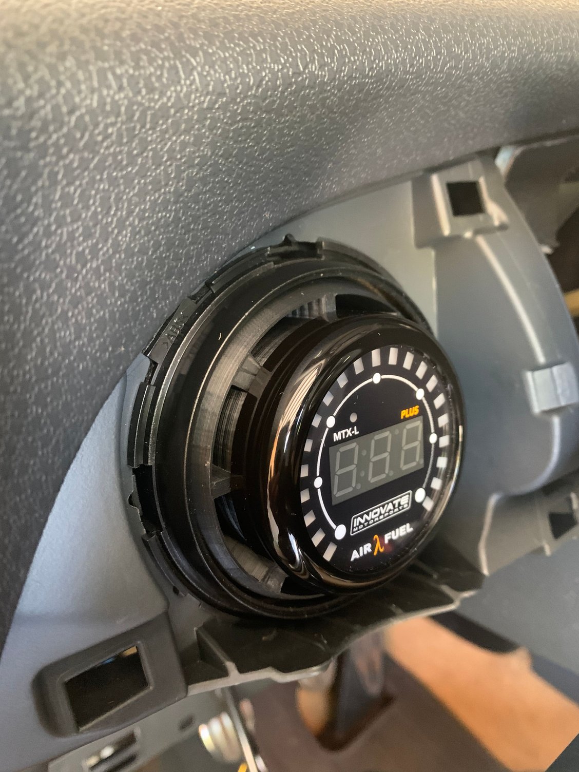

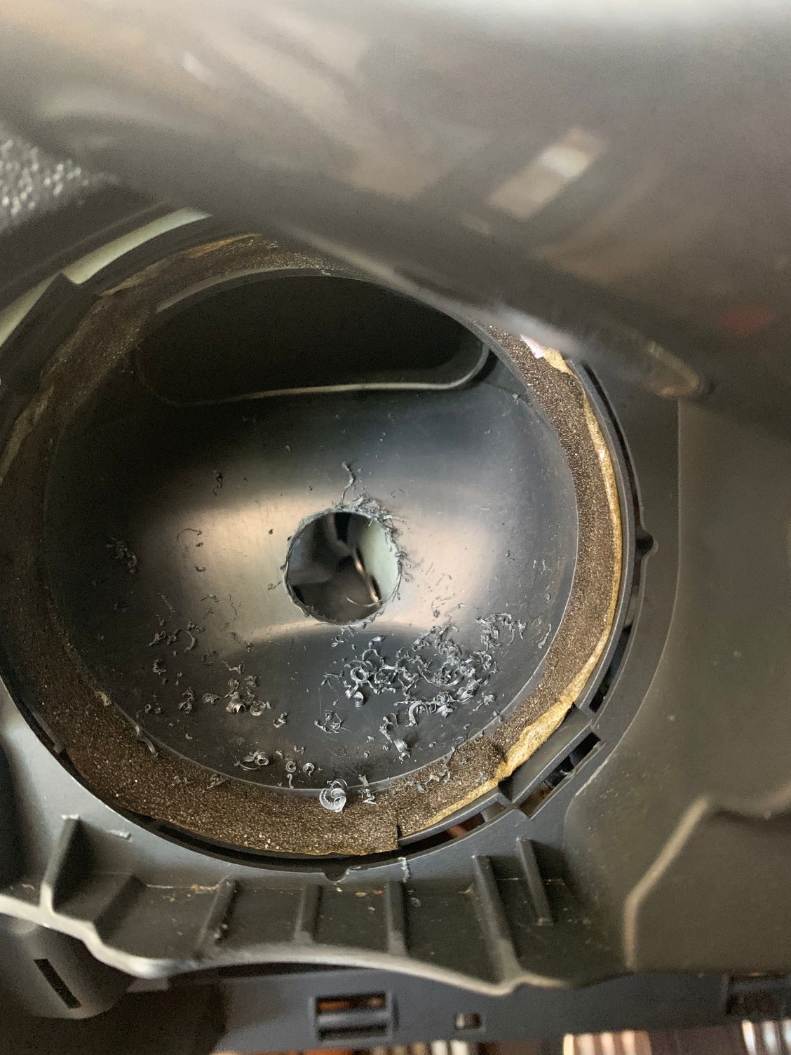

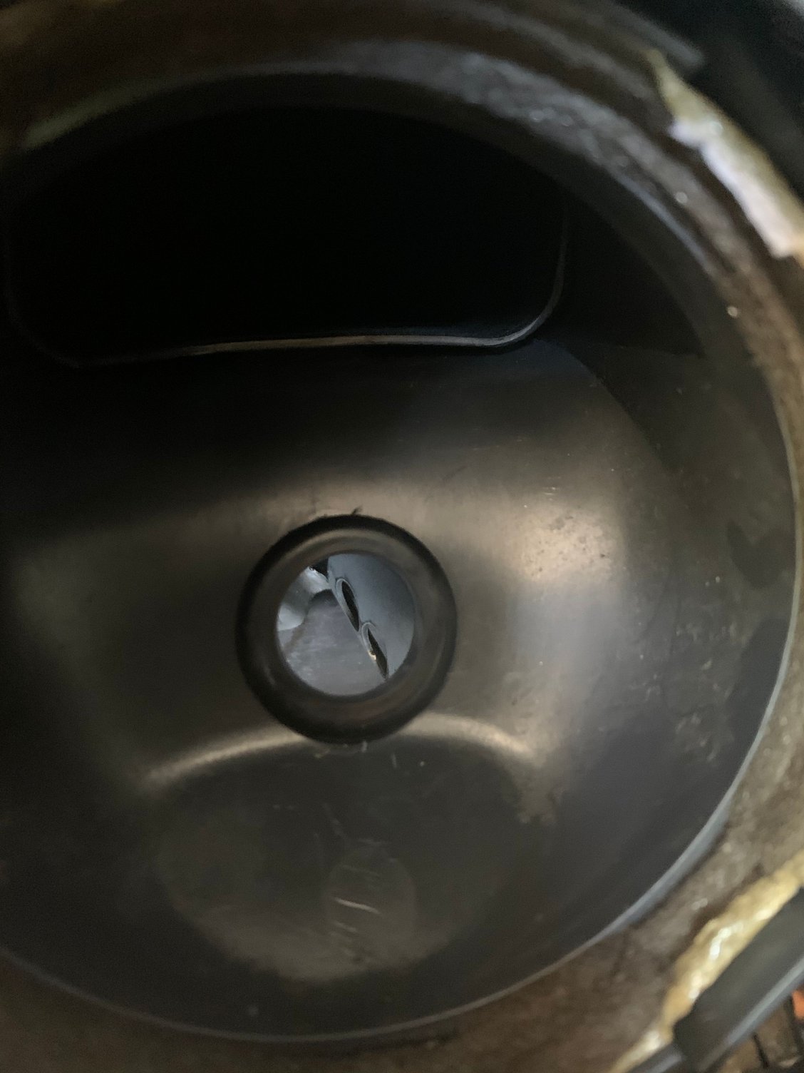

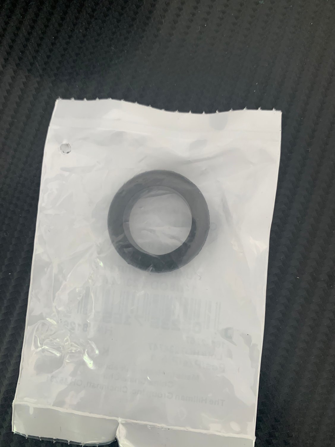

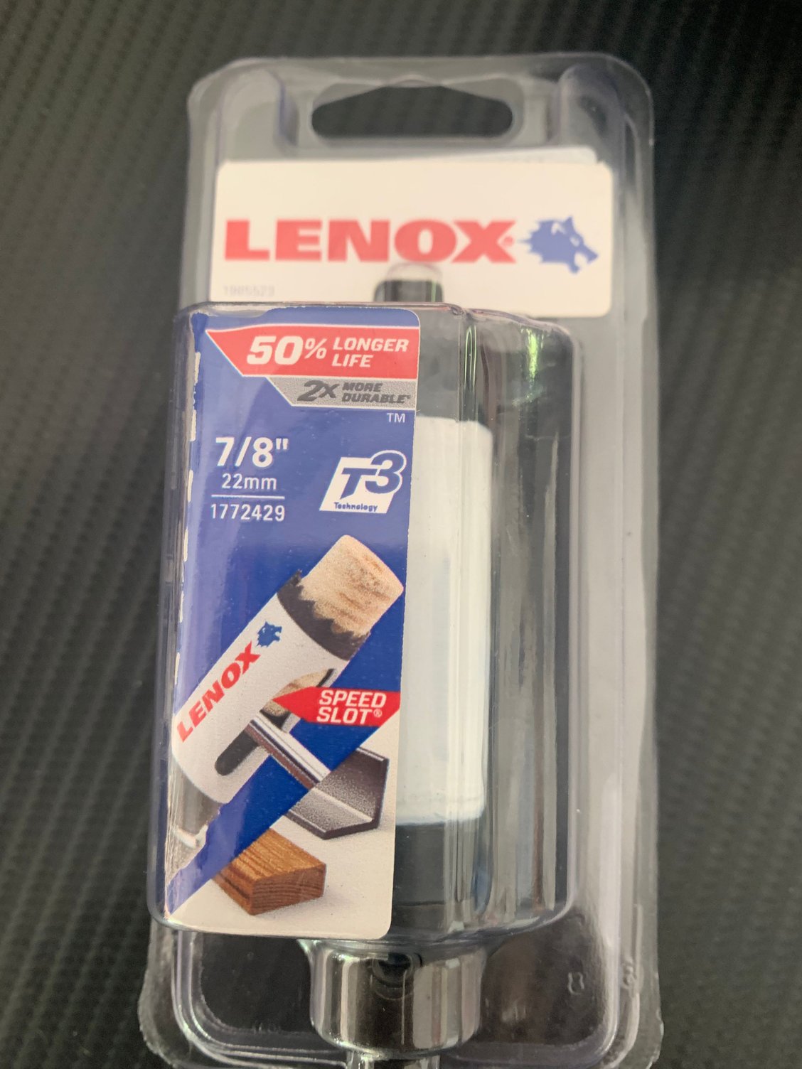

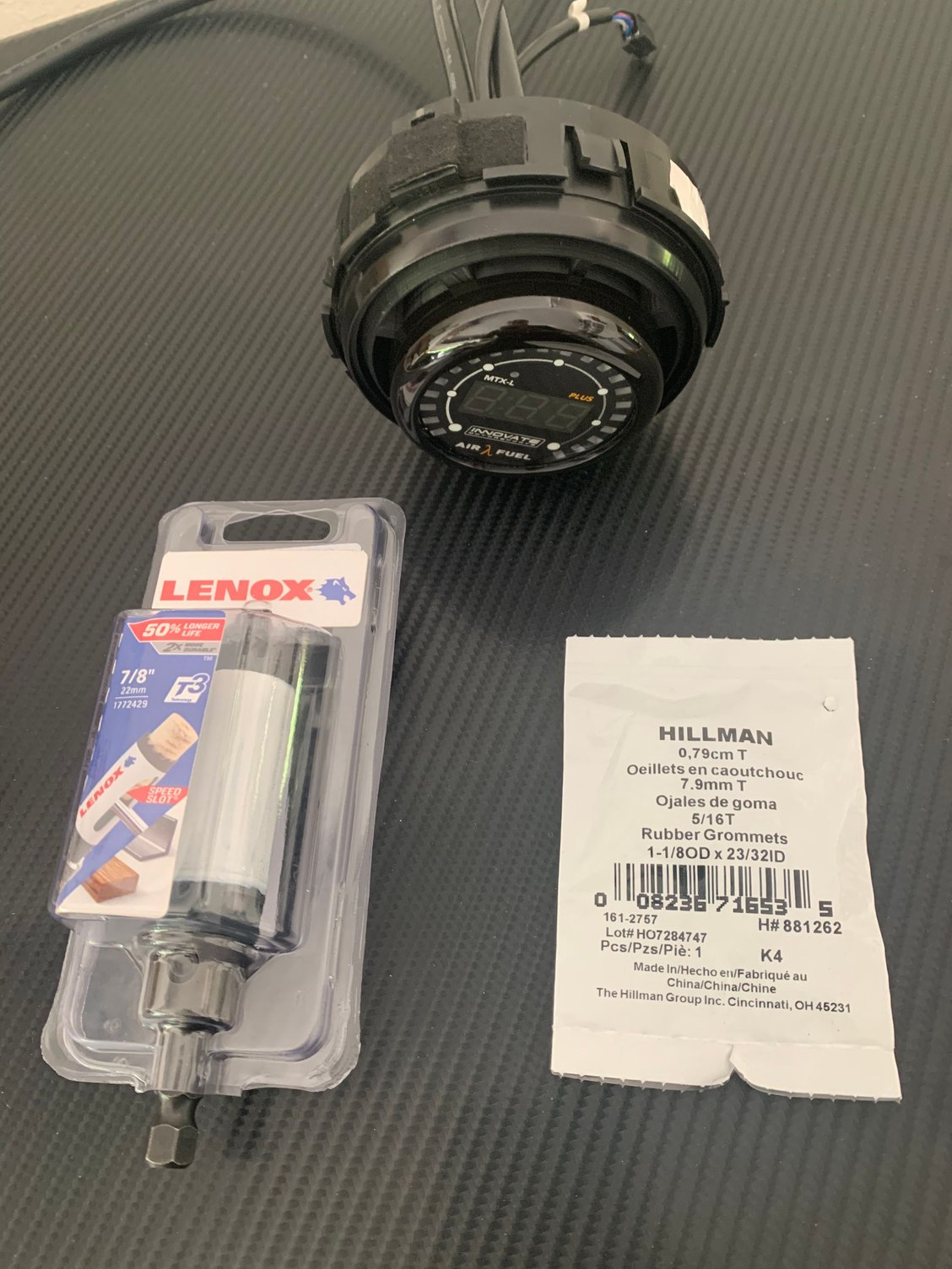

hello NAM.

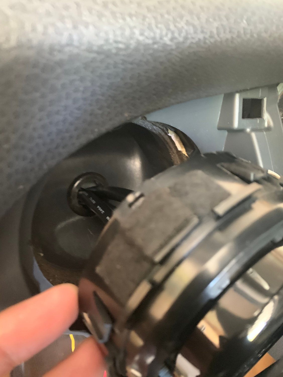

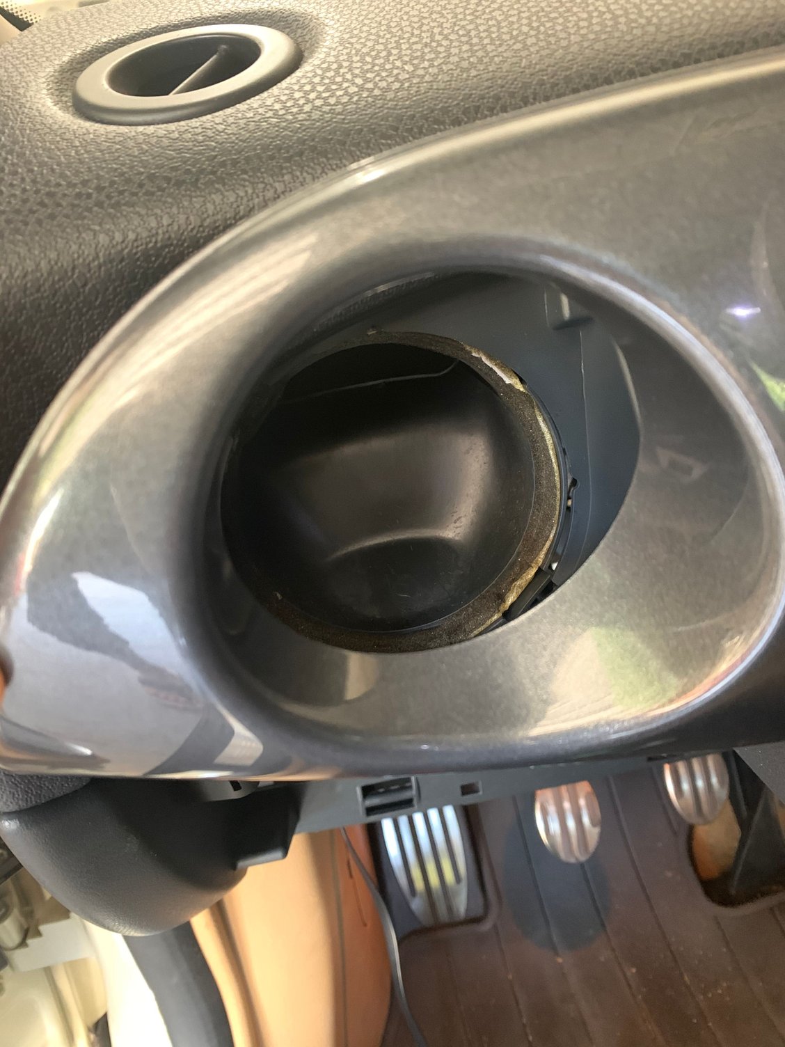

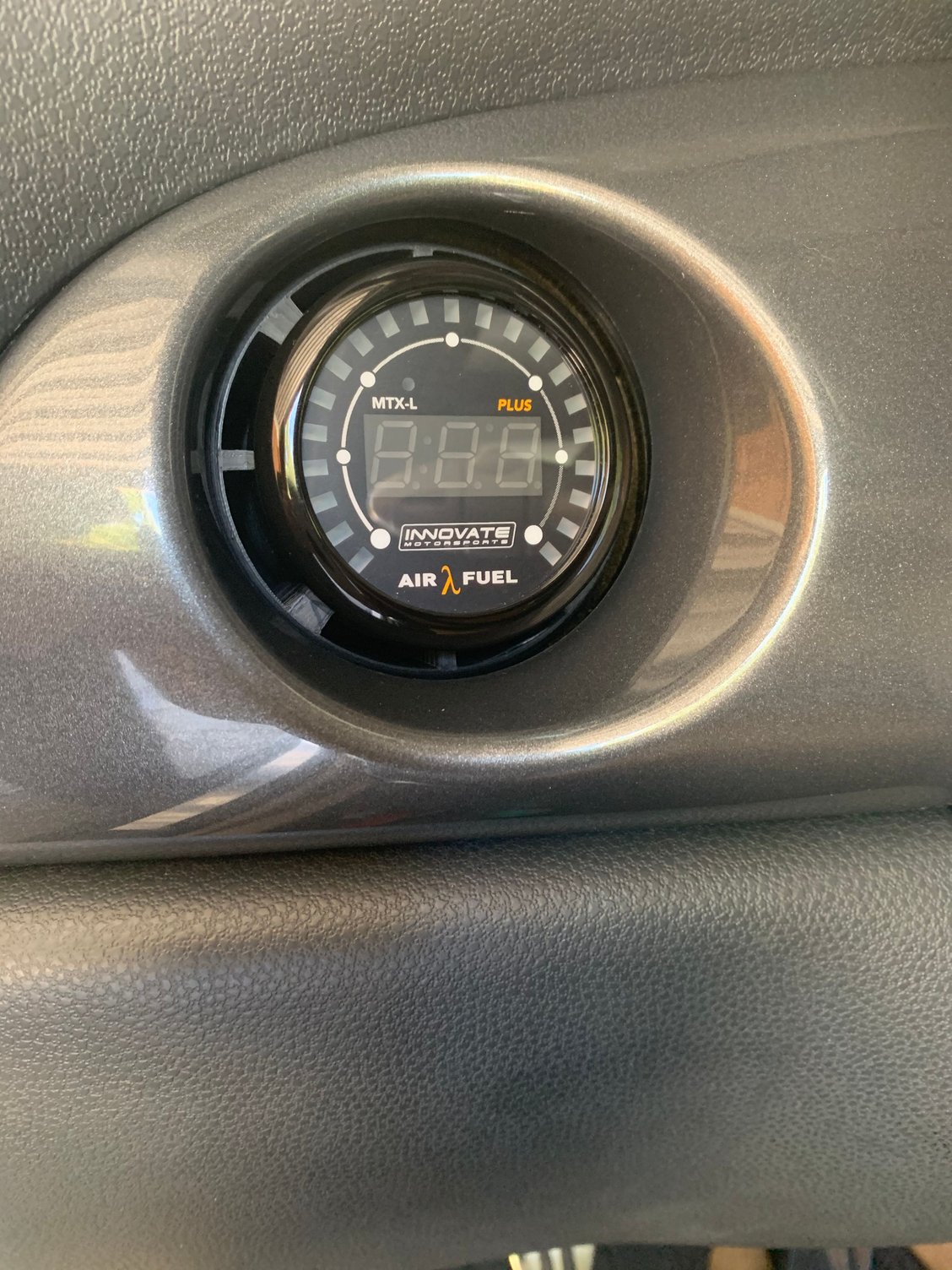

thought I’d share this experience with you guys. Since there’s plenty of threads on how to. I won’t go over that again.
removing the vents is pretty simple.
Parts i got from Lowe’s.
Hope this helps you. Now Need to find a wire diagram on where to install the white wire for dimming and the yellow ESC for logging. Any help is appreciated.
